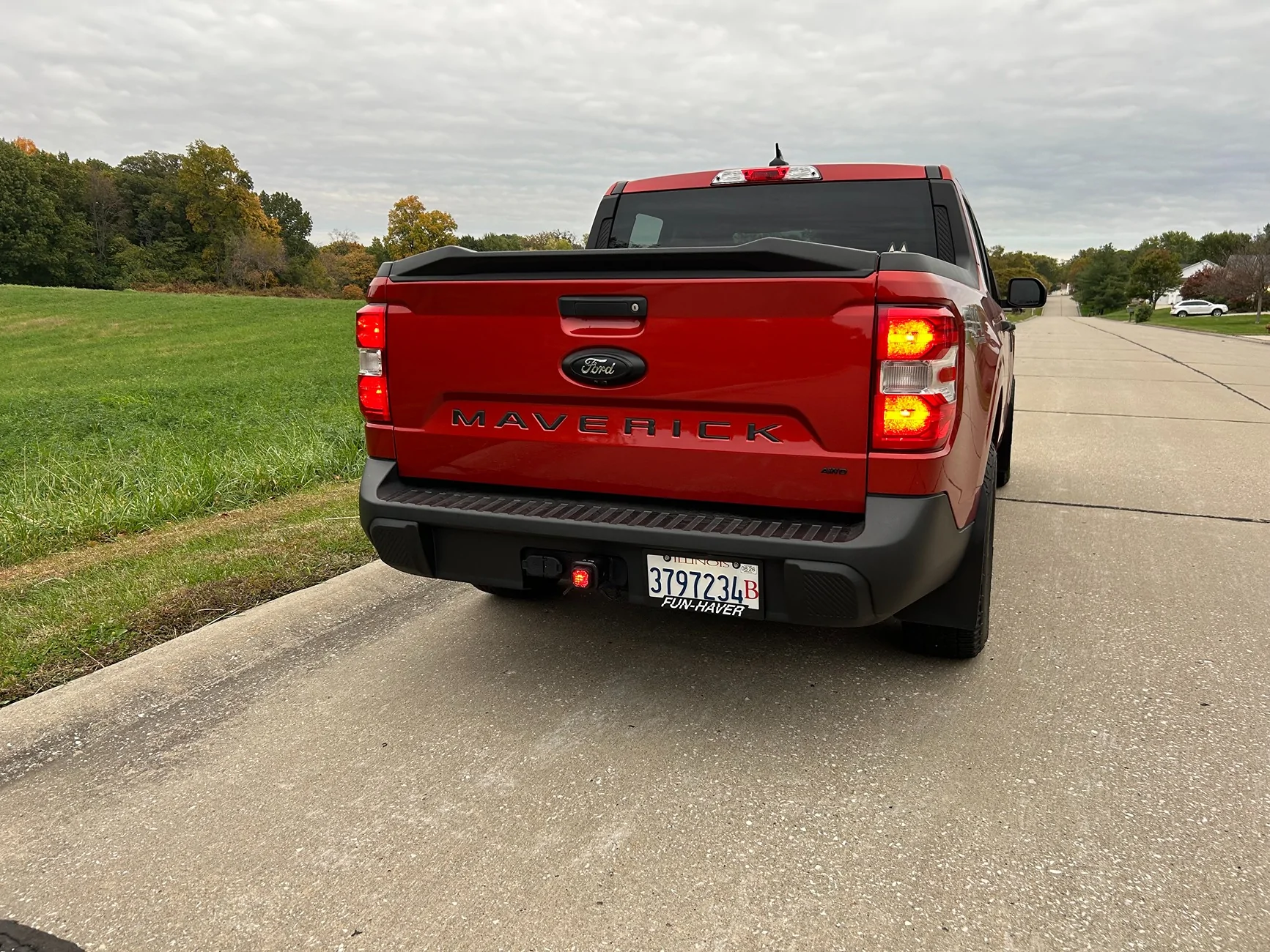

I have a hitch brake light. It plugs into a harness that connects to the driver side taillight harness. It flashes a few times when the brake is pressed.
No BLIS errors.

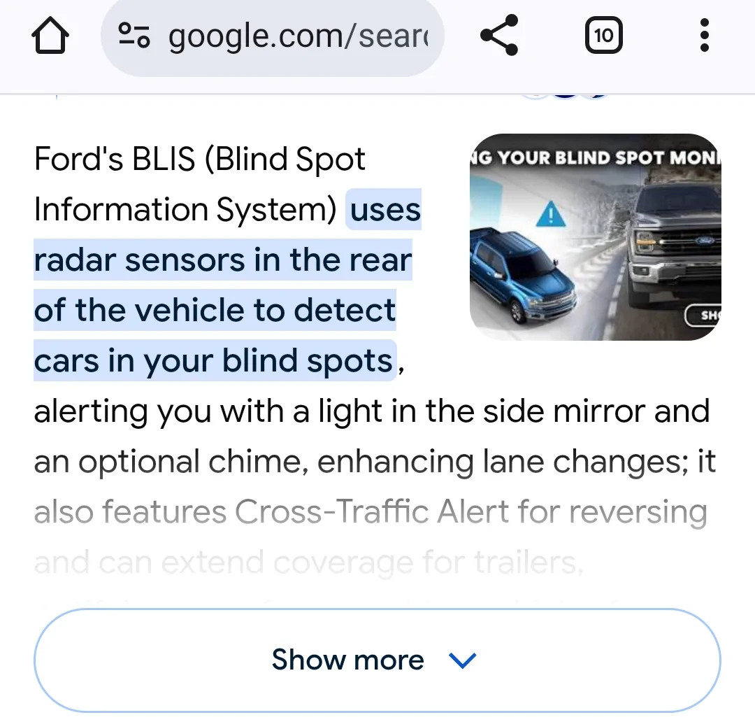

And pardon my ignorance . . . what's BLIS?

With the Curt harness the blind spot warnings on the mirrors(blis) and rear cross traffic alerts work as normal with a light bar or trailer plugged in.

The 2022 Maverick does not have front cams, so it's the side mirror warnings and rear camera cross traffic alerts that are affected when the Maverick's trailer light system is activated. As it should be, otherwise it would be alerting you all the time towing a trailer.

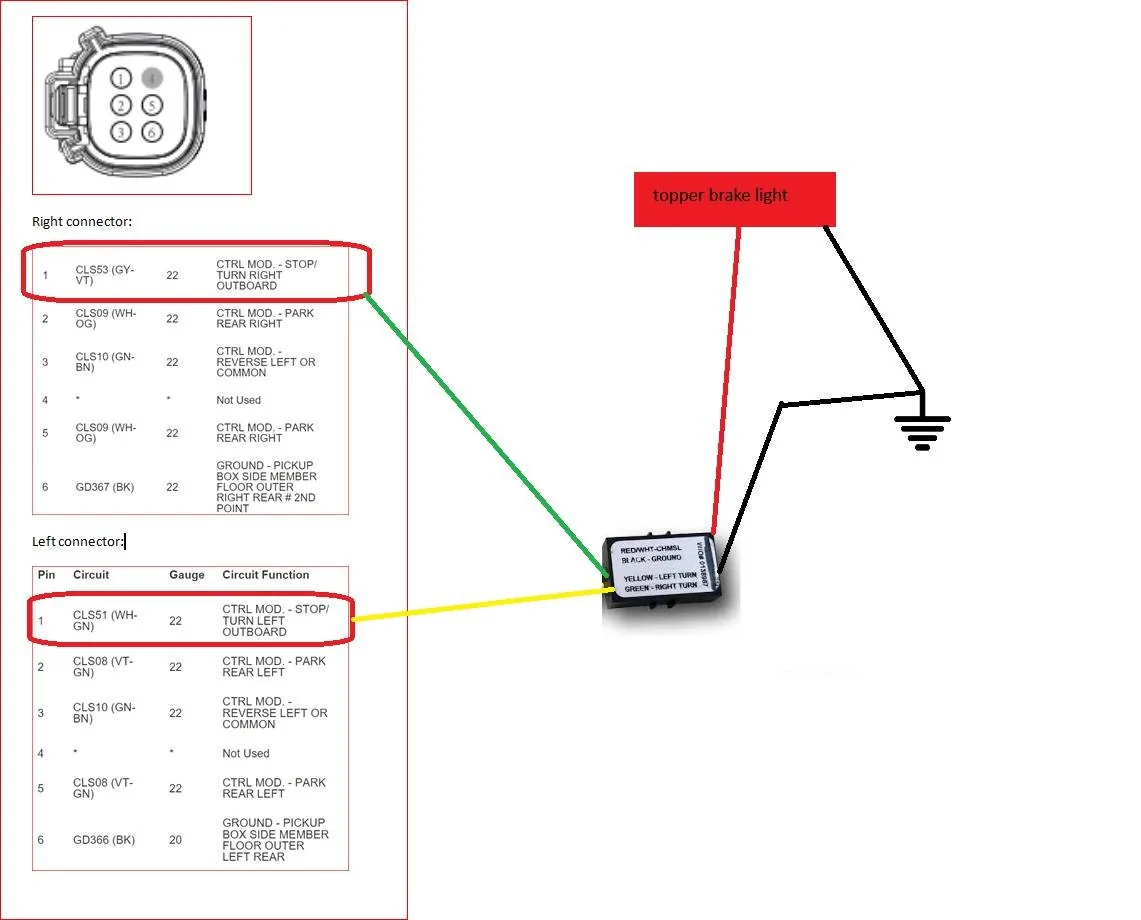

I've decided to abandon the idea of adding a trailer hitch brake light. If I use the trailer 4 pin connect, I disable rear cross traffic alert, and if I tap directly into the brake/turn signal, then the hitch light would flash no matter which way I wanted to turn. I've seen units on Amazon that are larger and have the ability to indicated directional turning, but the reviews aren't very good. I have an 3x strobe led in the cab brake light, so I can live with that.
