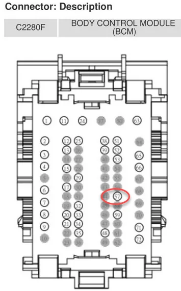

It appears that the BLIS, CTA stuff gets errors unless some kind of adapter that connects to the left and right tail lights.
Or
Tap into the 3rd brake light (CHMSL) wiring up at the light or down at the BCM.

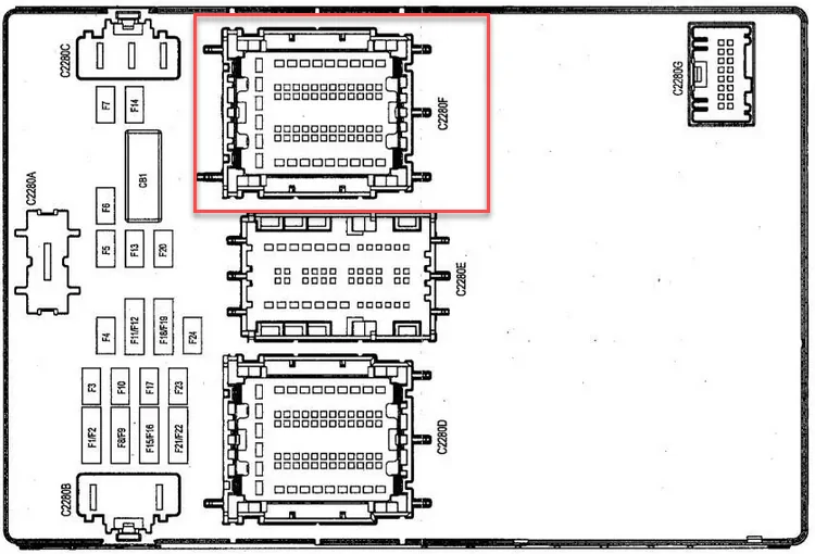

Service Manual > Wiring Diagrams > Turn Signal/Stop/Hazard Lights, C2280F Body Control Module.
Ford Maverick Trailer detected when not present & safety features deactivated (2025 Hybrid) 1759782407876-1x
BCM/Fusebox on front below passenger foot area:
Ford Maverick Trailer detected when not present & safety features deactivated (2025 Hybrid) 1759782518375-
Ford Maverick Trailer detected when not present & safety features deactivated (2025 Hybrid) 1759782618318-pn
