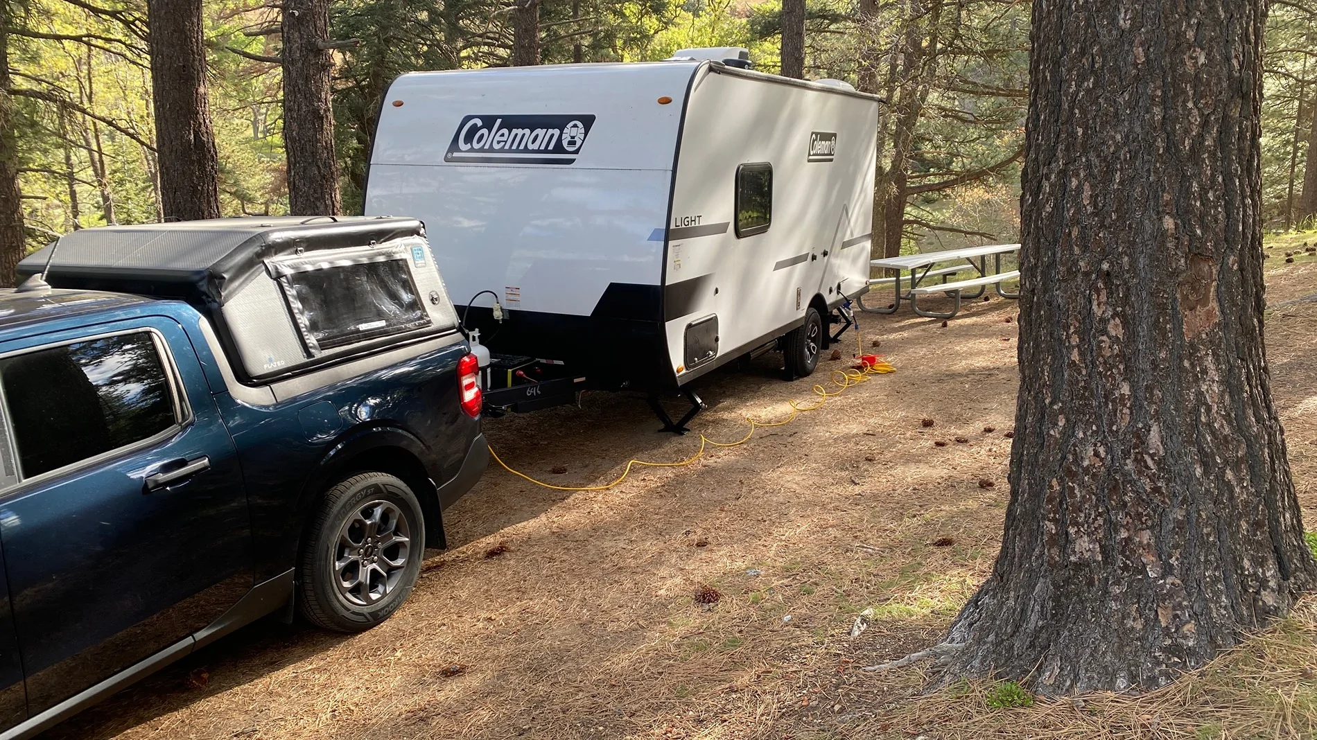

Just curious what are y’all towing with your Hybrid Mavericks since the towing limit is so low?
The LIMIT is not low. But the recommendation kind of is.
My 2022 hybrid pulls this:
Only thing I could use and don't have is the AWD that came along later.
Ford Maverick Towing with Maverick Hybrid IMG_7857
And the 120 VAC outlet in the Maverick is powering the RV except for Air Conditioner and Microwave.

The specs state to only tow a dry e
Weight of 2000lbs….what does your trailer weigh and how does your Maverick handle it?
Mavster Mechanic
Jul 29, 2025
1,786
3,115
Hybrid
As equipped. But you can add aftermarket equipment.
Trailer is 2750 dry. 3200 as outfitted.
I ADDED a 7-pin connection and trailer brake controller. ($250)
I ADDED helper air bags to the rear springs. ($110)
I ADDED transmission temperature gauge and water temperature gauge and battery gauge, 70 gauges in all, with a ScanGauge III add on. So I'm confident I'm running well within limits. ($250)
I ADDED towing mirrors. ($60)
Top safe speed is 65 MPH.
I'm more comfortable at 60 MPH.
Truck will pull it at 40 MPH up a prolonged 6% grade without overheating. Slower than an F-250, sure. But still faster than most 18-Wheelers on mountain grades which is fine with me.
16 MPG at 65 MPH.
19 MPG at 55 MPH.
I know, same MPG as the EcoBoost when towing. But this is also my Daily Commuter vehicle and I'm getting 50 MPG on my daily grind and I'm pretty sure no EcoBoost driver is.

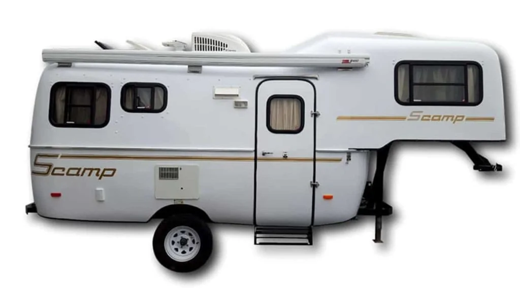

It depends on how far you're going and how fast you want to get there, but I don't think I'd want to tow faster than 55mph in a Mav just to make sure the trailer doesn't start to steer the pickup. The main consideration with a FWD is the trailer making the front end light, causing you to lose traction and control.
The towing limits stated by the mfg are to cover their a$$, they are not actual limits. I towed a 12 ton backhoe on a trailer to a jobsite with my Transit(not Connect) with 2.5 ton "capacity". I didn't go very fast, and I had zero problems doing it, and zero problems with the van afterwards.
There are a handful of small, light 5th wheels that might be the perfect thing for a Maverick.
Scamp 5th wheel starts at just 2000lbs dry weight.
Ford Maverick Towing with Maverick Hybrid 1781908233236-h

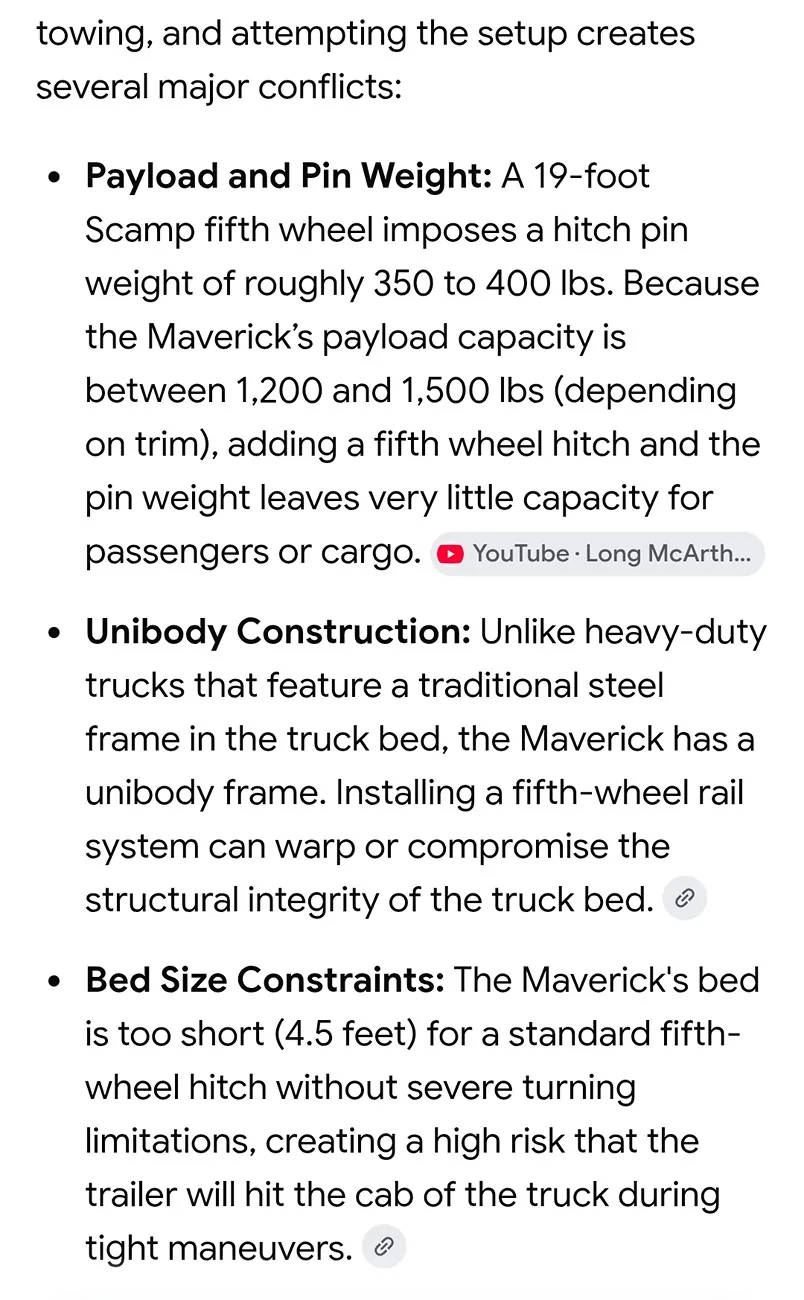

I also thought that the scamp fifth wheel was a good choice for a Maverick.
Scamp does not produce a hitch for the bed of a Maverick do the fact at the Maverick is unibody.
RIGHT! I keep forgetting about unibody specialness.
I wonder about a 1/4" steel plate that covers the entire bed, and mount the hitch to that? It would likely work, but would void any warranty and possibly insurance claims if something went wrong.
