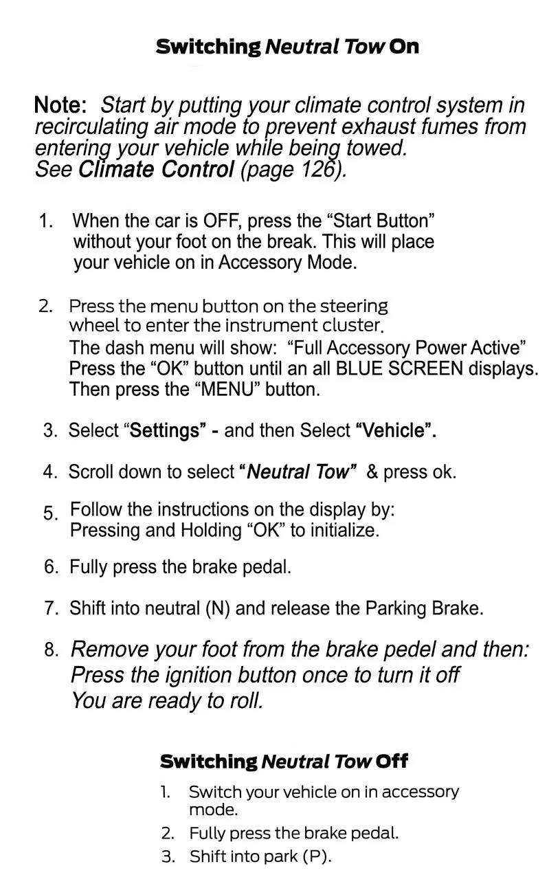

I have a 35 foot Newmar RV and I "Flat Tow". I have towed many things and all sizes.
There are really 3 things I would recommend thinking about, when you make this decision.
1. If you choose to use a trailer, you now have 3 vehicles at your campsite. That only works in very few places and always cost extra.
2. Let your RV dealer install your towing equipment. This is not something to mess with.
3. If you choose to tow your Maverick, like I do, The "Ford Owners Manual" can be tricky to understand. I am adding an attachment that you can add to your phone so you always have it with you.
Good luck, and remember to "Keep the Fun in the Fundamentals"
Did you put a brake switch bypass relay in and if so how does that affect putting the vehicle into neutral tow mode?
