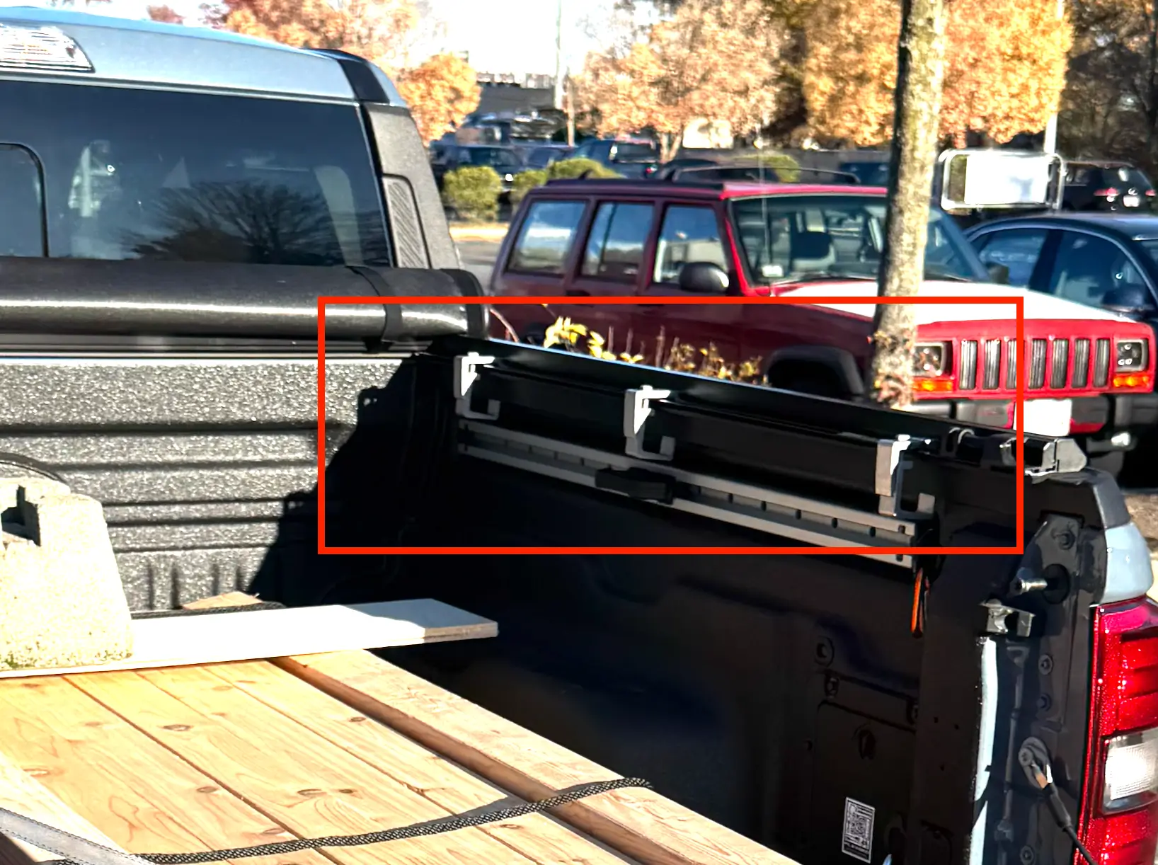

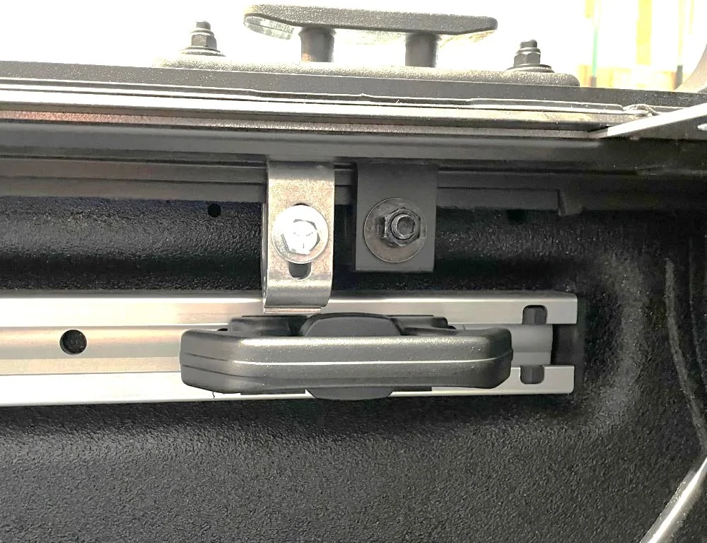

Just pay attention to the clamps that are provided, some are longer than others, and may get close to the rail hardware.
HRG
Ford Maverick Tonneau covers and Ford OEM cargo rail system. Mav clamp 2.3
Ford Maverick Tonneau covers and Ford OEM cargo rail system. Mav clamps 1

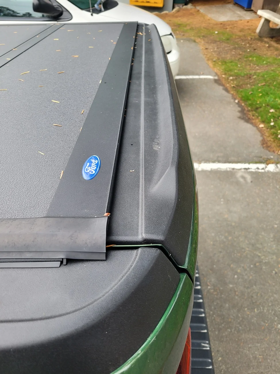

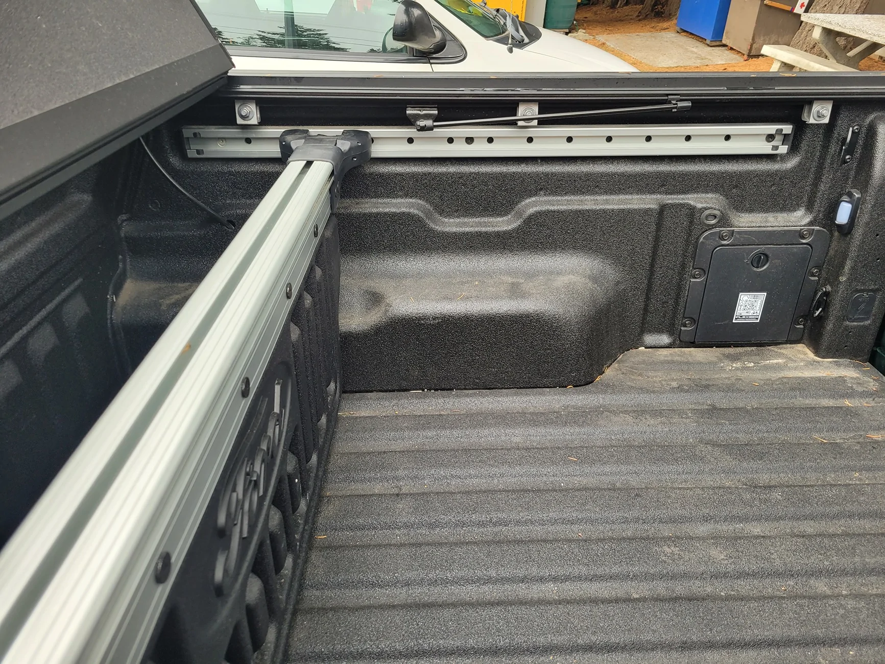

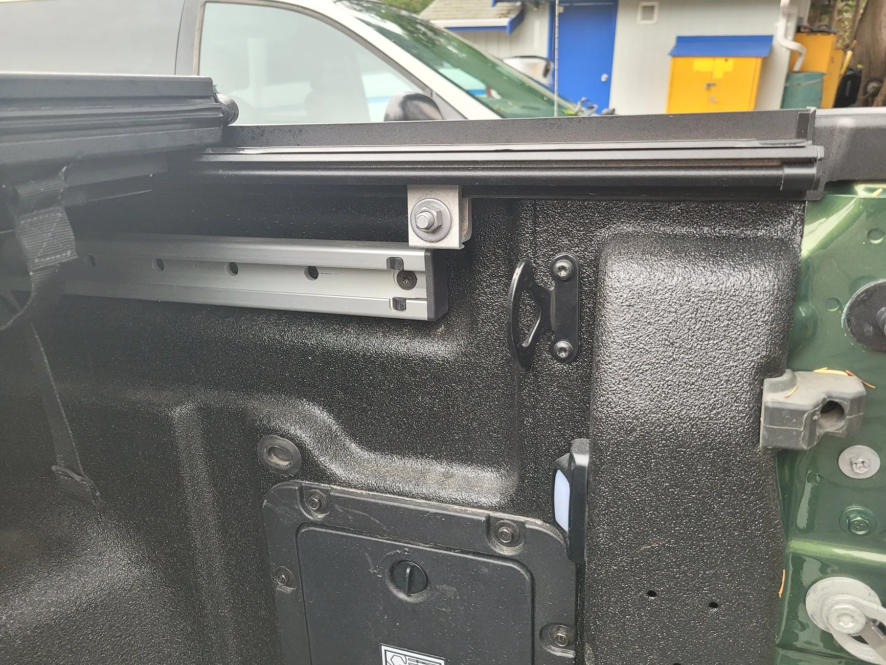

3pc folding oem ordered with oem tailgate spoiler.
Ford Maverick Tonneau covers and Ford OEM cargo rail system. 20251103_092758
Ford Maverick Tonneau covers and Ford OEM cargo rail system. 20251103_092717
Ford Maverick Tonneau covers and Ford OEM cargo rail system. 20251103_092654

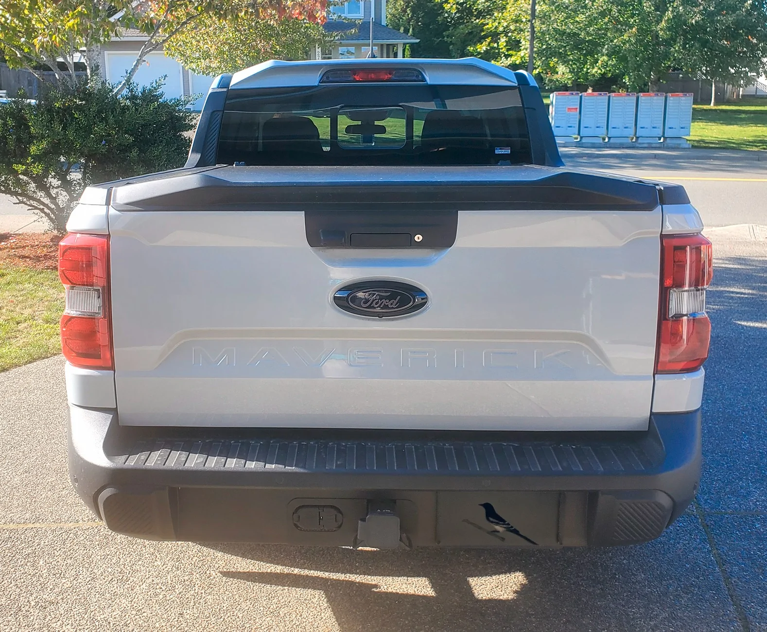

I have a 25 Lariat Hybrid with the Ford hard roll up Tonneau. They clamps do not interfer with the cargo rails. Also have the tailgate spoiler
Ford Maverick Tonneau covers and Ford OEM cargo rail system. Our Maverick_011_r
Ford Maverick Tonneau covers and Ford OEM cargo rail system. Our Maverick_009
