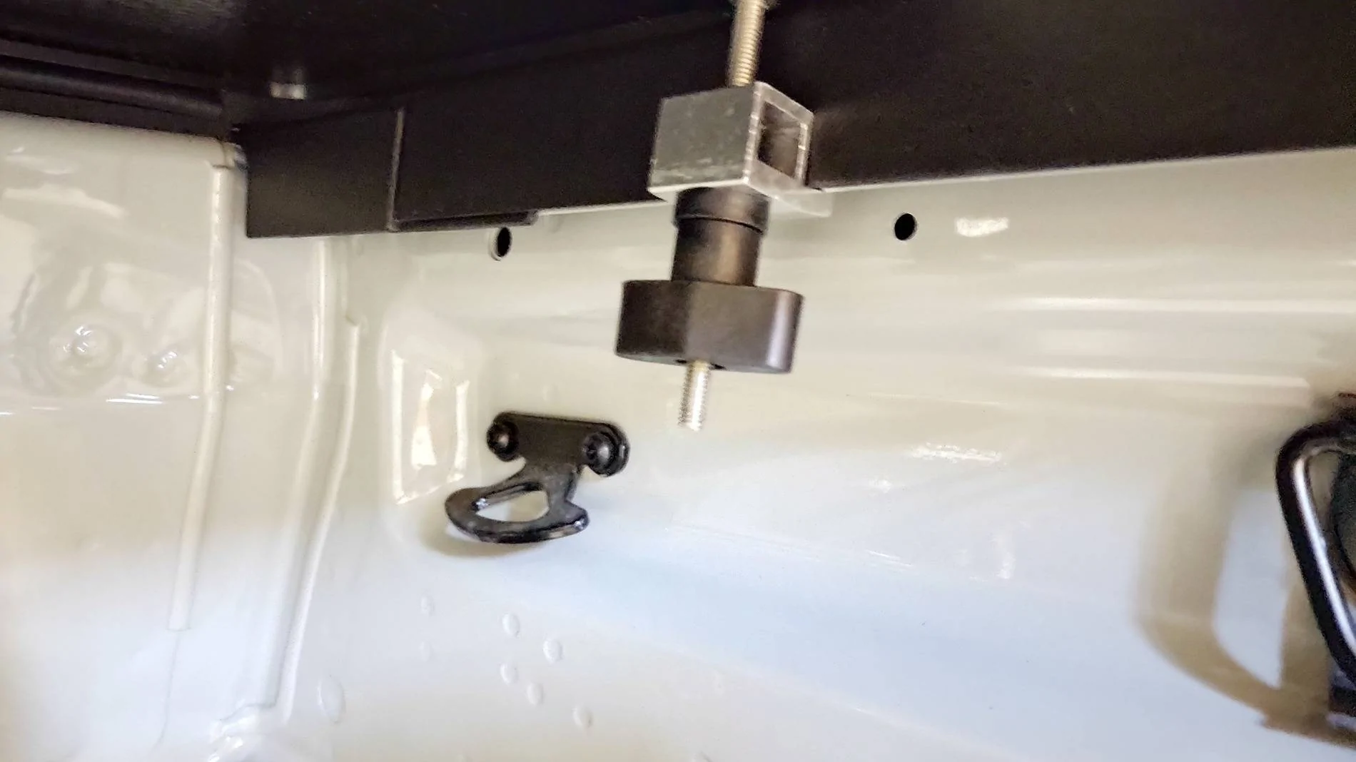

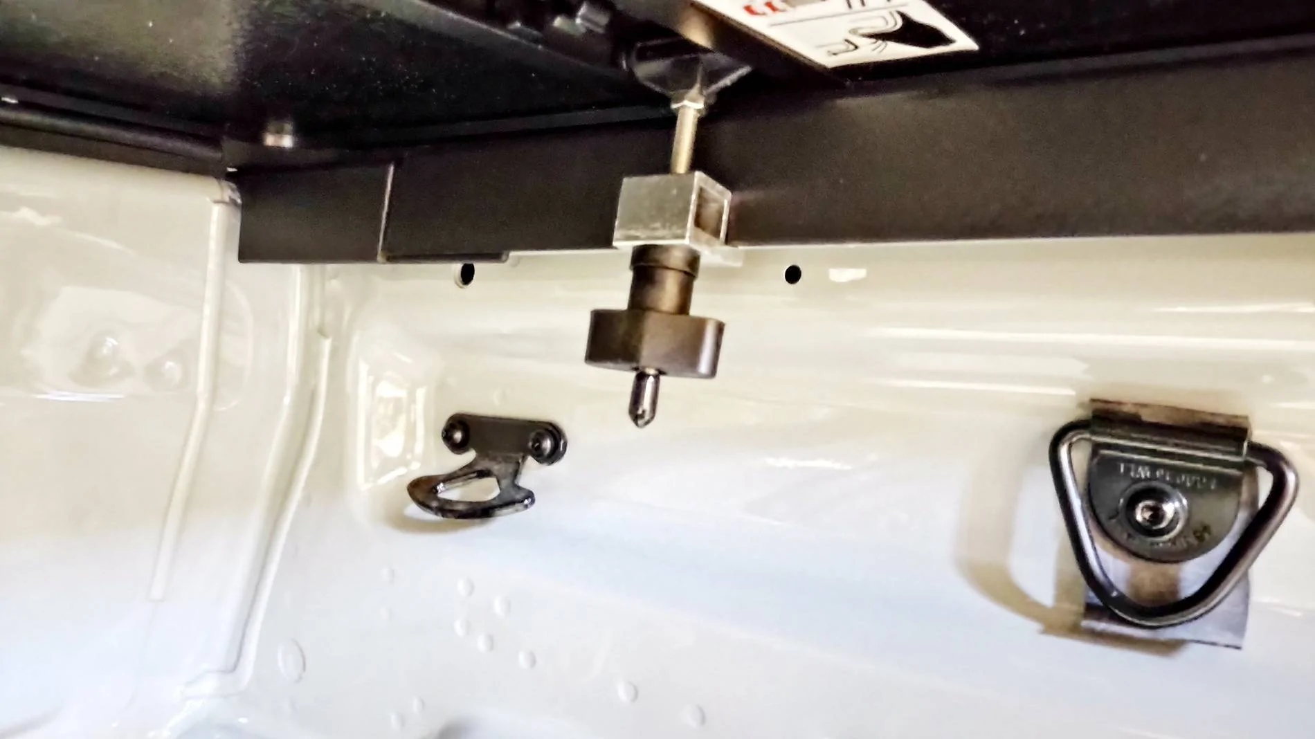

I have a hard tri-fold, but thought I'd share a suggestion that might be useful. I added a rubber thread cap to the clamp. It reduces the chance of loosening itself.

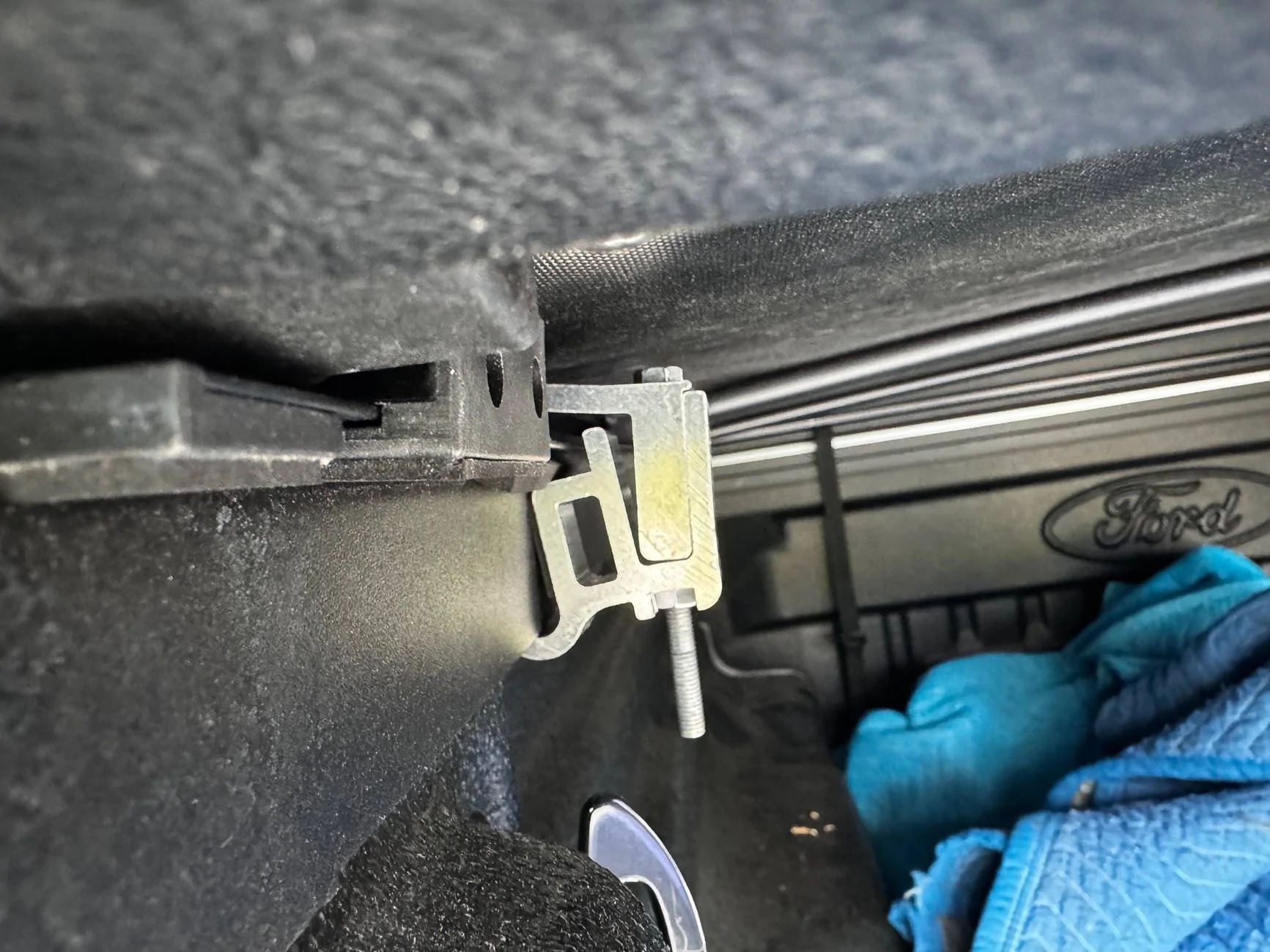

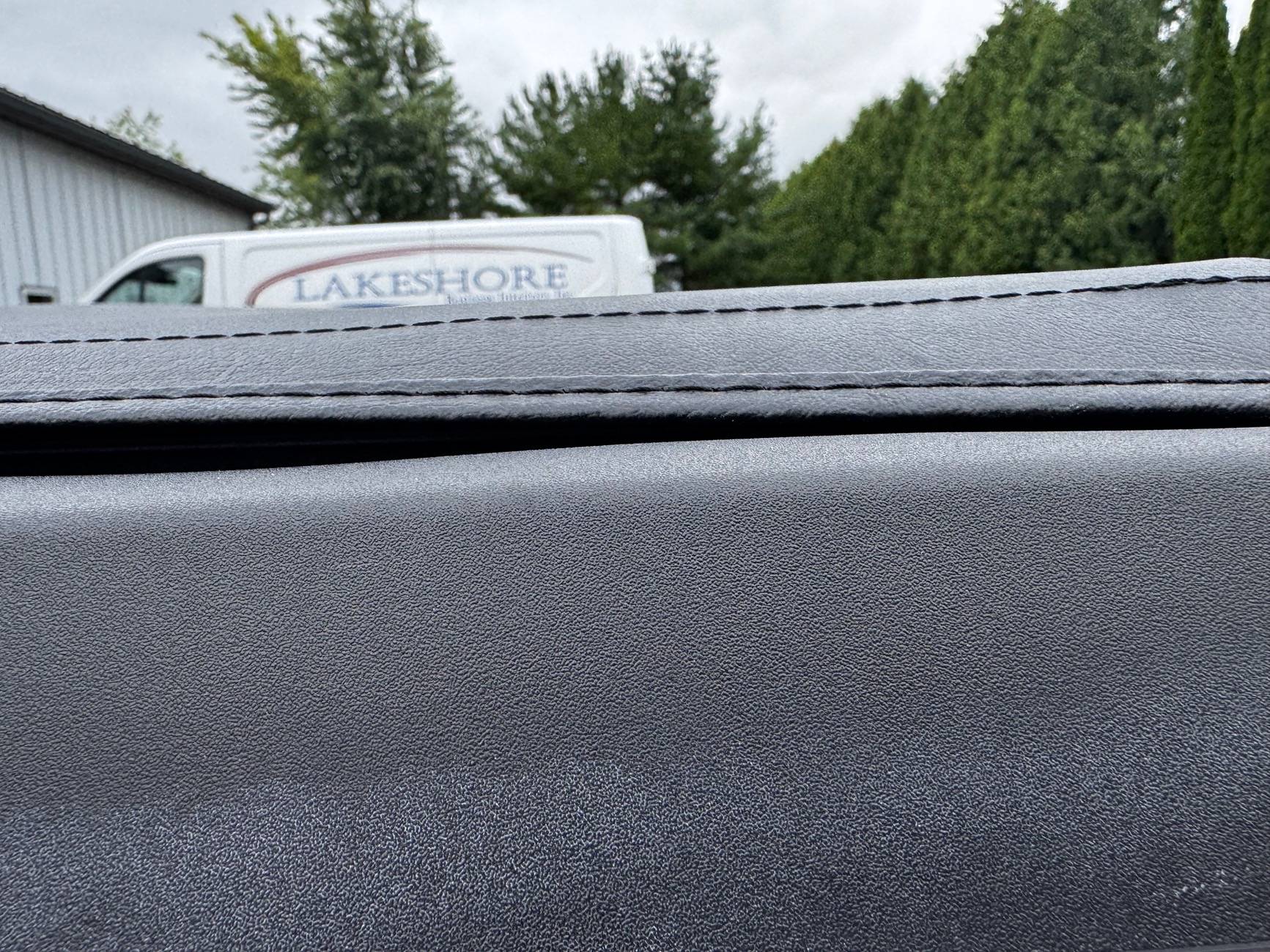

I am by no means a tonneau cover expert. I put them on and off trucks at the dealership I worked at all the time but Ive never used clamps like this before.
I bought the Tyger tonneau cover off Amazon because I’m cheap, but I think I got what I paid for. The clamps they include seem like durable blocks of aluminum but in order for them to actually hold the cover down you have to tighten the screws so hard that they look like they’re bending inside the blocks. There wasn’t a video for the Maverick at the time but the Tacoma video was identical. So I followed that video, but they never mentioned clamping force. So now after months of it being on, from the outside it looks like it’s warping the bed rail covers. And at this point because they've been clamped, I can’t loosen them at all because even a quarter turn looser and the clamps rattle around. I think between my lack of knowledge and their lack of quality hardware, my rail covers might have to be replaced if I buy a different tonneau cover :/
