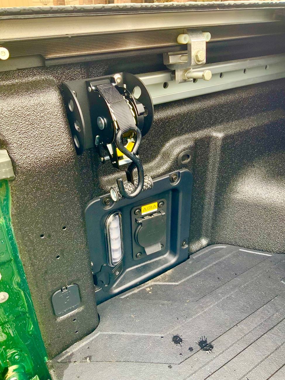

No issue doing a self install of my retractable cover with the factory rails installed
Ford Maverick Bed side rails and tonneau cover clamps IMG_4700
Ford Maverick Bed side rails and tonneau cover clamps IMG_4817

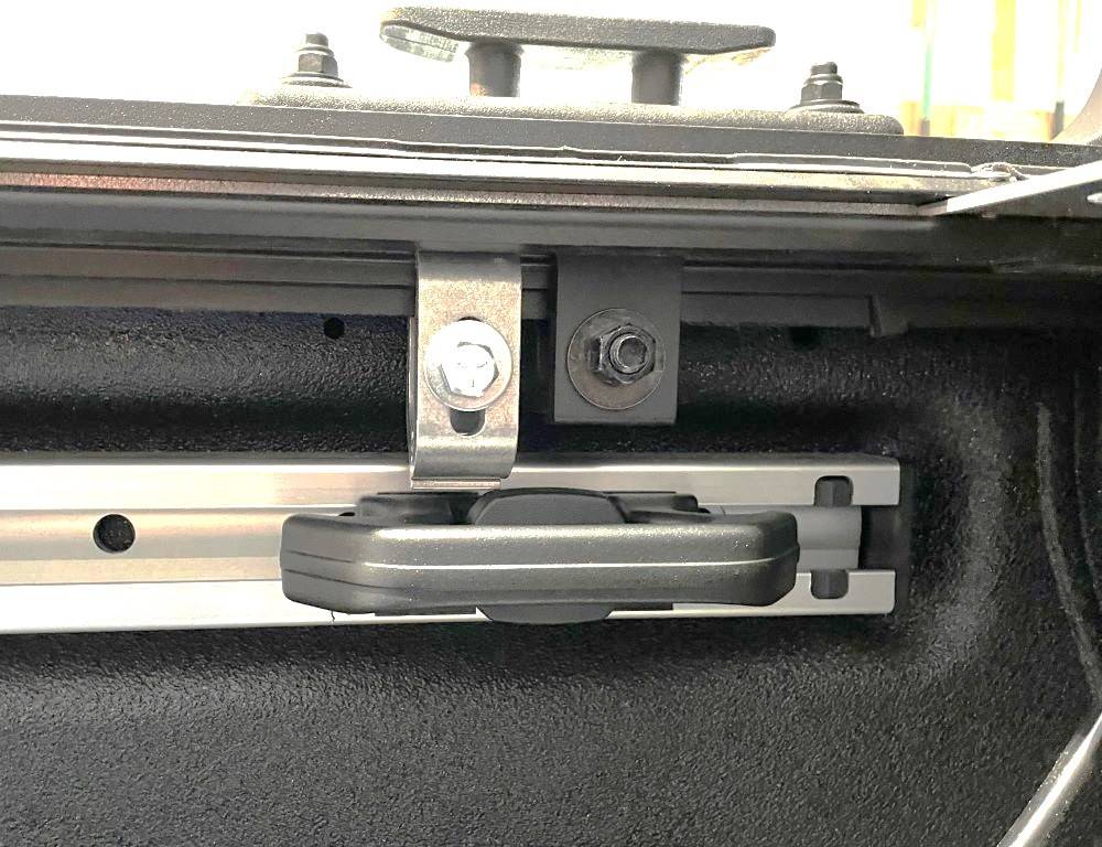

Mine came used with the tri-fold tonneau cover and no rails. This was my cure.
Amazon for under $25
Ford Maverick Bed side rails and tonneau cover clamps V rings
