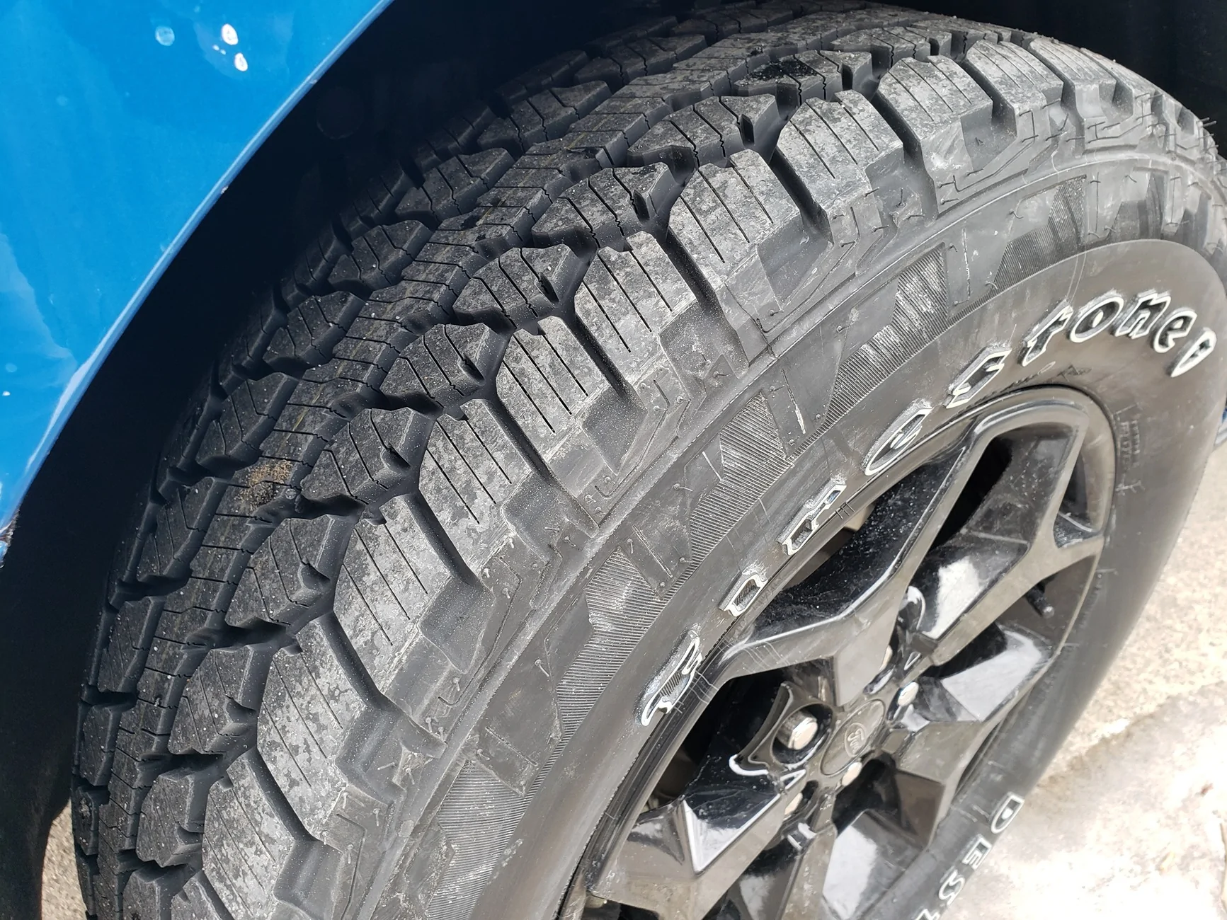

I went to a five pound each heavier AT tire on my 2021 Bronco Sport Base with the 3 banger dragon motor. From 225 wides to 235 wides.
Max power was about 190 hp or some such number that was considerably less power than my Mav.
I lost only 1 mpg.

Some of the Maverick logged mpg loss was related to odometer/speedometer error with the larger tires. But it seemed like I was filling up more often over a few tanks than usual. Since going back, I am going further on a tank.

I also had a wider (65 aspect ratio) than you are considering, so there was more rolling resistance.
