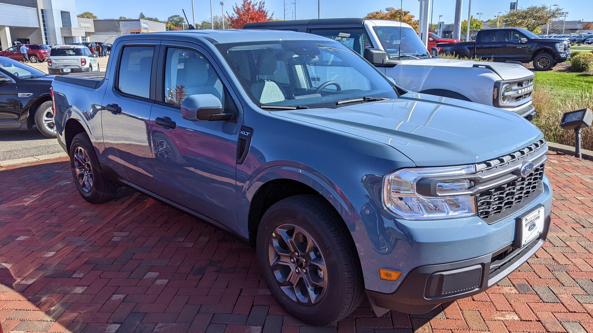

Does the hood flutter over 70 MPH?
I finally got to test drive a Maverick was VERY HAPPY! with the ride quality. Unfortunately it was already sold 😭 Only got up to 55-60 no noticeable vibrations at that speed but yes I did notice the hood flutter.
