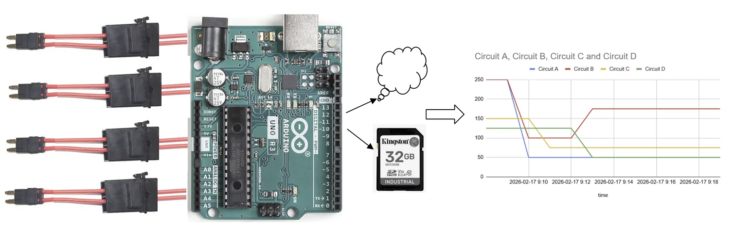

Thank you all for the info, especially @HeyBales for the deeper dive. I was hoping there was a "Good, Cheap & Easy" tool I just wasn't aware of. I've been chewing on the idea of trying to build something.
Basically a logging multi-meter. Plug it into a couple of fuses at a time, use a microcontroller to do the measurements, log the data, and then see what I find.
Ford Maverick Testing for parasitic draw, particularly overnight or intermittent? 1771504036120-7
The devil is in the details of course.

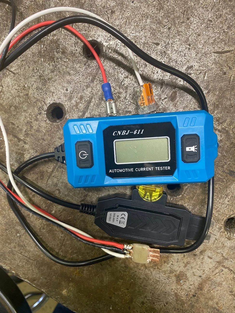

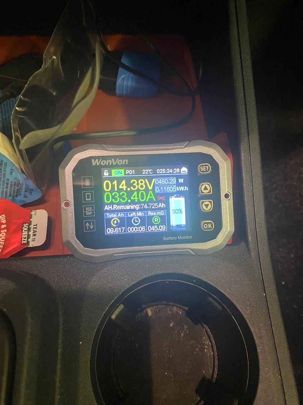

johnDeere
john
Mar 27, 2025
124
95
south haven mi
2023 ford maverick xlt hybrid
You can use one of theses.
Or this one.
Very helpful.
