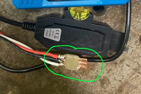

You like that,
The current unit I purchased does not have the adapter for micro 3 pin.
That one was made from flatten copper wire until the correct width and thickness.
It’s incased in plastic JB weld.
I imagine you can purchase something like that online.

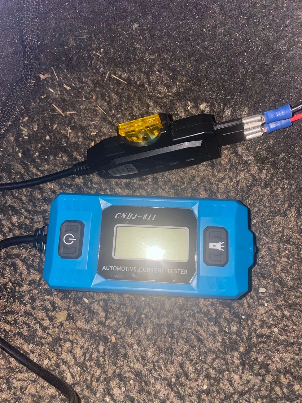

I do like that!
Why yes, you can buy something similar: Micro2 Extension holder:
Ford Maverick testing for parasitic draw 1772822215621-0
...but I'm a sucker for a good home made solution.

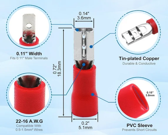

Instead of the copper, I think you may be able to use the little spade connector/disconnects: Male Spade Connectors:
Ford Maverick testing for parasitic draw 1772822333858-eq
