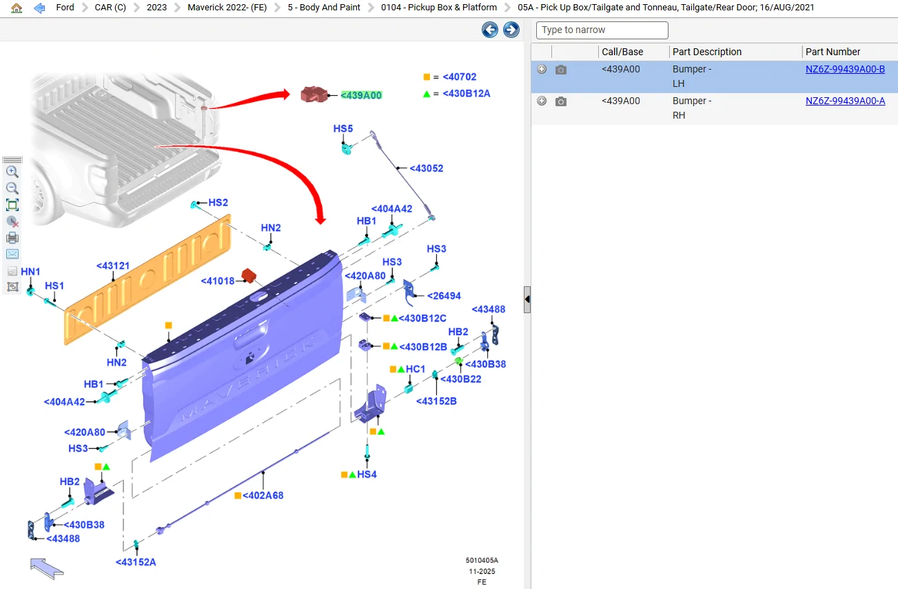

Do you mean this bumper? If so here are the part numbers you need to look for.
