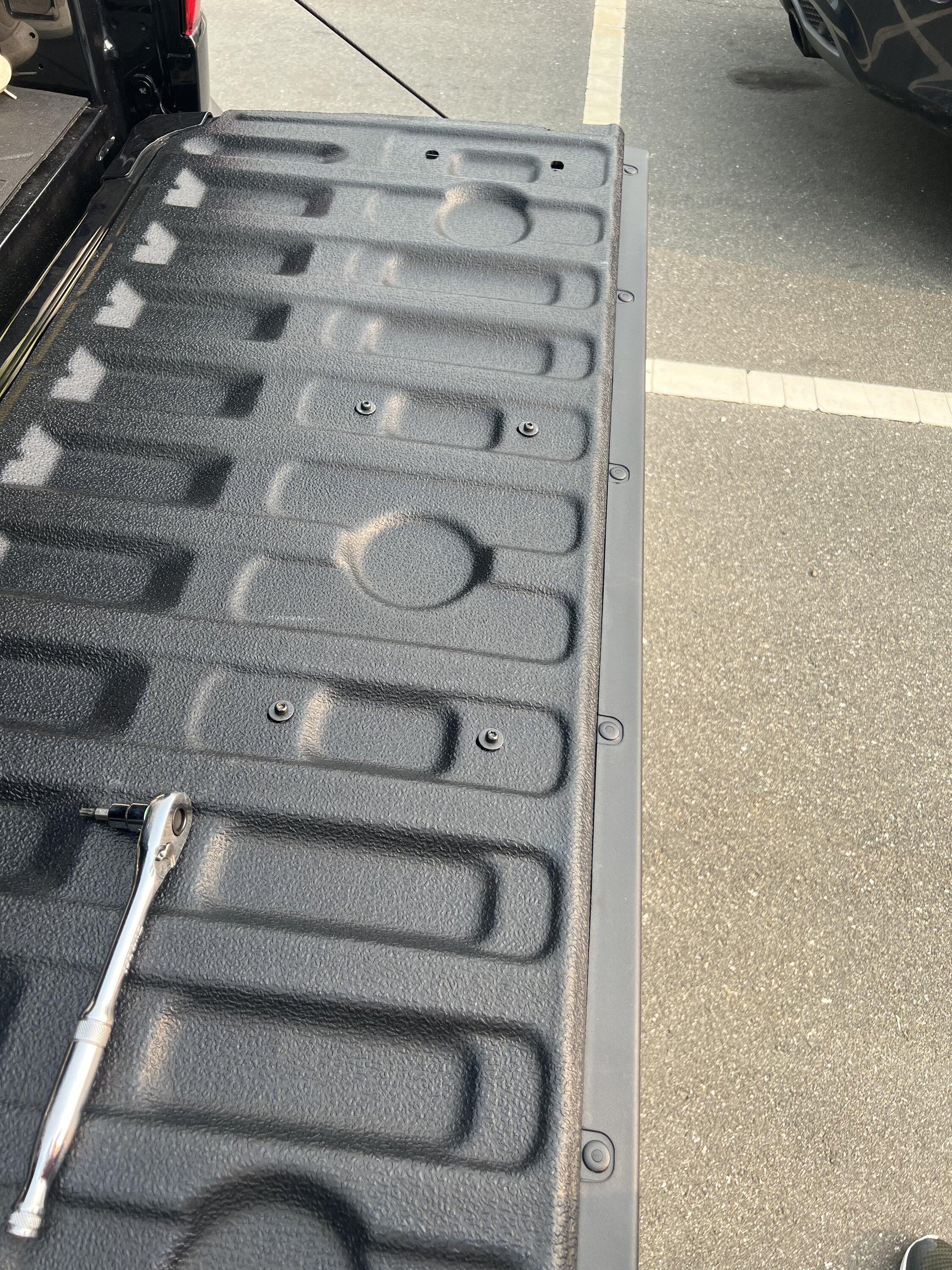

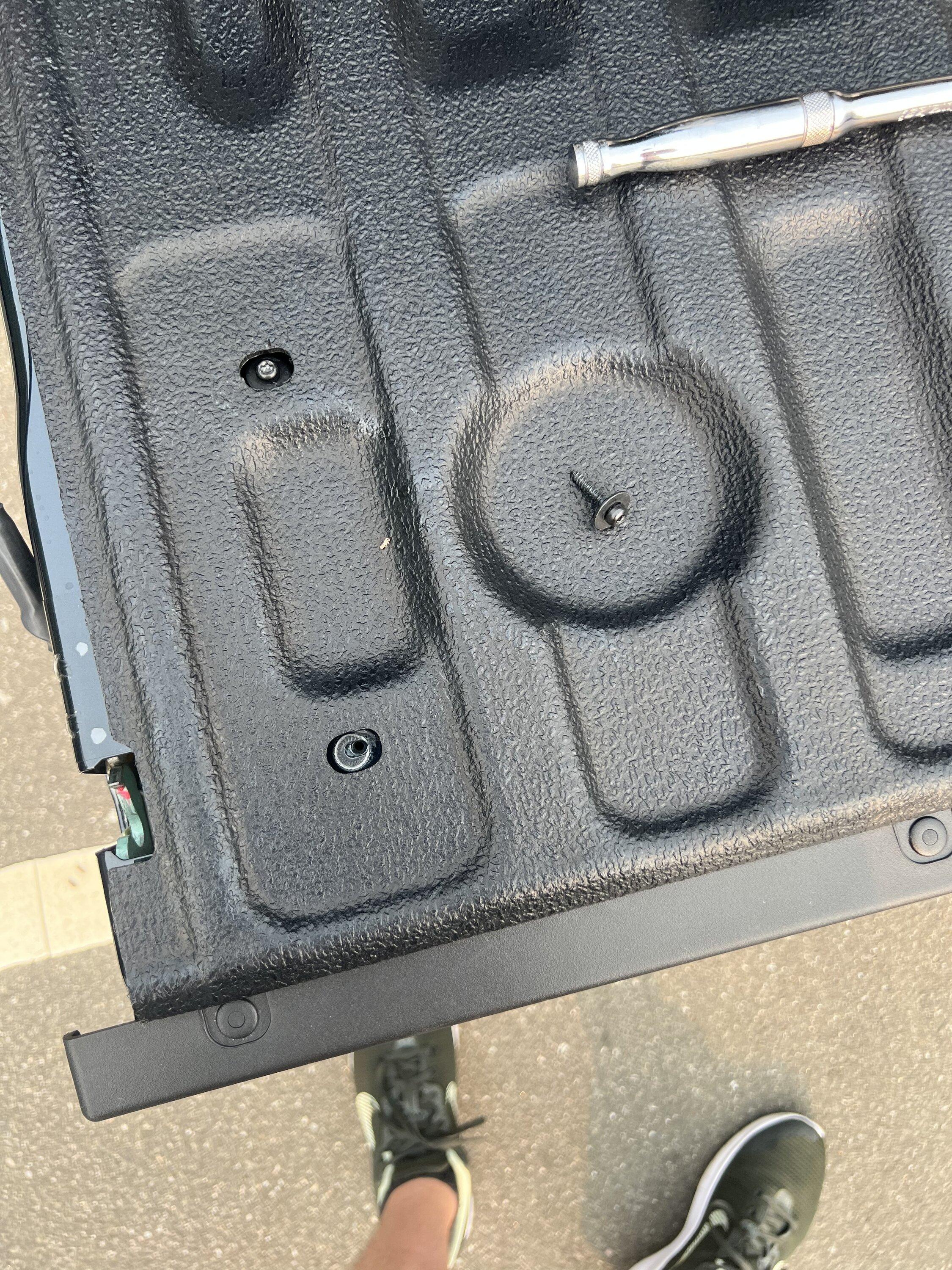

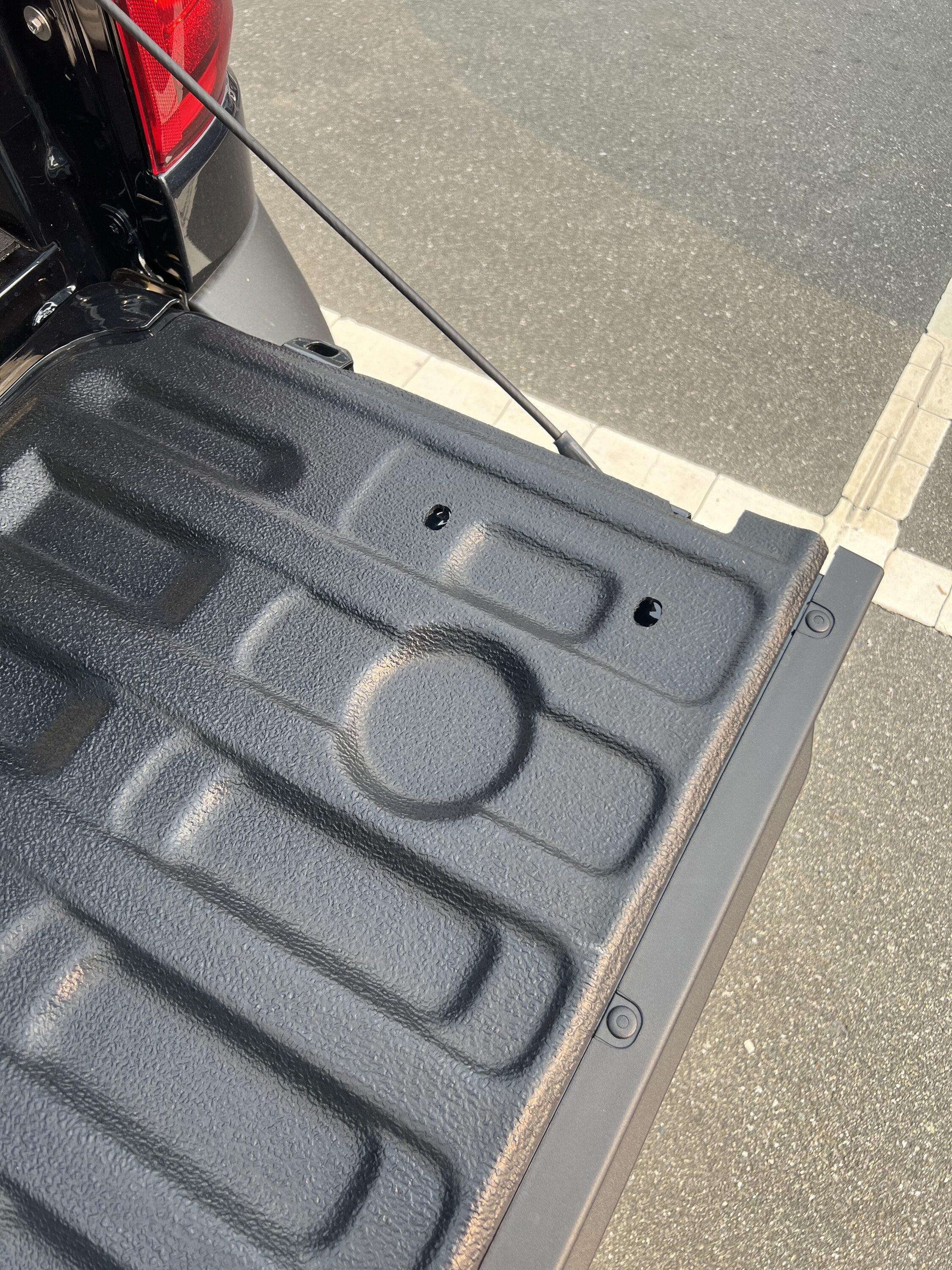

I ordered this using my FordPass points and have had to return it once already. Both times the liner came without the hardware kit. It’s crazy how incompetent ford has been with this. So, I’m just going to do it in my own. Does anyone know what specific piece is used to secure the liner to the bed when installing? I know it’s a cone type thing but not sure of the name or where to get. Thanks in advance!
Ford Maverick Tailgate Liner Kit Part No: NZ6Z-9900038-C 52D81BCA-32B5-4BF0-9ABD-98982D42B338
Ford Maverick Tailgate Liner Kit Part No: NZ6Z-9900038-C A6DBE24A-EBDF-4863-A4F5-3592A948B25F
Ford Maverick Tailgate Liner Kit Part No: NZ6Z-9900038-C C29BB9F6-9C99-4D7A-A1DA-C5AFB6B13147

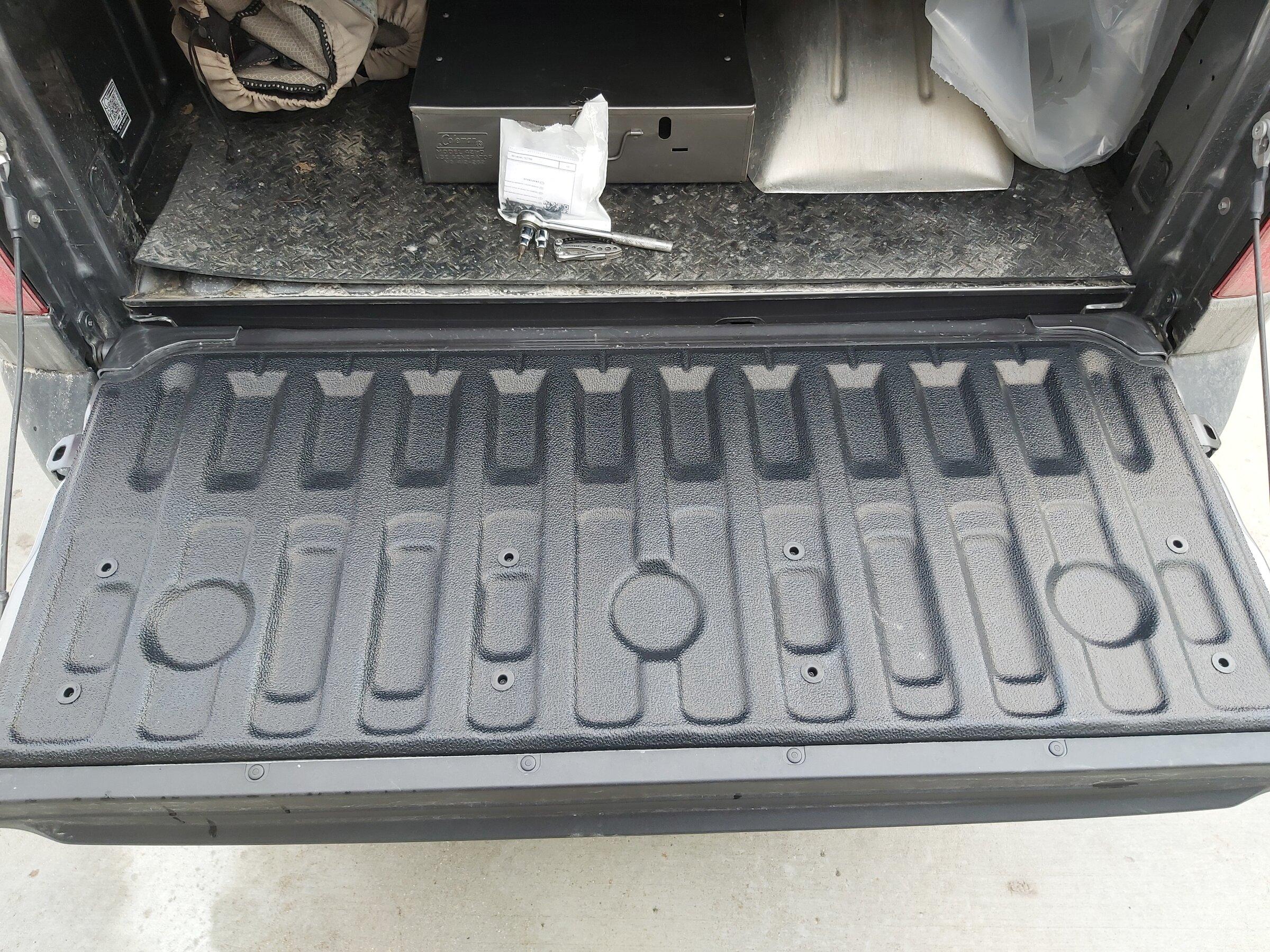

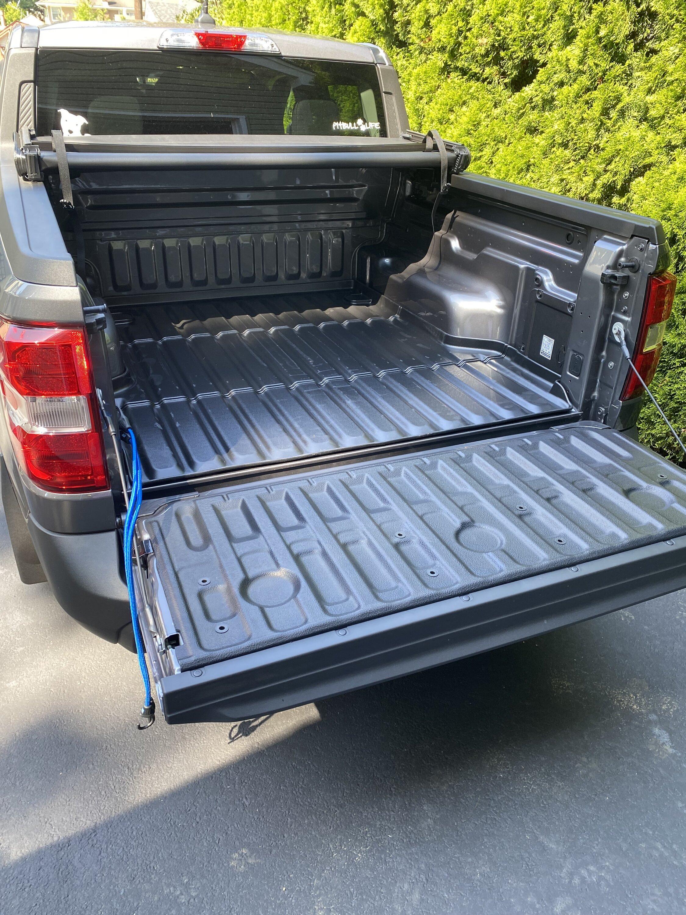

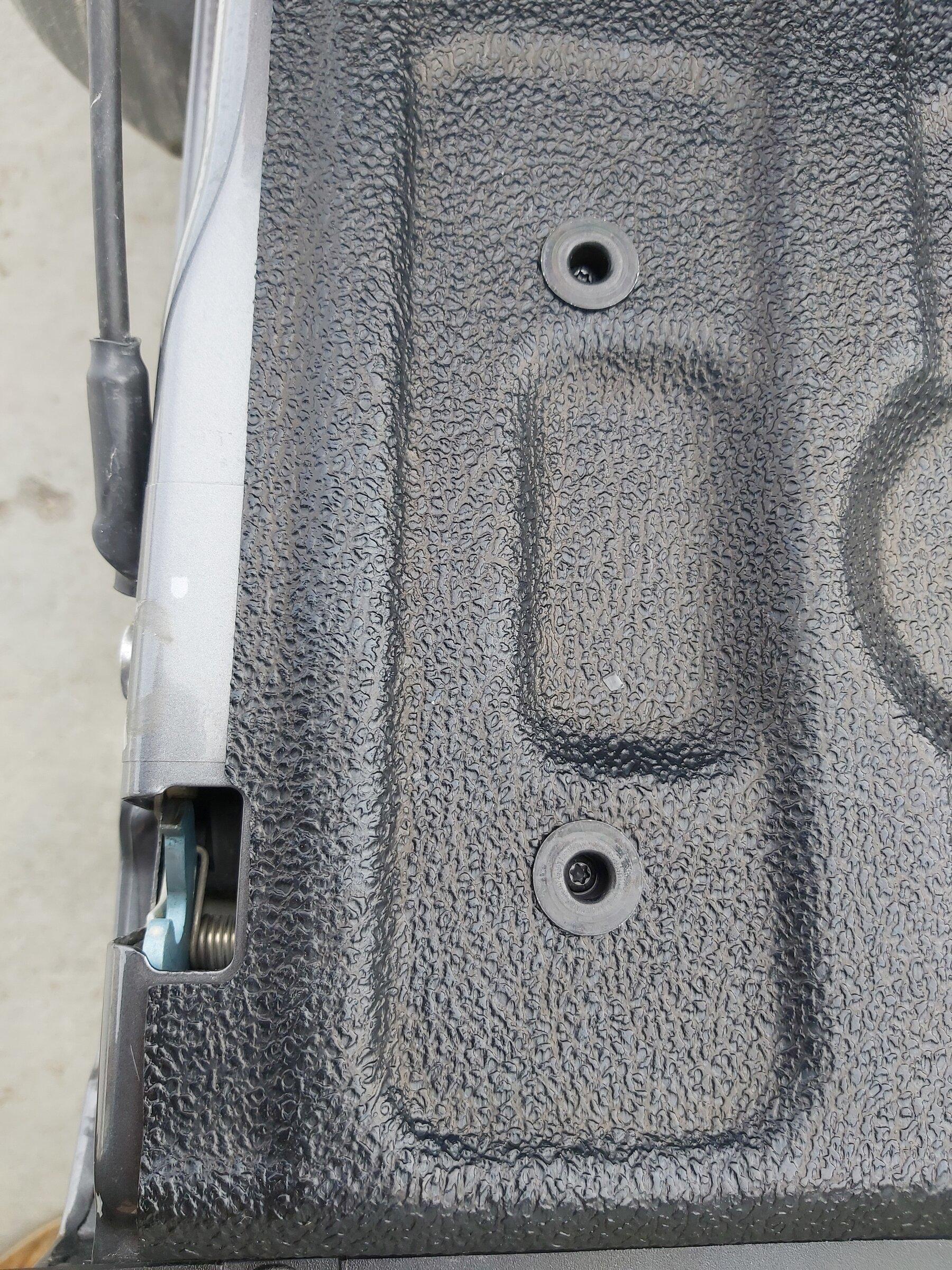

Got my "backordered" tailgate liner in, picked it up at the dealer, got 'er installed. Very quick and easy installation. Torx 25 required to remove the 8 factory installed fasteners, Torx 20 required to install the supplied fasteners. This is money well spent IMO:
The instructions aren't included, gotta scan the QR code to take you to the Ford accessory install website. Not much to the instructions anyways. The only tip I can provide is to make sure it's centered horizontally, and parallel with the top lip of the tailgate.
Just installed my tailgate liner; took all of 10 mins w the right Torx sizes.
Thanks for the tip! 👍
Ford Maverick Tailgate Liner Kit Part No: NZ6Z-9900038-C 1693930236815
