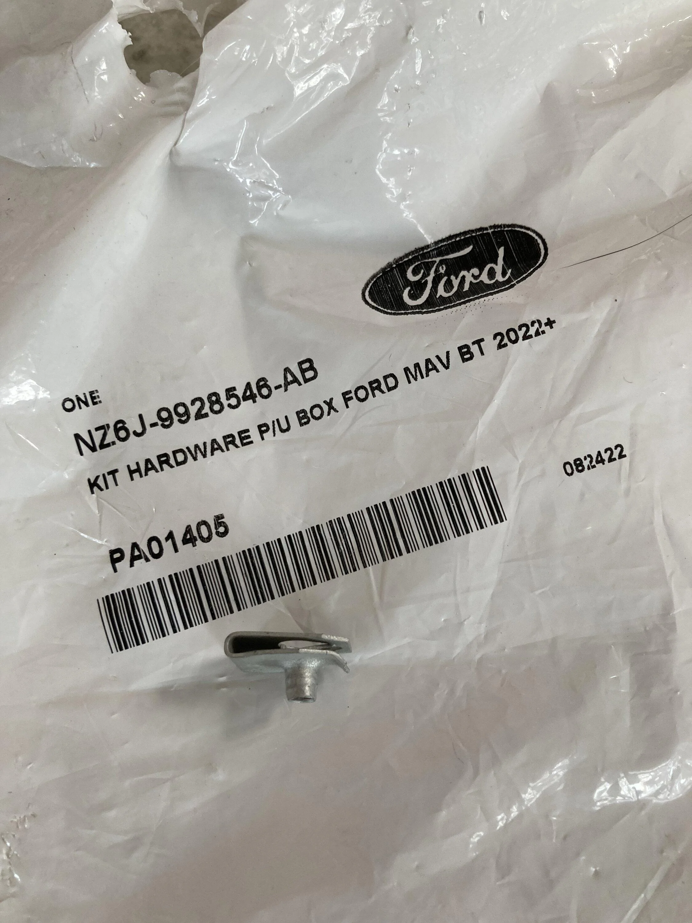

As others here have posted, my Ford Accessory Bed liner arrived missing one little piece - it only had one of the two little clips that receive the screws that secure the back of the liner.
Rather than sending the whole thing back to Ford I checked auto supply stores, Amazon, and eBay but couldn’t find the part.

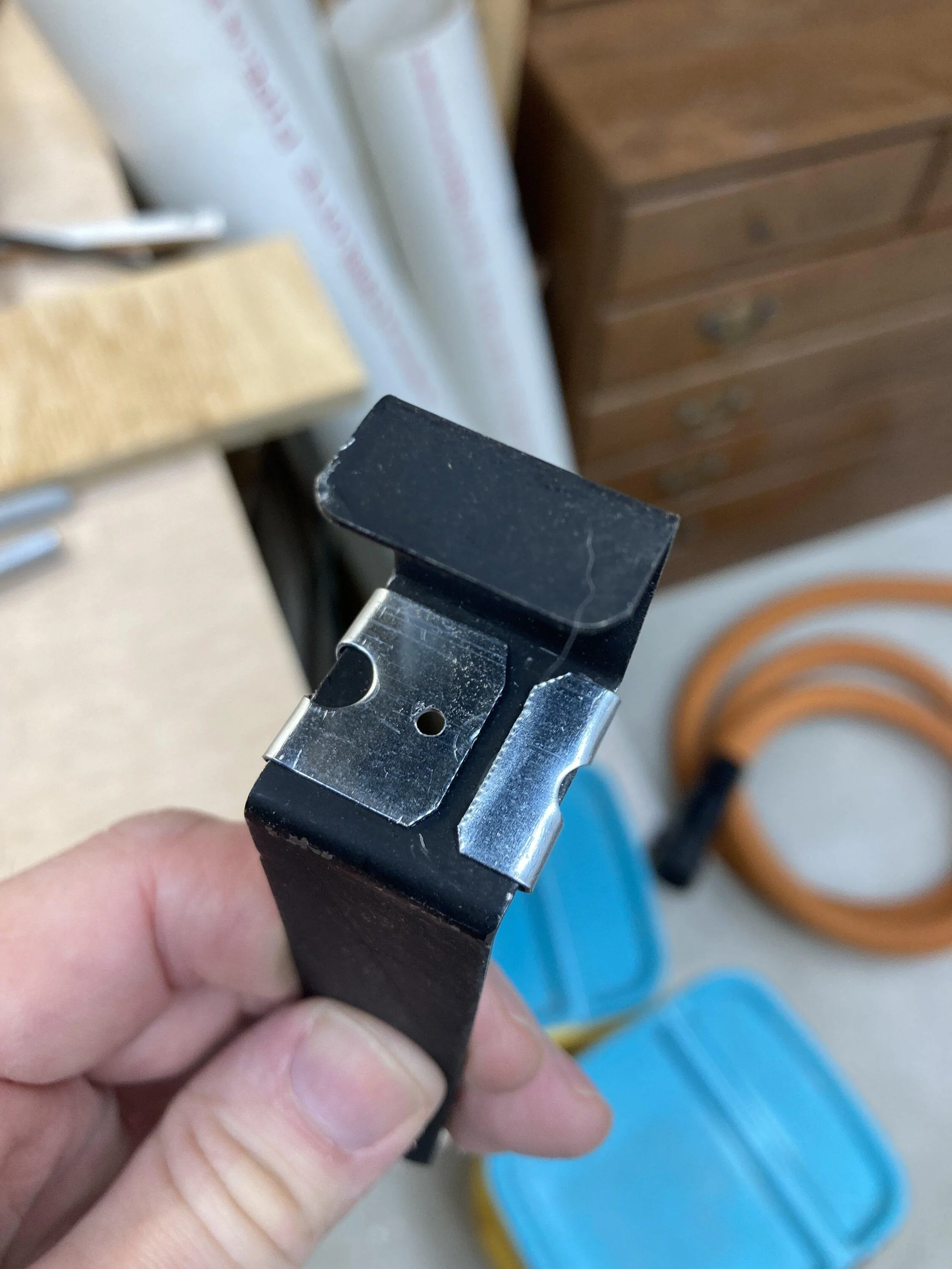

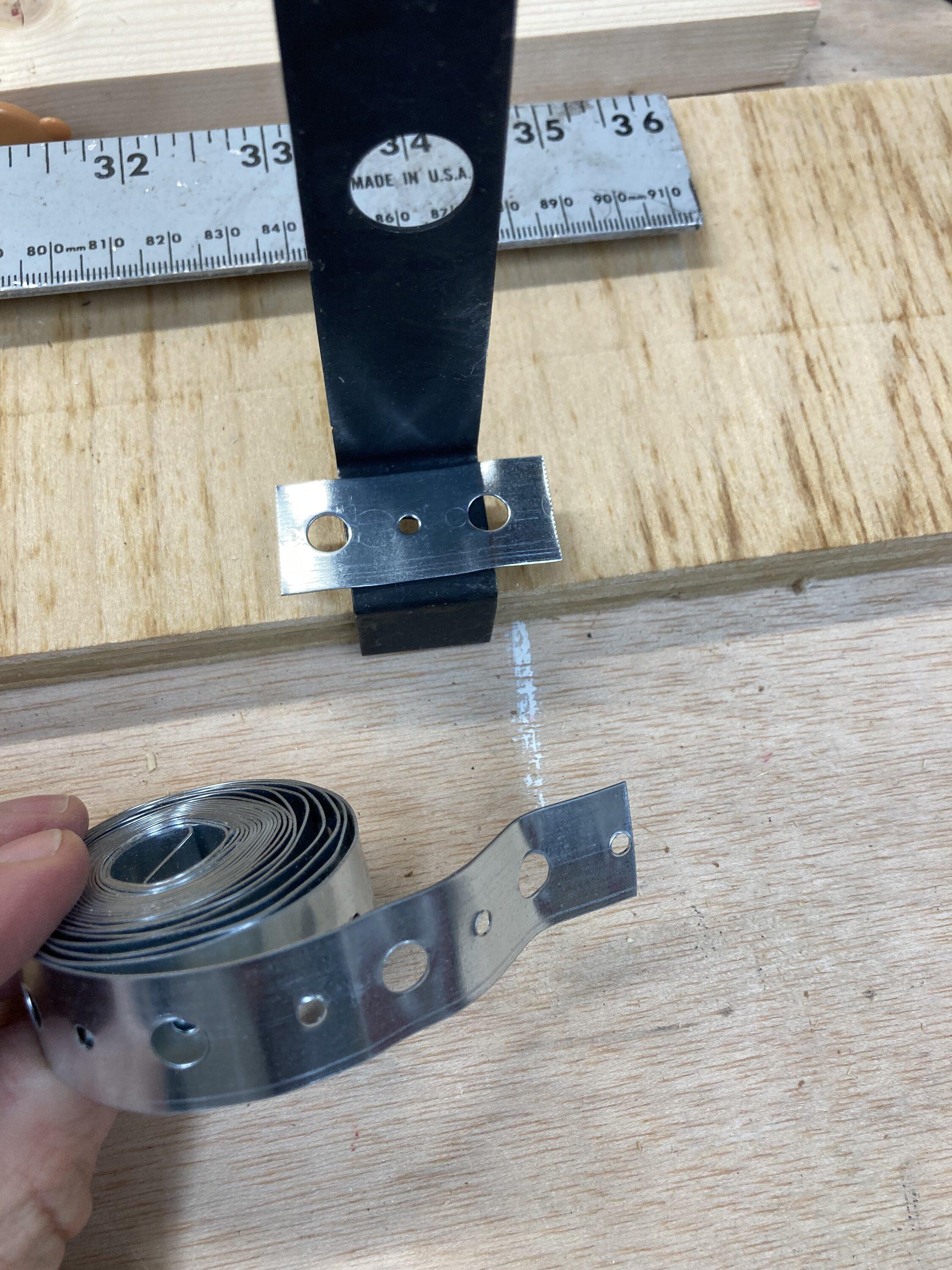

Ended up using plumbers tape to fashion my own version of the clip. I was careful torquing it down but it holds well.
