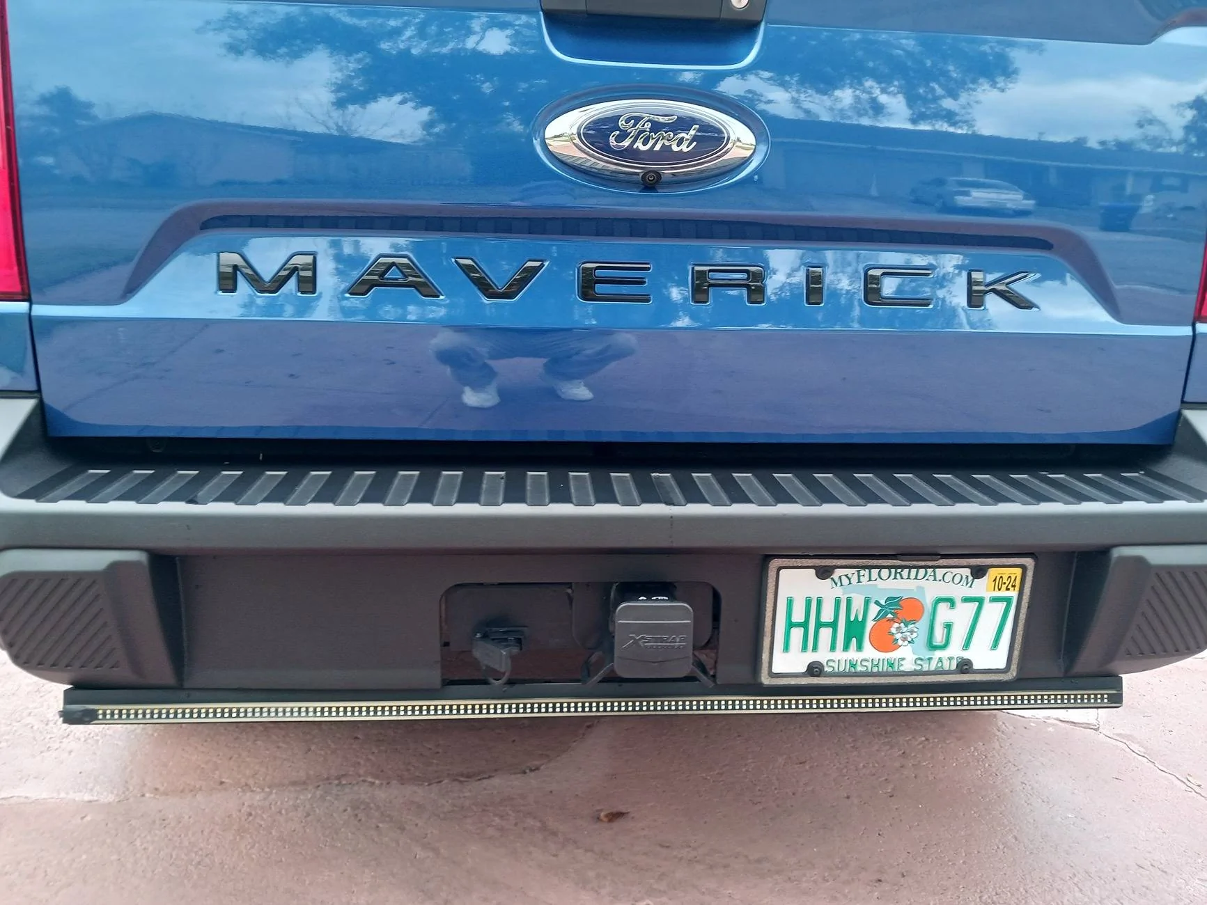

Bobby Chapman
Bobby
Feb 5, 2022
615
740
Orlando fla.
2023 maverick
Put this under bumper with 1 1/2" alum. Angle.
True Mods 49" LED Tailgate Light Bar + Signal Relay Box [Ford F-150 F-250 F-350 Super-Duty up to 2018] [Sequential Turn Signal] [Tail & Reverse Light] for Ford Pick-Up Trucks with Tow Package & BLIS https://a.co/d/6eovtSD
This one plug and play with no lost of reverse guide lines in the cab screen info center

Vomamansr
gary
Feb 4, 2024
Long island ny
Thanks
