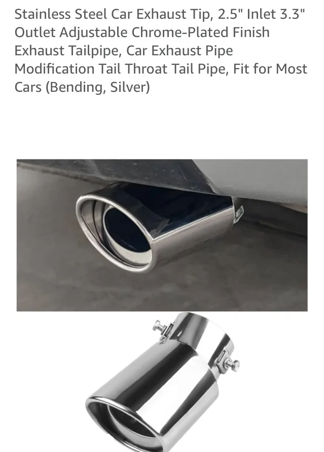

Like callouses on the hands of a working man;)
$9.99 on Amazon:
Ford Maverick Tail exhaust melting bumper IMG_9323

Never seen anything like that!
