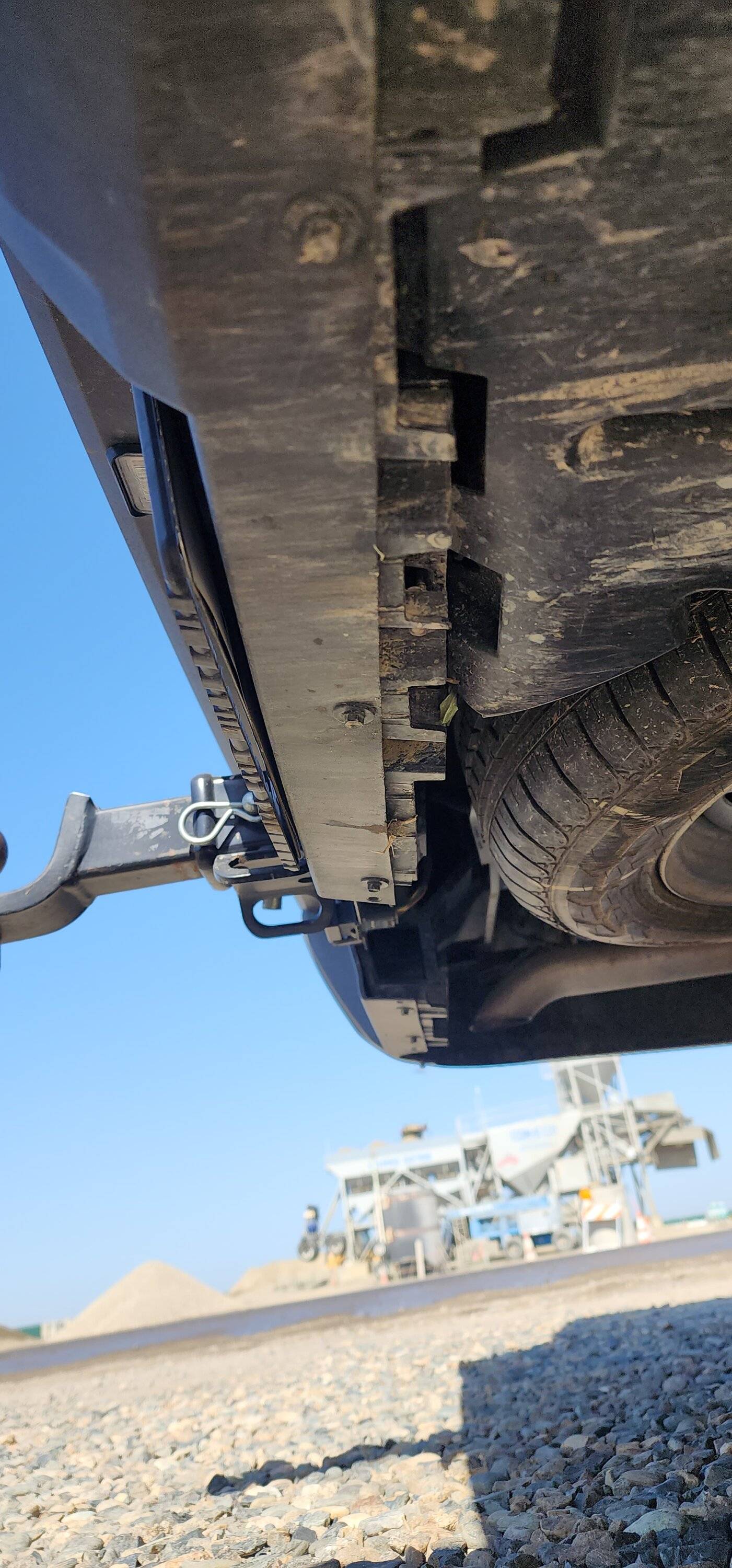

The plate came with about a 140 degree angle in it. I had them bend it so it has about a 160 degree angle. Stock it won't clear the trailer hitch safety chain attachment points or bottom of the bumper. It does provide a nice step to get in and out of the box.

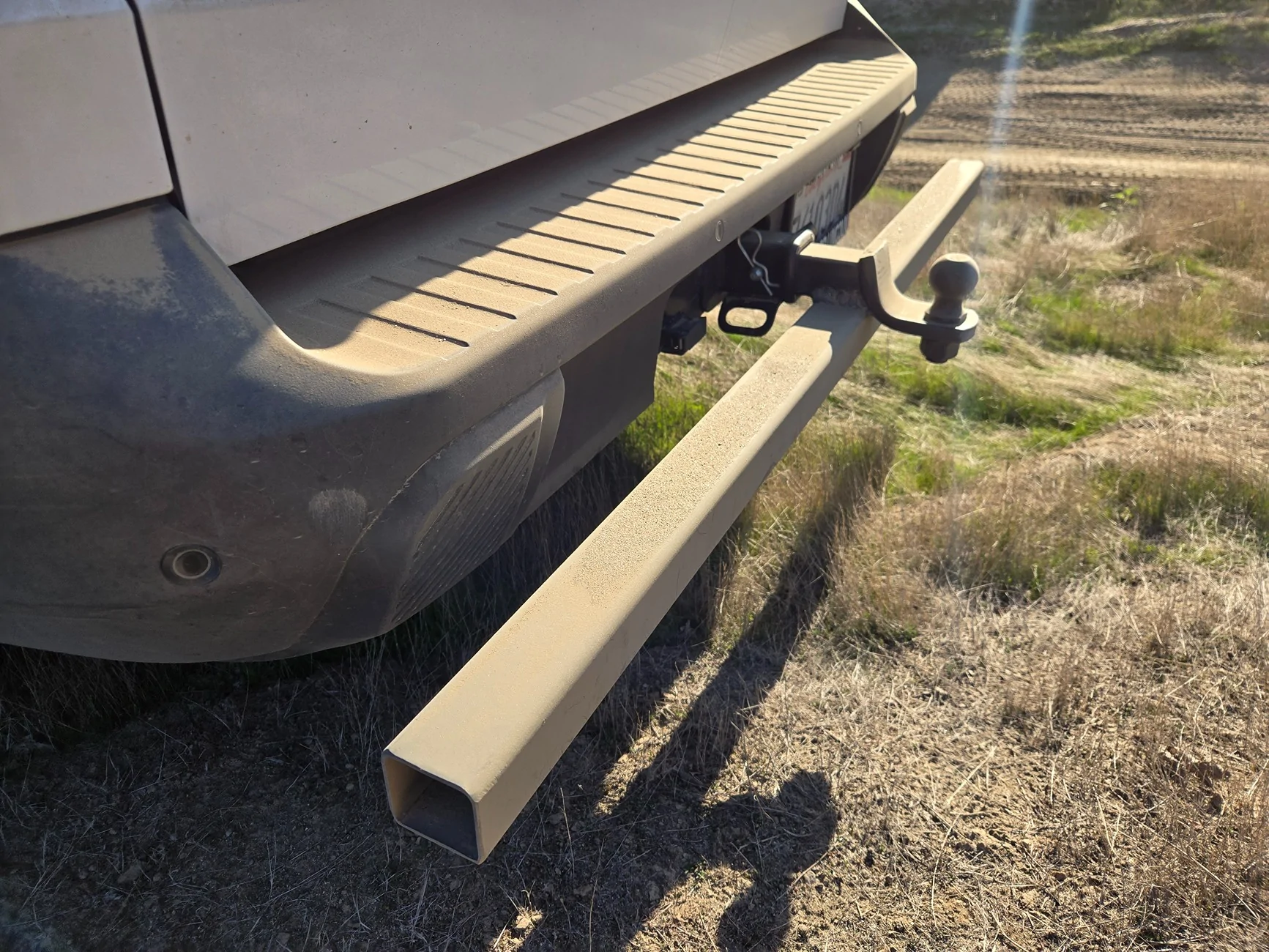

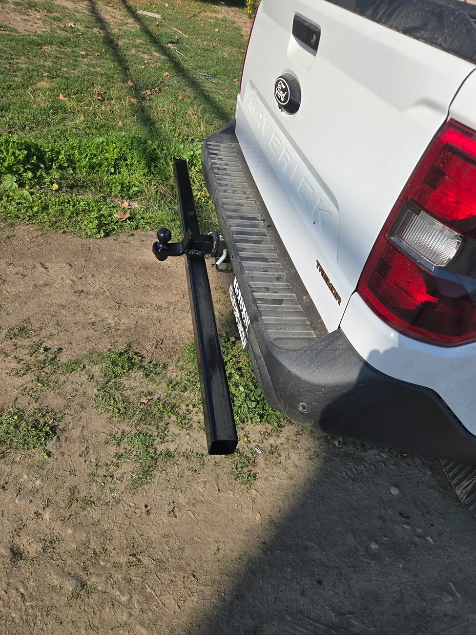

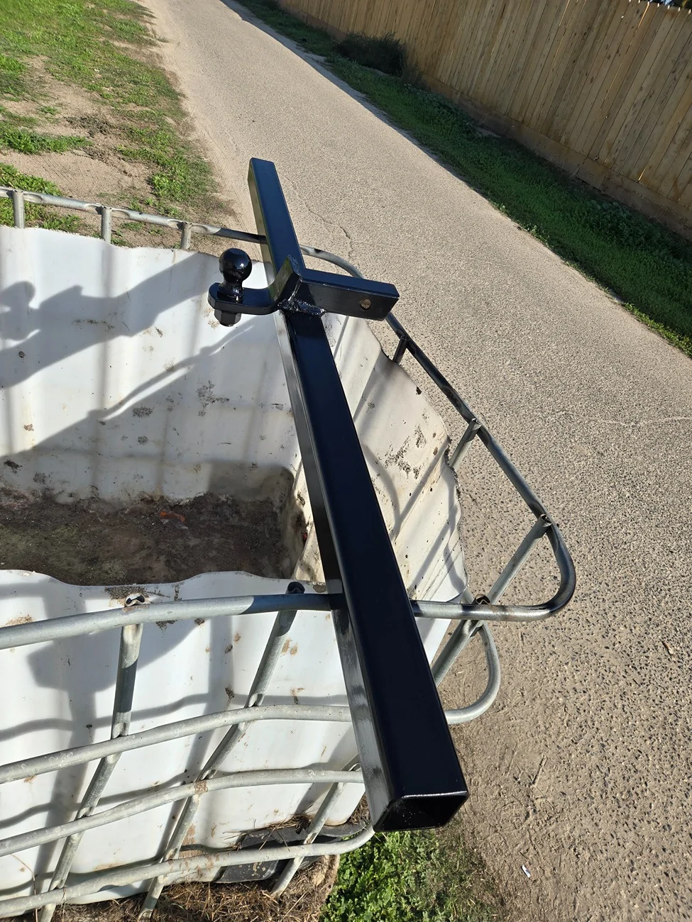

Here is my first attempt at protecting the corners of the read bumper. I basically took the guy's idea of a parking mishap bumper and turned it upside down. I can see it in the rear cam and it does not set off the rear bumper proximity sensors like the rear hitch rack does. We're headed out to the river today to see how it does. The reason I made it go all the way out to the corners is that to get over something that you do not have enough breakover is to go over the over the obstacle at an angle. This means that when your rear bumper might bottom out, it will be at the corners, not in the middle. I do still plan on trying to avoid situations where I do not have enough departure angle. I just have learned that they are not all avoidable to me :)

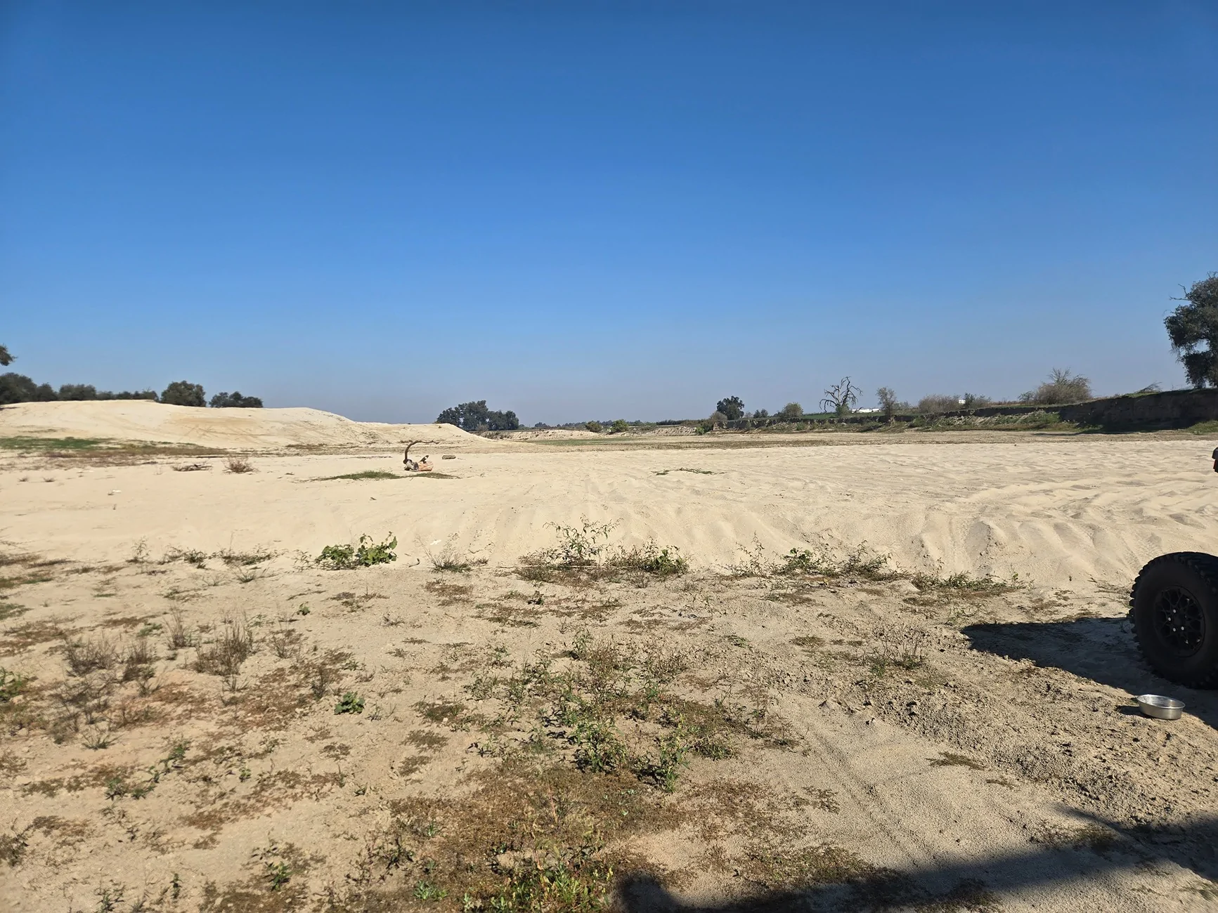

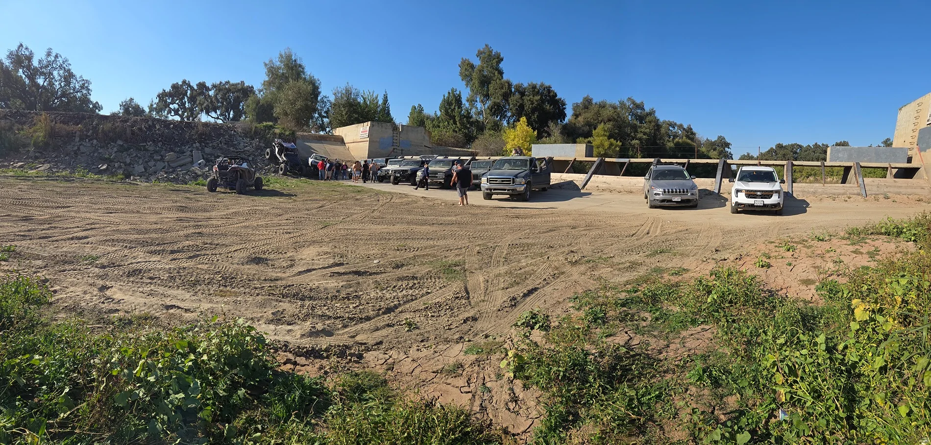

First little river adventure with the redneck rear bumper guard was a success. I heard it bottom out a little couple times :)
