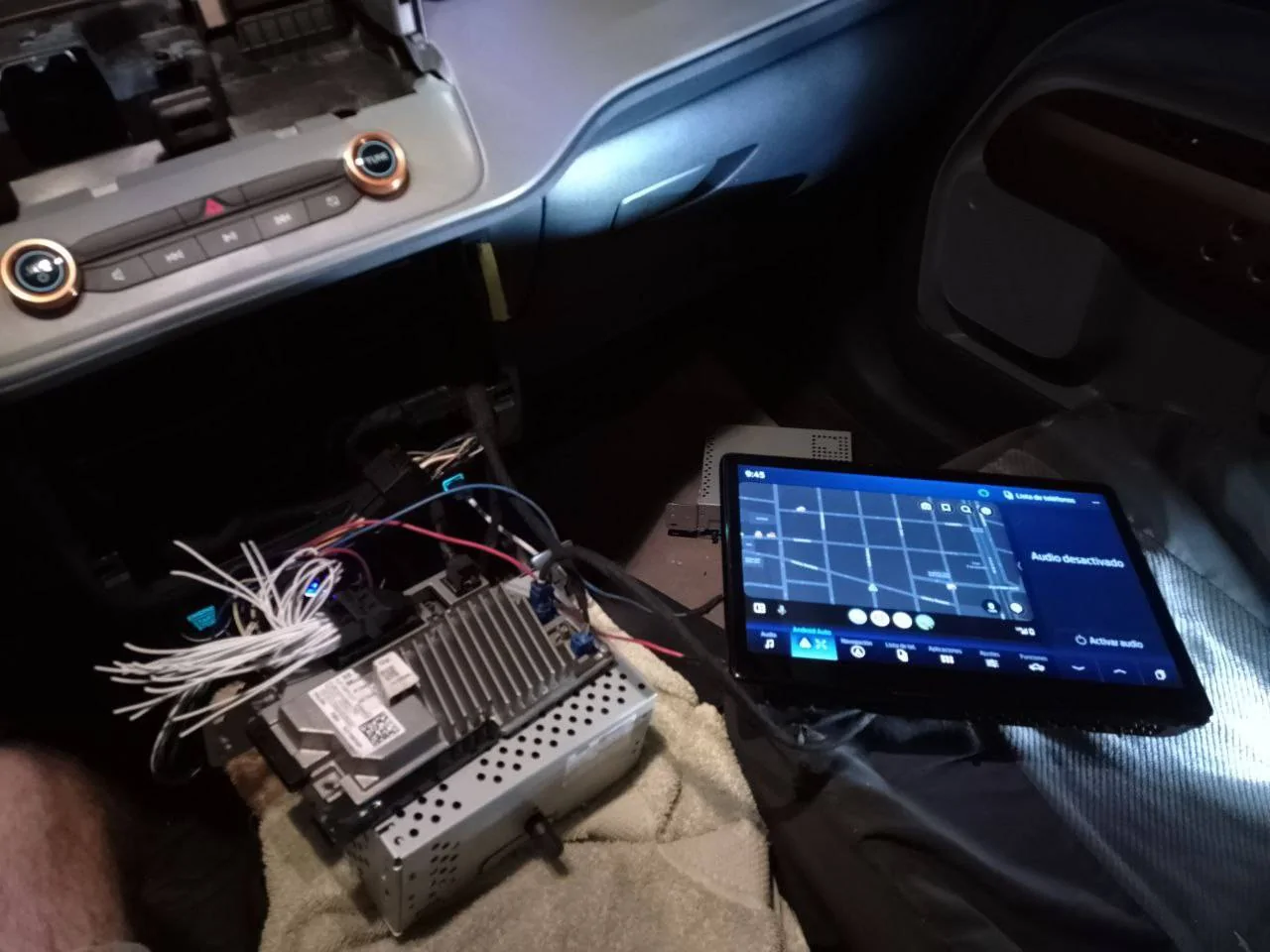

First test without programming anything...
The radio doesn't work. I hope it's because I haven't programmed anything yet!

After programming, everything seems to work fine! Even the camera!
Now we have to put everything together and find the maps for the GPS.
Is it necessary to put an antenna on the GPS?

Same issue,
. From what Mike told me if any codes in Apim/ Acm it shuts off sound. Tried every forscan settings that everyone posted and still no good. I can see volume change in apim.
I show 🔊in the apim settings
. I got to believe ACM coding
Im trying again today, if you figure please pass on Tks

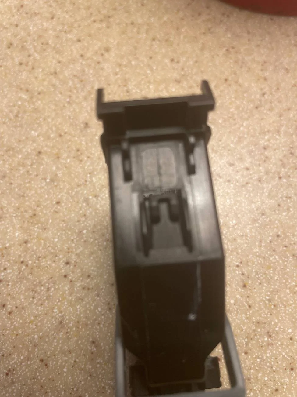

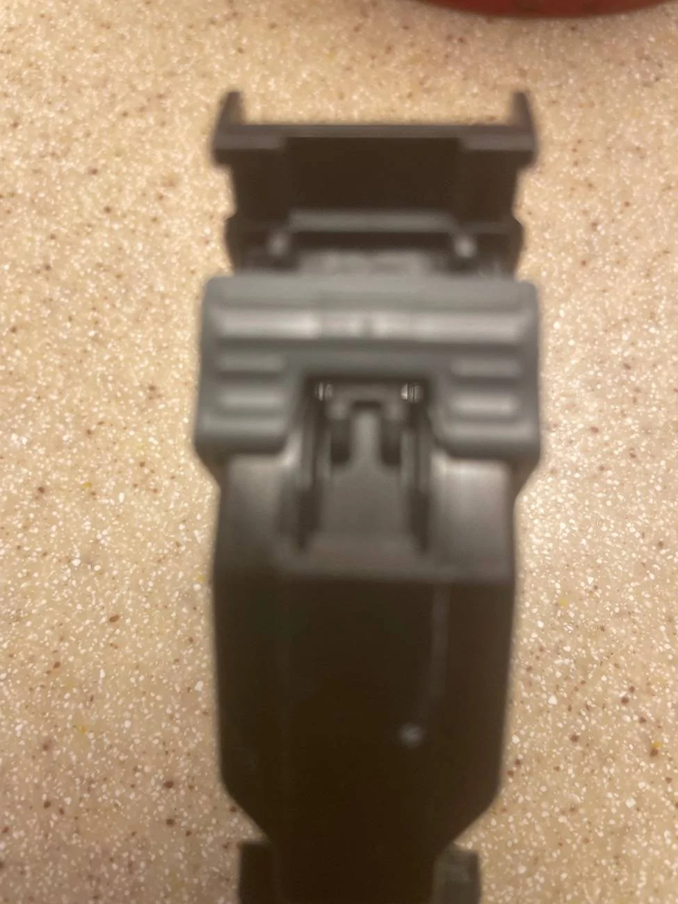

Wanted to ask you a totally off topic question, but was your vehicle already equipped with Sync3? I cannot for the life of me get this APIM unplugged. Trying to get my hands back there but it feels impossible the two times I’ve tried now.

How difficult was getting the cables out of the old APIM for you? I’m a let to remove the larger harness and usb but cannot for the life of me remove the other smaller ones. Any tips? Was it just brutal?

No I’m building a harness.
There is a clip you need to depression then lift the locking arm forward to release
de
That one’s not so bad. My truck had Sync 3 so I’m having to pull that APIM out and there’s two smaller cables towards the back and a USB cable plugged into it that I’m finding impossible to get to release. Even with the clips pressed in it feels like it’s going to break. Either that or something on the 24 changed?

And we are up! Couple issues I’ve run into now though. The back up camera works, but is acting up a bit? Incredibly dim.
And then there’s the fun of reprogramming thing. I couldn’t figure out how to get the volume to display properly (stuck on 0) but did get climate controls to display. Also can’t figure out how to get the splash screen to full screen again.

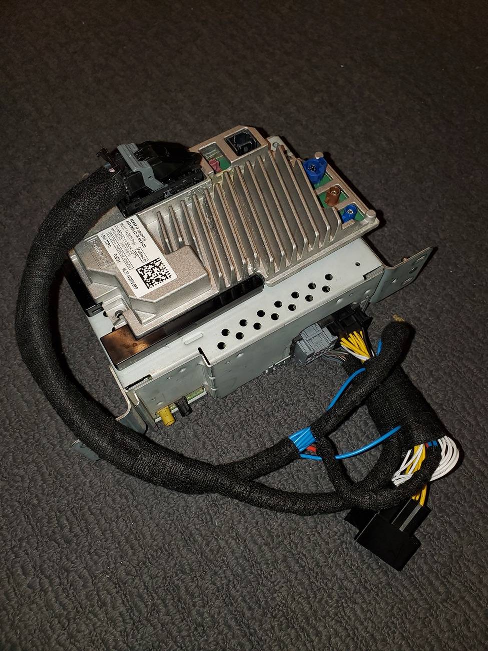

Ford Maverick Sync4 APIM and 13.2" Screen Installation Guide (Lariat Models) 20241225_013436
Harness all done, just waiting on the power cord for the screen. Progress!
Same issues. But Car play instant. Got to be programming did you have any codes? I had a full splash till I programmed according to Zack’s settings
So it was odd. At first, the back up camera did nothing. I’d put the truck in reverse and the screen would stay on CarPlay or whatever it was on already. In Forscan I went to the APIM module and saw the rear camera was disabled, so I enabled it and now the camera turns on when the truck is put in reverse, but the feed is incredibly dark and slightly glitchy on screen.
I’m not sure if it’s a processing thing in a different module I need to reset, a reset of the fuse itself, or if the wiring on the harness is the issue.
There are a couple other small bugs I need to figure out, but really the only important thing that isn’t working 100% correctly is the back up camera.
Looks good, hope programming works
Bill did a 3 to 4. his programming is on here. May get yours going, I tried his also but still no sound.
Strange we all have same issue.
You got sound?
