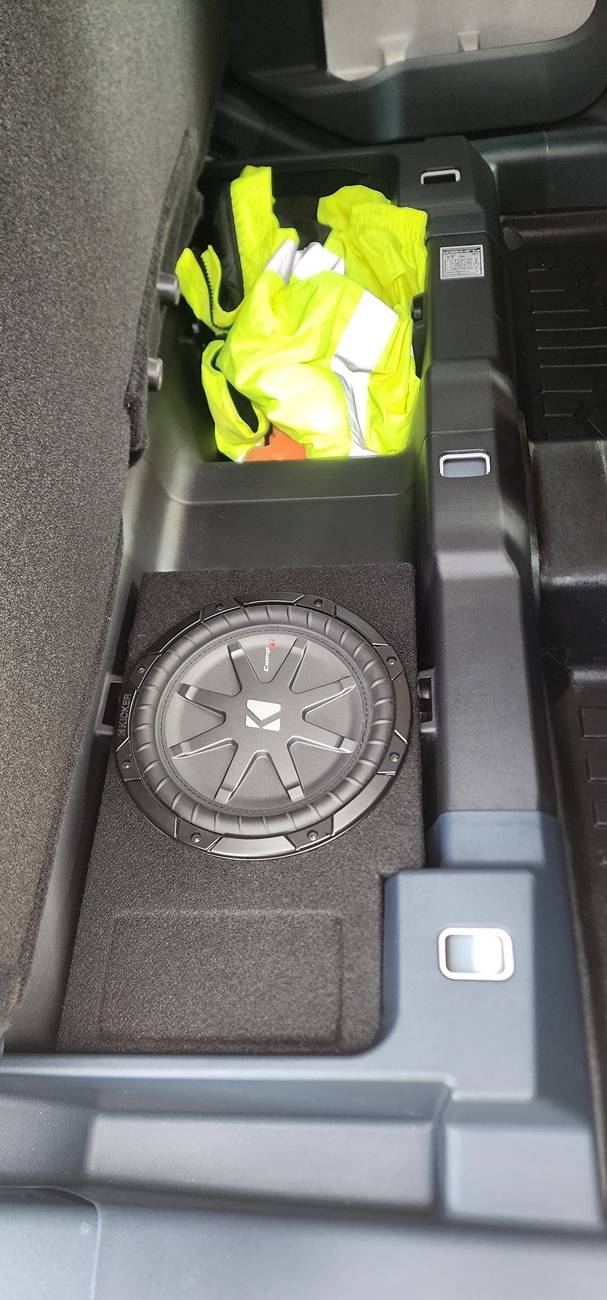

I have the ground shaker box with a 10" Kicker comp r sub. It works perfectly in that box.
I chose the ground Shaker because I was able to get both passenger side and driver side boxes less than the sound decisions box. I use the passenger side box and sold the driver side to recoup half of my money back, so it was a no-brainer for me.
When I ordered my boxes I specifically asked them not to install the plastic ground Shaker plates. They kindly replied they would ship them separately and not install them which they did for me.
Ford Maverick Subwoofer options 20241030_151136

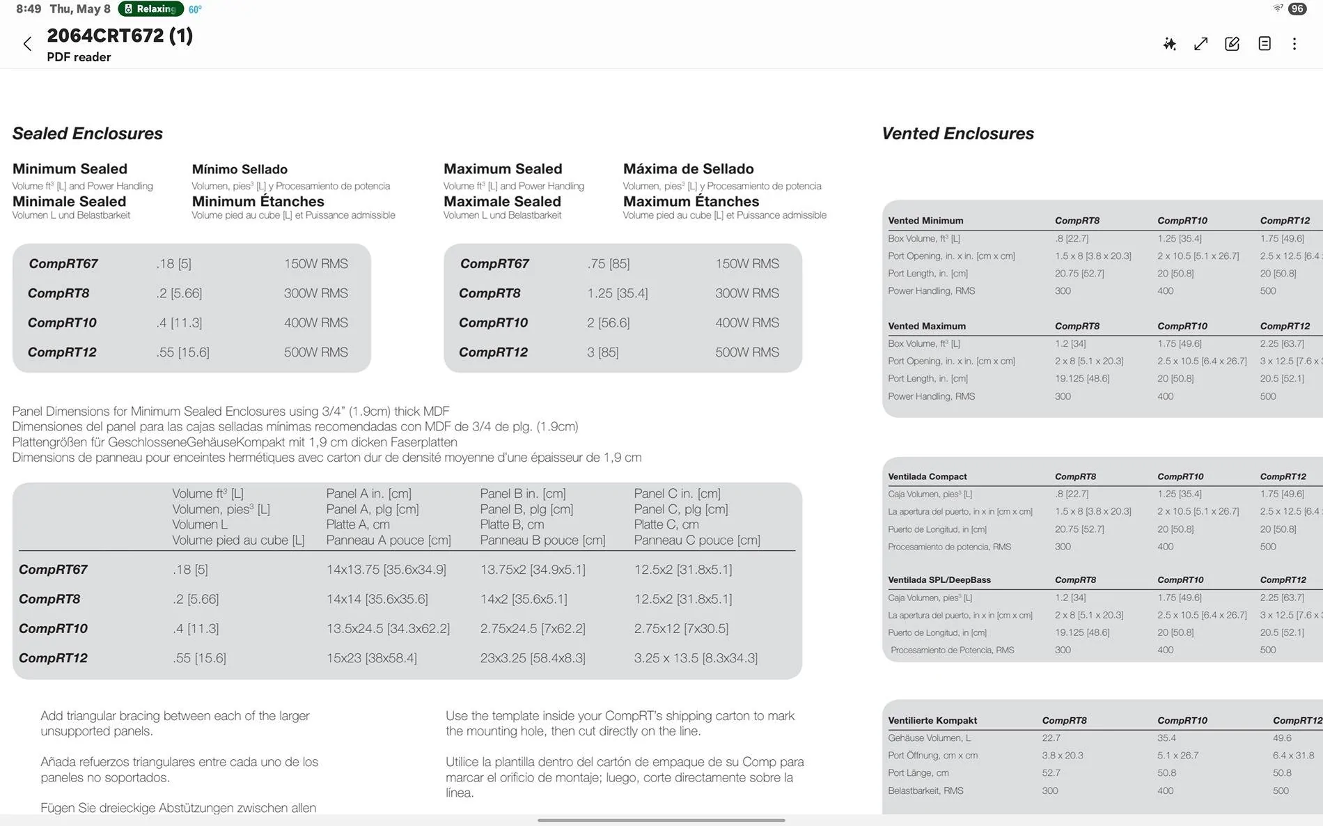

Actually it's .4-1.25 reccomended.
Ford Maverick Subwoofer options Screenshot_20250508_084942_Samsung Notes

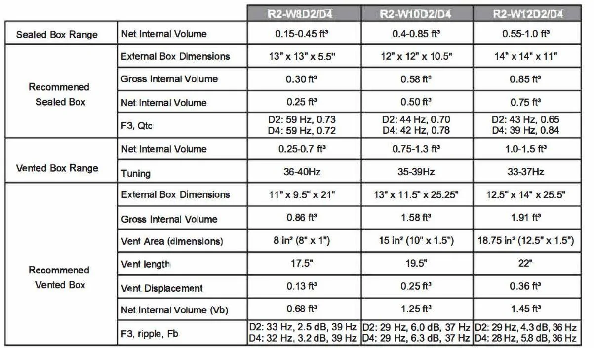

alpine r2 10" fits in the sound decisions box which as mentioned is 0.6ft3 per side. if I didn't have a kid going to college this fall, I would have already upgraded to that, just a question of single or dual. LOL
Ford Maverick Subwoofer options Screenshot 2025-05-08 090543

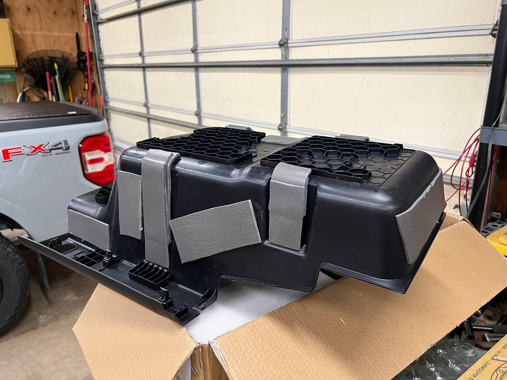

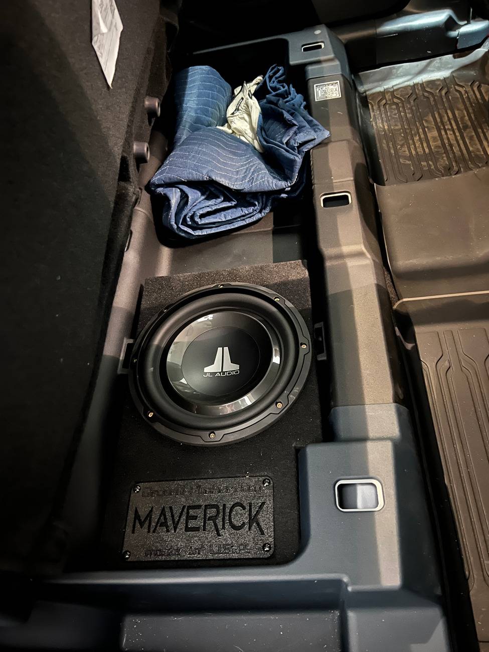

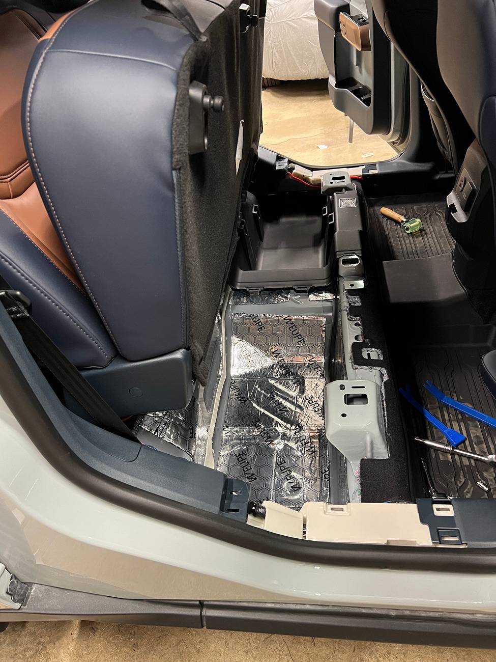

I did the passenger side Ground Shaker 10" and a 2 ohm JL Audio 10W1v3 paired with the Kicker Key 500.1. Used the B&O sub lead. Sounds great. Clean. I did take the plastic bins out and used a whole box of sound deadening back there. Also open foam on the bins. Sound-deadening the Maverick makes a huge difference.
Ford Maverick Subwoofer options IMG_4831
Ford Maverick Subwoofer options IMG_4845
Ford Maverick Subwoofer options IMG_4847
