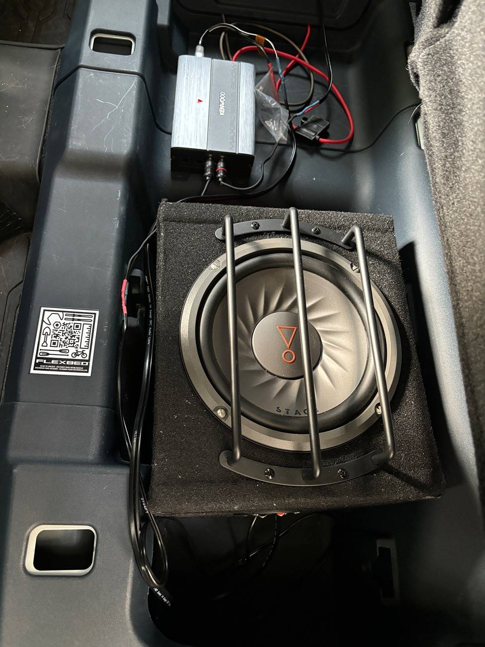

On another note, I'm thinking that enclosure is quite a bit too small for the sub you're using. You're not going to get much low bass from that. I'm not trying to be a downer, but rather trying to temper expectations. I would try to get more air space for that sub for sure with a little larger enclosure.
I'll also whole heartedly agree with the Forscan Flat EQ change!!! You won't notice the difference on factory speakers, but you will absolutely notice on a subwoofer. It is a cake walk to do, since it is in easy mode. I hope that helps!
Thank you @rallyshark . The woofer is rated for .25ft. The box is more like .23. I put a little poly fill in. This is my first sound mod and I’m definitely a novice. I’m afraid to commit myself to tapping at the head unit ā€˜cause then I’ll have to thread the speaker wire. We’ll see.

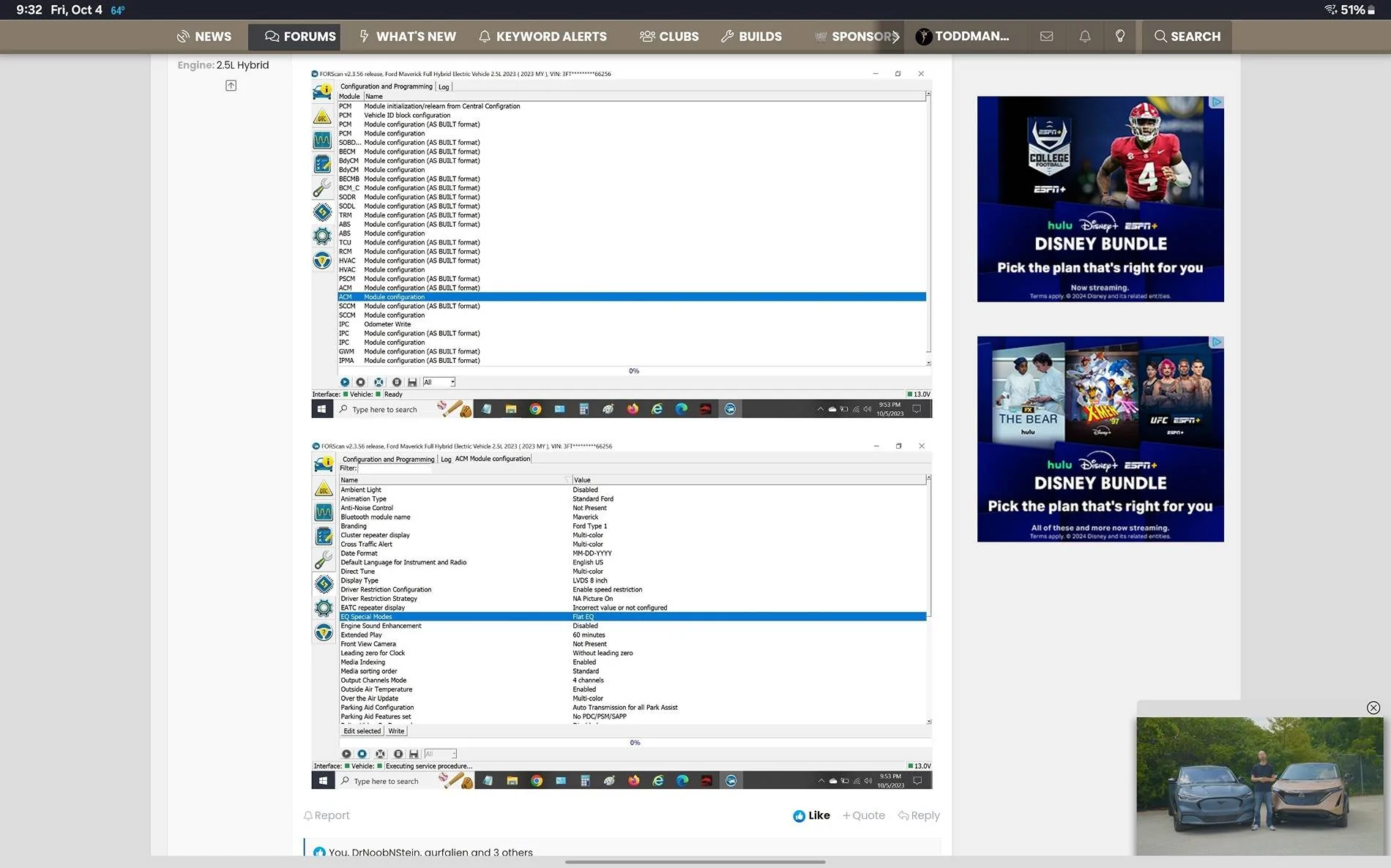

For XL or XLT systems, you MUST change the Forescan EQ to "Flat EQ" to have any usable LF signal below 55Hz on ANY of the speaker lines (front or rear) you intend to tap for the subwoofer.
The default Factory EQ setting RAPIDLY rolls off below 55Hz to ALL speakers; basically no signal in the subwoofer range that is usable.

Note that when you do the Forscan "flat eq" setting, the "Driver" head unit mode becomes identical to "All Seats" (no measurable change between them).
