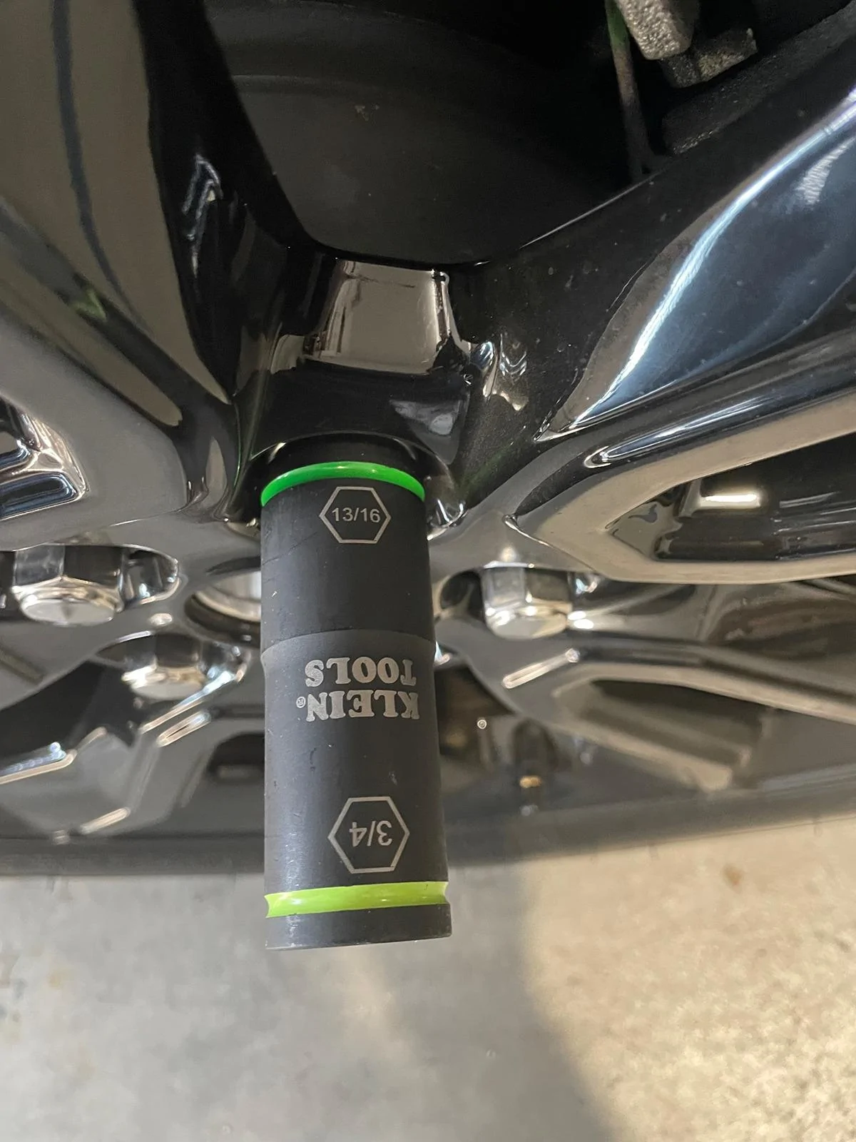

13/16" socket works perfect on my XLT (13/16=20.63mm)

Agree in spirit but Maverick's have 21mm, not 19.
On new, non-swelled Ford lug nuts, 13/16" (.8125") actually fits better than 21mm (.8267"). My Klein Tools 3/4"-13/16" flip socket.
