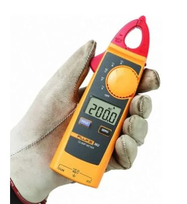

I guess there are some "mini" style clamp meters.
Ford Maverick SSM 53801: 2022-2025 Maverick Hybrid 12V Battery Drain Issue Update Fix Released! 1748280675437-7m
But still, now a chart of all the wires in a huge bundle.
Hopefully a location where the protector can be removed to spread them all out.
And good enough eyes/light to see the colors and hope they aren't repeated.
What a nightmare.

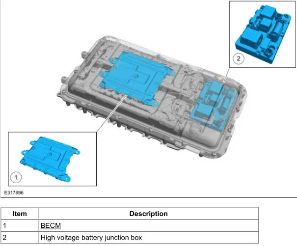

12V BJB design might be for space savings. I see they're in the Escape & Maverick, gas & hybrid.
High Voltage ~300VDC doesn't go thru the BJB.
414-03 High Voltage Battery, Mounting and Cables Description and Operation 2023 - 2024 Maverick
The high-voltage system consists of the following components:
• High-voltage battery cable
• Inverter System Controller (ISC) also known as the SOBDMC
• Electronically Controlled Continuously Variable Transmission (eCVT)
• Direct Current/Direct Current (DC/DC) converter control module
• ACCM and A/C compressor assembly located on lower LH side of the engine block
• High voltage battery pack
