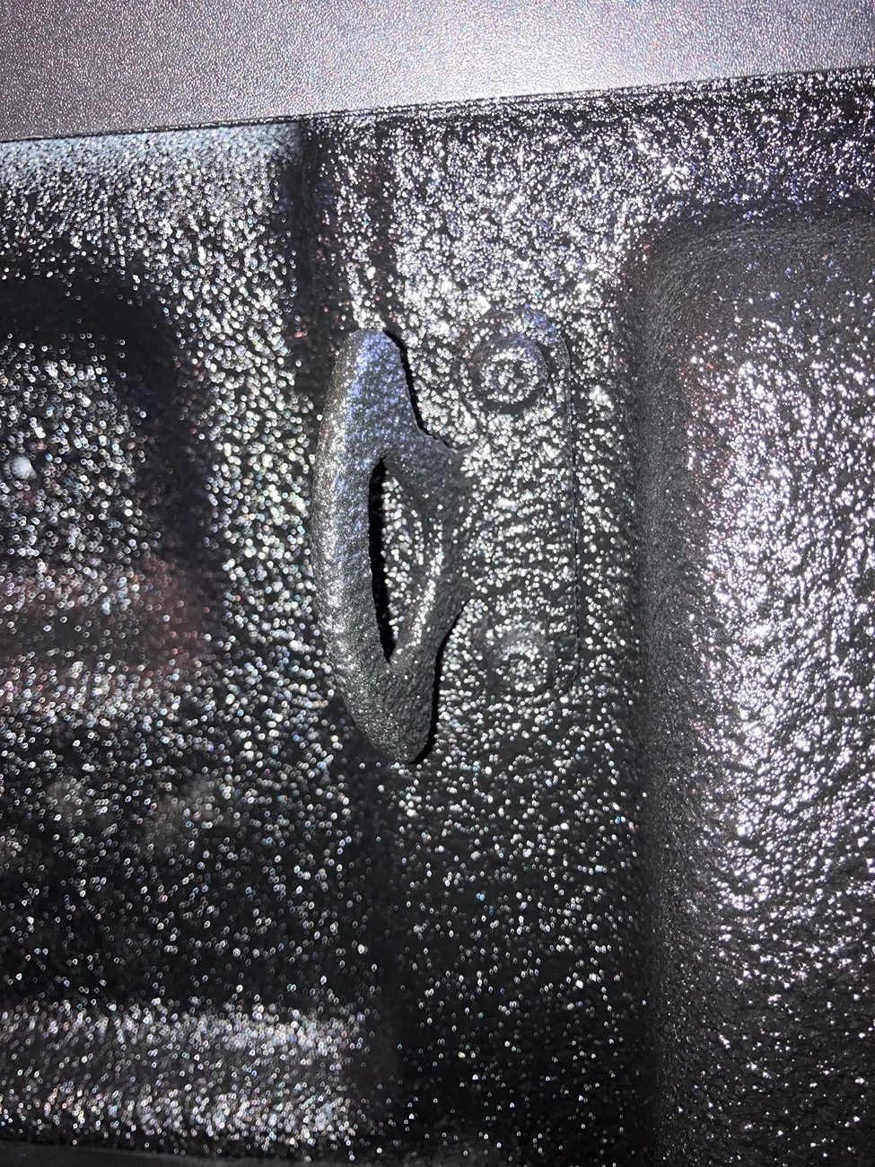

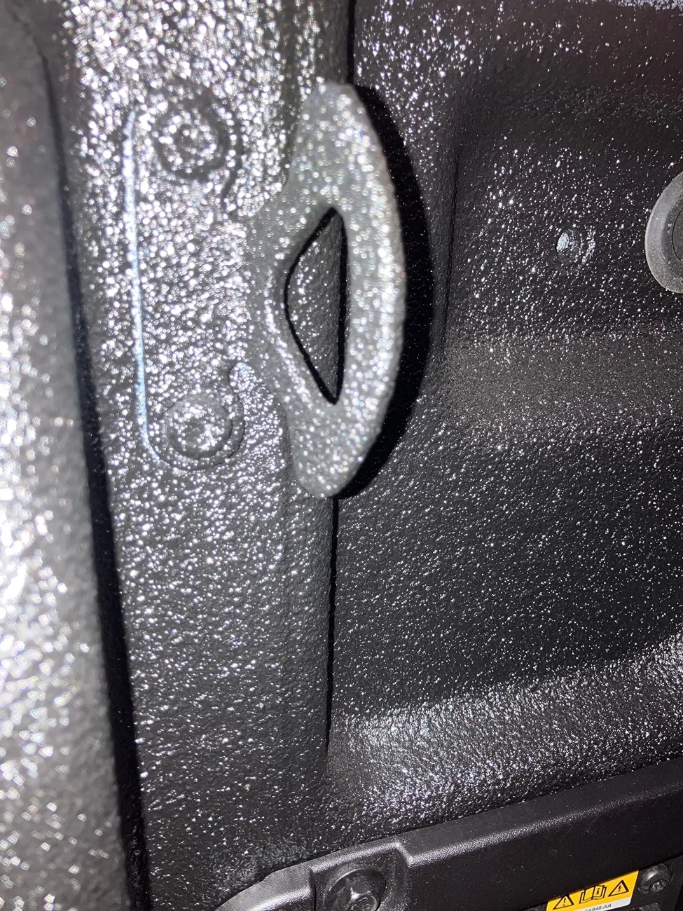

Has anyone had theMaverick’s truck bed spray lined?
If so did the store remove the tie down brackets before spraying?
we had ours done and they did not.
So when we went out and got a truck cover which utilize those tie downs by removing the tie down bracket, adding the truck cover bracket on top and resecuring to the truck, is when we actually noticed it.
so most likely trying to remove those brackets now will ruin the look and integrity of that lining and most likely strip the bolt trying to remove it.
the store said they don’t remove those brackets anymore because they had problems getting them back on.
I call BS on that. If so they could have taped around it like you do before painting.

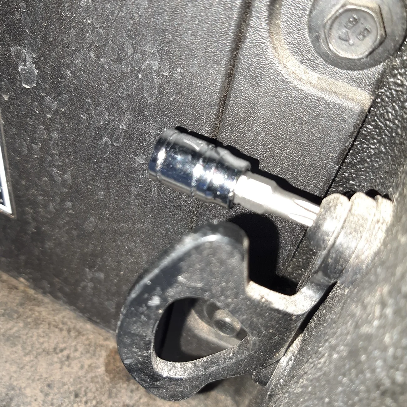

I agree that should have been went over with the customer. You’re not really screwed they can still be removed it’s just some extra work now. Razor knife around the bottom of the tie down and then clean out the bolt head really good before you try to remove the bolt. Those are a T-30 socket.

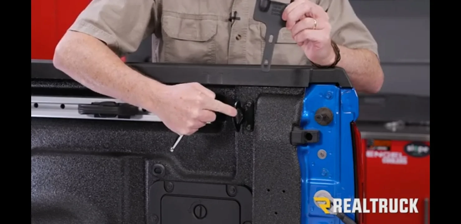

Thank you for the reply, that helped
I was having a hard time visualizing what needed to be attached underneath the truck's tie down cleat. I watched the install video for your bed cover. I understand the problem better.
Ford Maverick Spray Lining Truck Bed / pics attached Screenshot_20260803-072753_YouTu
You may try contacting real truck and see if they have any options. Other than a different style bed cover. I don't see much help there.🤷‍♂️

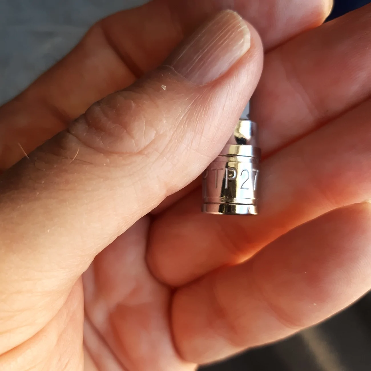

The instructions say a 30 Torx.
in reality it's a 27 Torx Plus.
A 30 Torx with the sharp edges of the bit may work better with the spray material filling the bolt head.
Good luck
