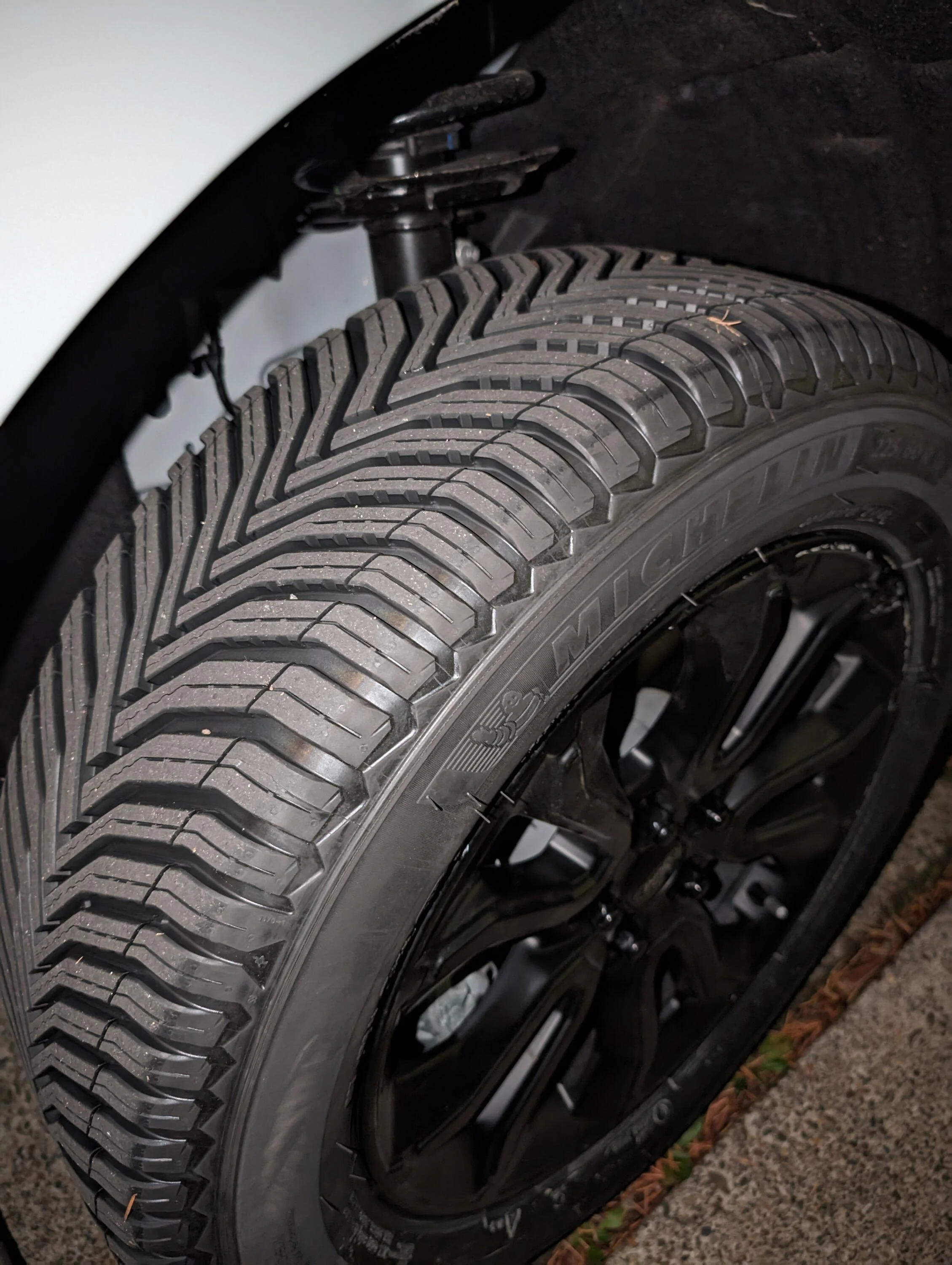

I went with the Michelin CrossClimate 2. They excell at everything if you stay on the pavement.
Always a great choice. Curious to hear how the tires perform for over time! Thanks for sharing!
