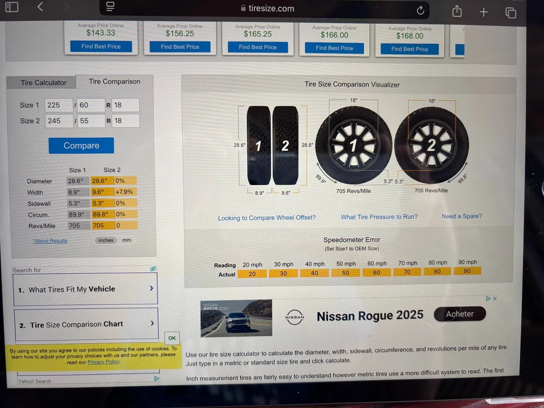

Something didn’t sit right with me when I saw your reply. I’m normally very detail oriented so for me to miss the tire size by that much had me concerned. As I was walking past the truck just now I realized I went with 245/55/18. ( I had originally said 245/60/18) at which point your numbers are accurate, however with the correct size now mentioned I will re-iterate my original claim. Exact same outer diameter. ;-).

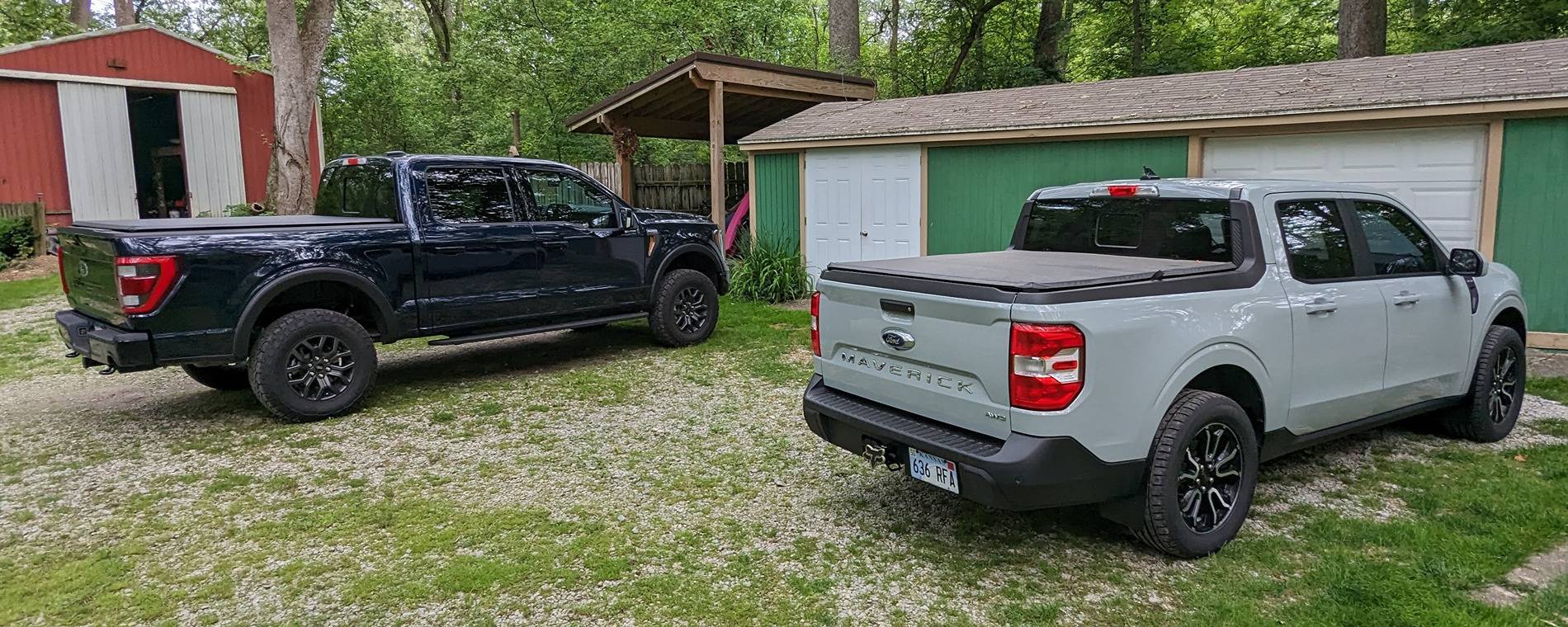

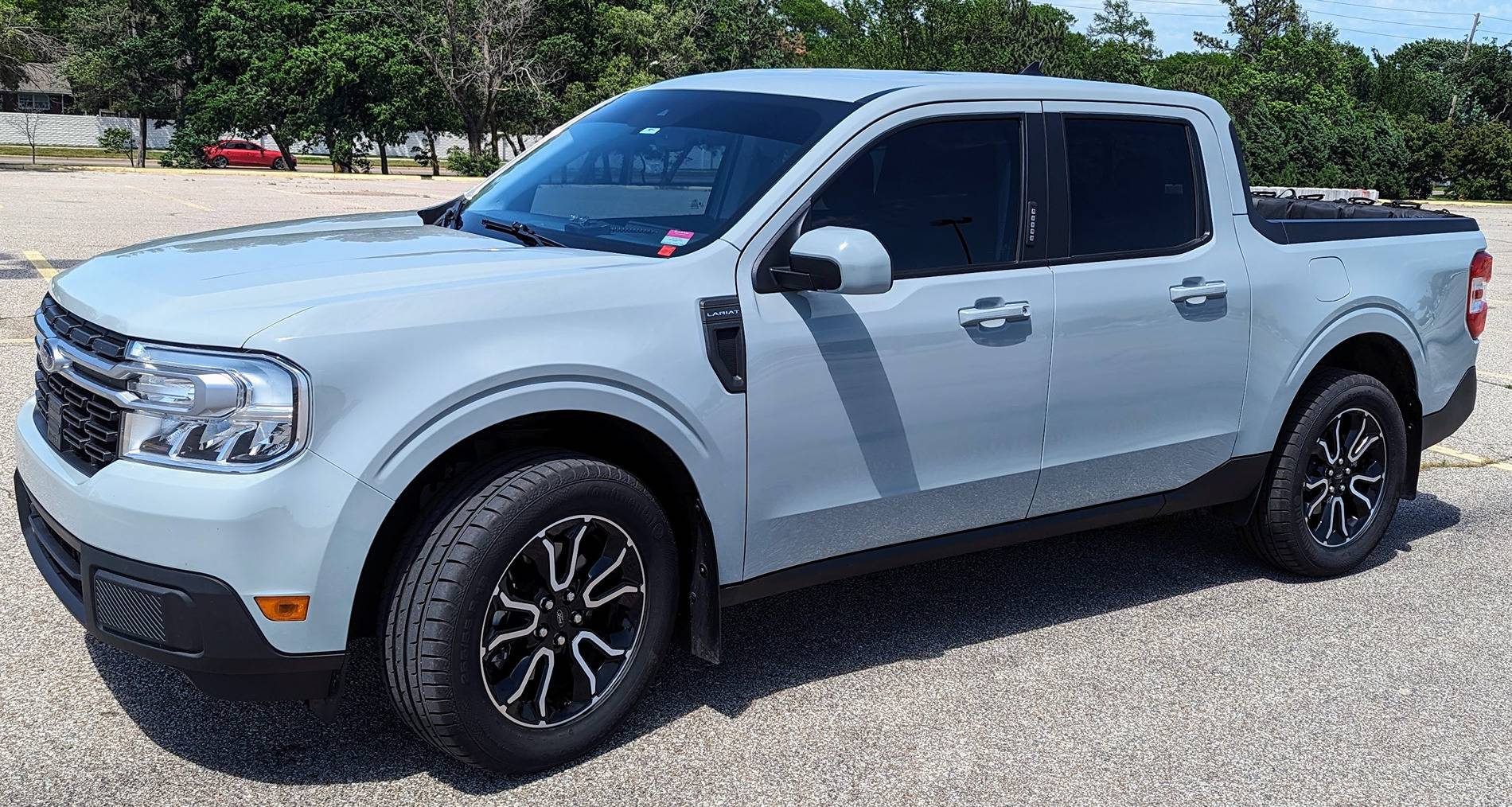

255/55-18 looks like this with stock suspension. this tire height is the same as 235/65-17, and it's probably the tallest you can run safely on the various lowering spring options. (eibach, h&r, goodwin all similar drop.)
