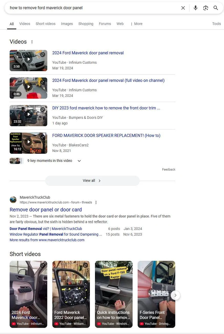

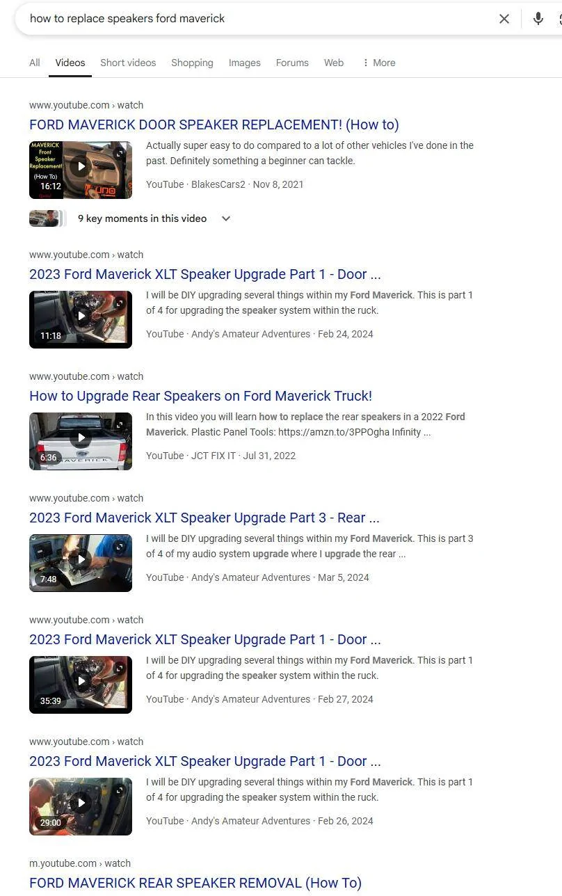

I want to upgrade the factory speakers in my new Maverick. I have no issues selecting the speakers I want, but what I do have an issue with is I have no Idea how to remove the door panels to change the door panel speakers nor the dash to replace the dash mounted speakers. Are there any how-to guides or videos showing step-by-step how to do this? I've been unable to find any help with general Google searches. I've even considered having the dealer do the door panel and dash panel remove and re-install, but I know that's going to cost major moolah.

Here's the sub forum for electronics that includes numerous posts on speaker installs. Do also consider purchasing from Crutchfield, as their prices are competitive and they give you all of the Maverick-specific installation notes that you will need.
That's what I did. Both searched the sub and bought from them.

Yeah there's quite a few videos on YouTubel. I Believe crutchfield also shows you, the only ones that are a pain in the butt are the rear speakers. As the metal clips on the top of the plastic panel or a pain to get out I found it easiest using a metal panel pry tool as well as a long flat screwdriver.
