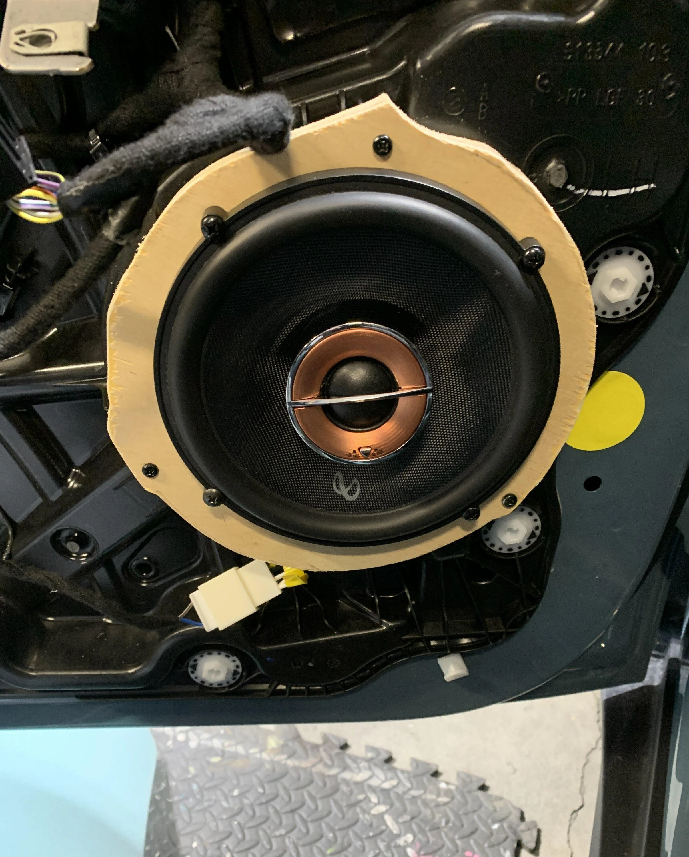

Any photos of those installed? What did you have to do for spacers? I actually have an extra set of those same speakers, and was trying to decide between using them or going to components. I had them in a previous vehicle, but they seemed to lack the midbass punch I was expecting.
I made simple spacers out of birch plywood I had laying around. It was winter, so I didn't paint them or anything. 3/4" seemed a bit too thick, and 1/2" was a bit too thin. 5/8" would be ideal. Just trace the OE bracket. Don't stray too much, or the door panel will not fit correctly. It's ugly, but it's not seen behind the panel. I did wrap CCF around the harness prior to buttoning it up.
