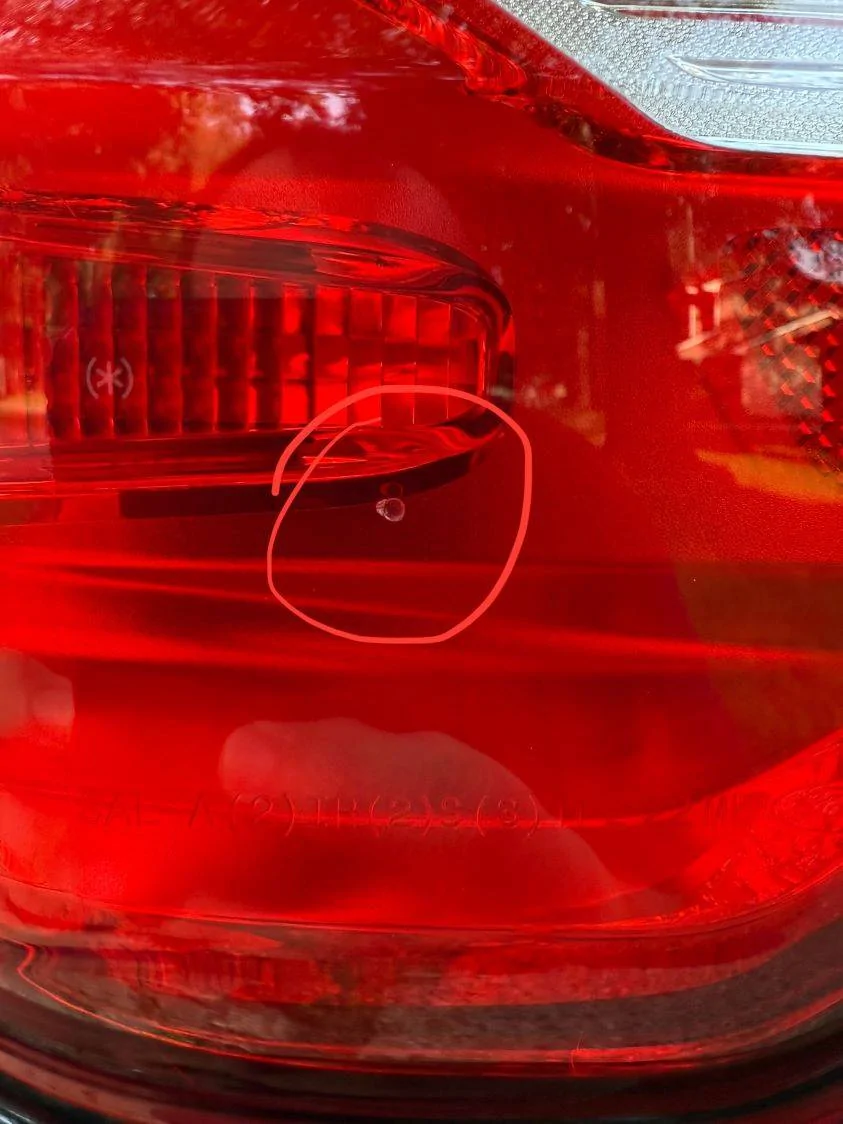

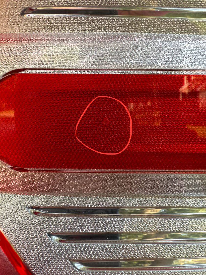

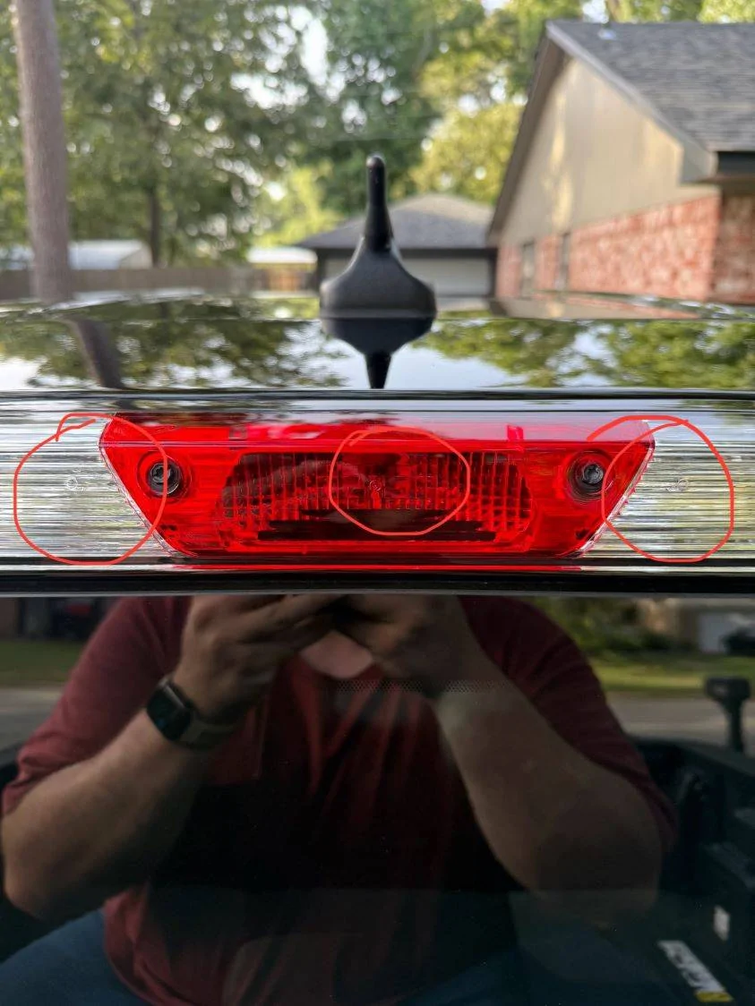

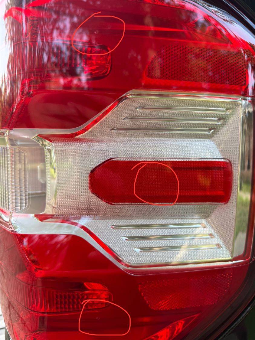

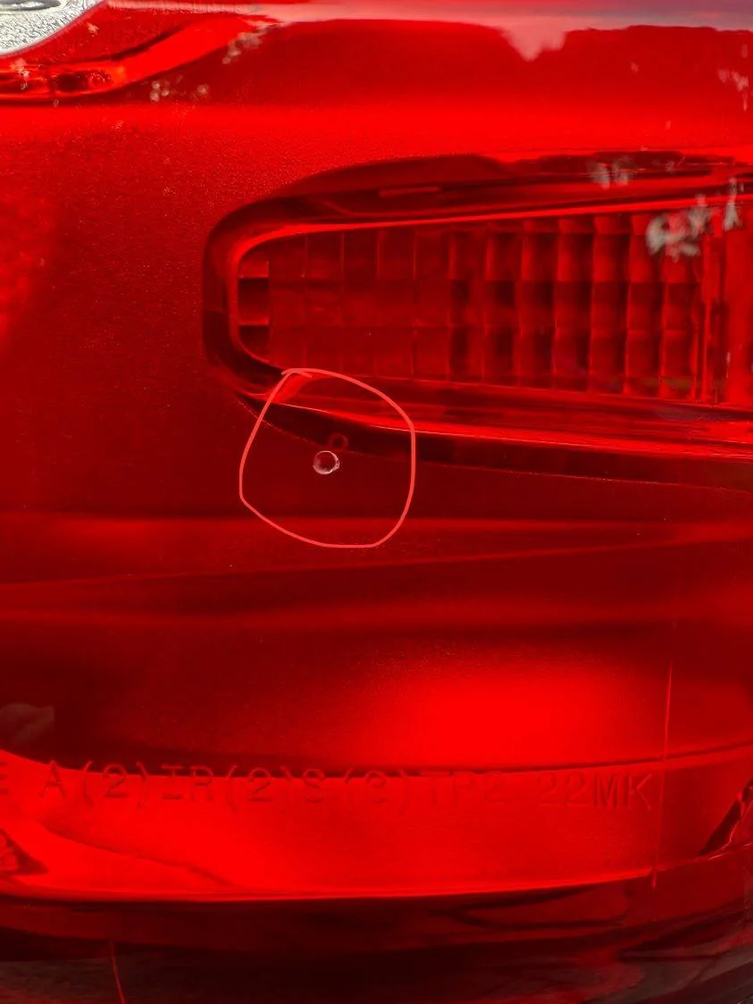

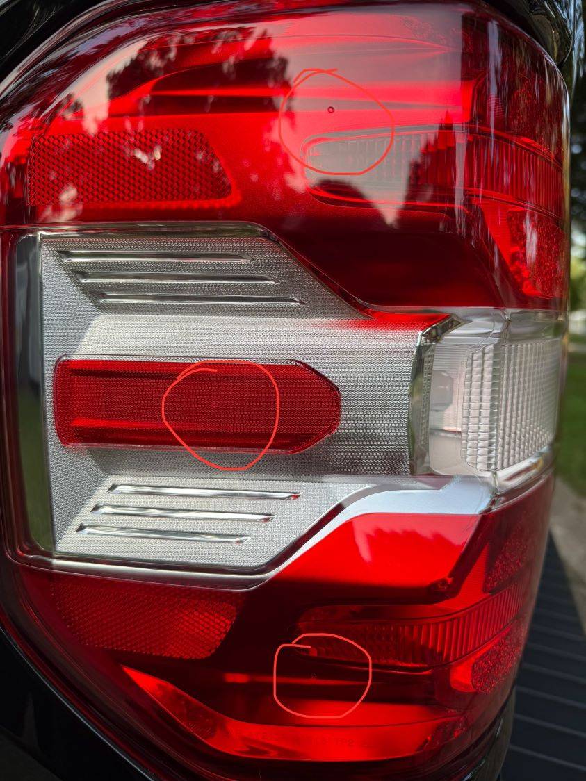

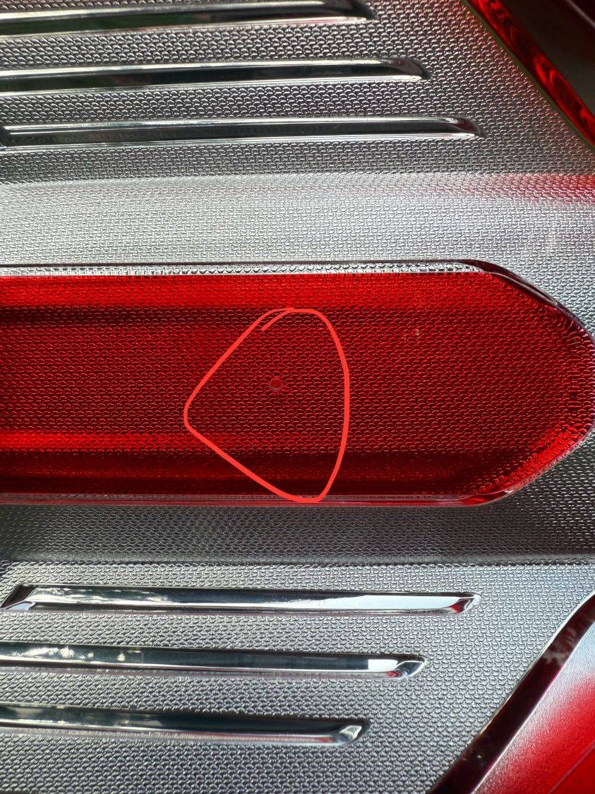

OK, molding experts. Why no similar marks on the headlights?
The headlights are one shot, so they can hide the injection gate on the edge of the lens (not visible when installed). The tails are two colors that are probably injected in stages. You can't hide a gate on a overmold like that.

Here's the story. I noticed some small circular depressions on the tail lights of my Accord the other day. They're maybe 1/8" in diameter and feel like a little crater in the plastic when I run my fingers over them, almost like someone started to drill some holes through it. There are multiple on each light housing/assembly, my initial impression was that someone had shot it with a BB gun. I found the same thing on the tail lights of 3 of the 4 cars in my driveway, an Accord, Focus, and my Maverick. I also found them on the Mavericks 3rd brake light. I googled it and couldn't find anything on it. All of the "damage" is on the rear light housings, I found none on the head lights. All of my cars were parked front-in, rear ends towards the street. Upon further investigation they appear to be symmetrical, in roughly the same spot on each side of the vehicles.
The question: Is this some sort of normal product of the manufacturing process, does anyone else have this on their mavs, or have I been vandalized with extreme accuracy?

High quality produced molding, either glass or impact resistant plastic not like that they use on the rest of the car doesn’t produce gas bubbles or has pinpoints for injection
All plastics all moldings are not made the same. Some are cheaper cause they just cover up bulbs and if they crack or fog, it’s probably within the warranty. Headlights are government controlled.
Most likely along the edges
