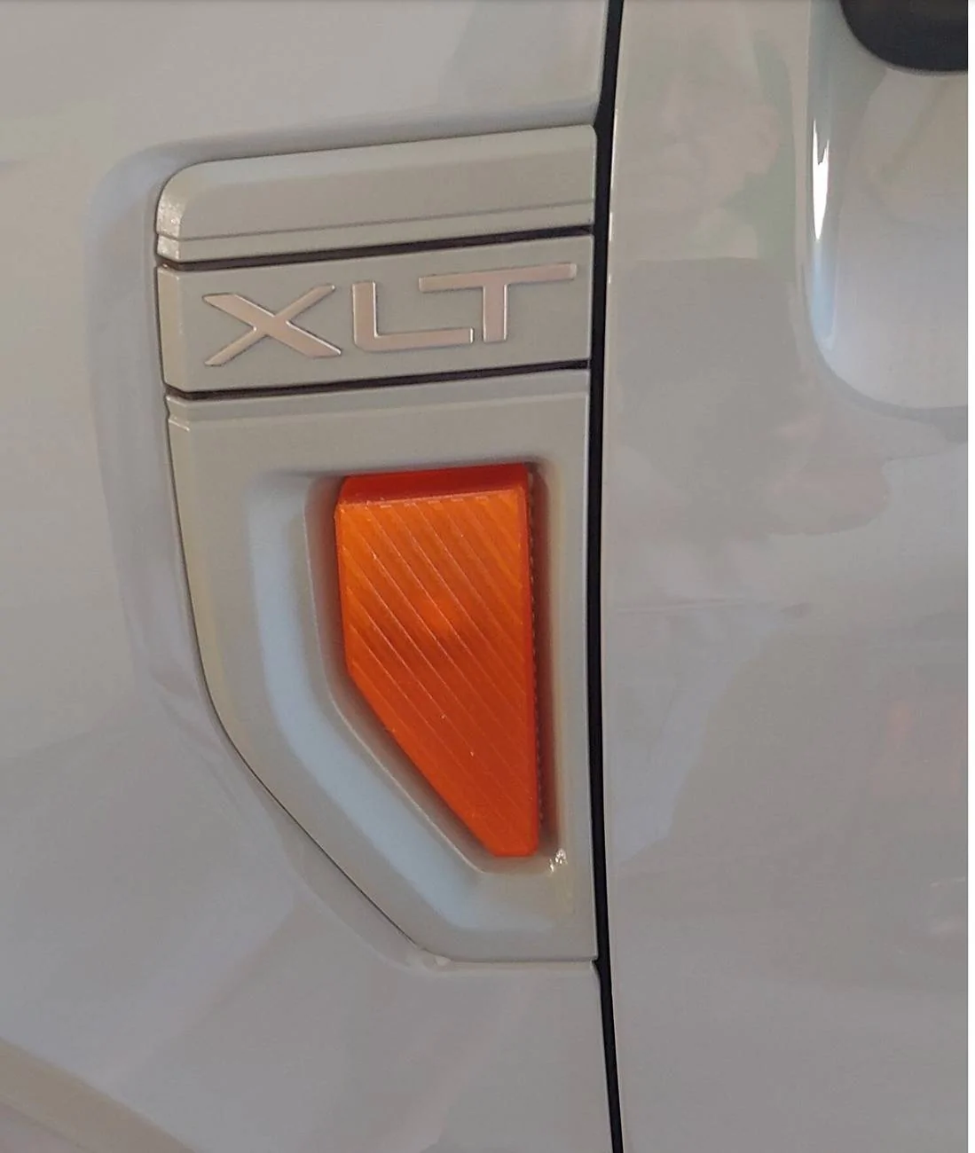

Turned out pretty good. Now just waiting for my turn signal adapters to arrive.

Looks really nice Todd I ordered the lense covers from GadCAD 3D so I’m waiting on them and have been follow your progress. Thank you for providing the wiring adapter info I think I missed the link for the actual LED fixtures but will see if I can go back and find them. I hope you will provide some pics and info on the actual wiring when you get too that point - I appreciate all your updates

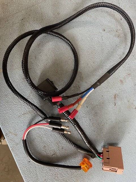

Next installment: I started my assembly today and managed to get three pix. I would have taken more but it's difficult to take pix and solder at the same time.

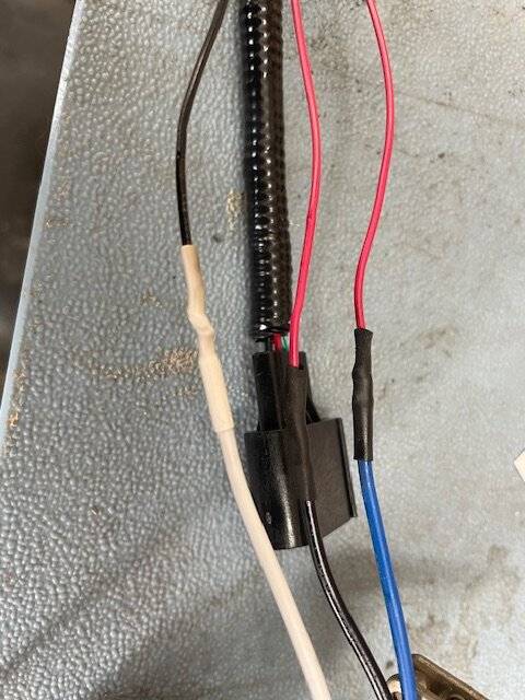

My plug n play setup came w/ the wires for the side markers labeled; by hand w/ a Sharpie, but that's ok w/ me. I had, on hand three lengths of wire on hand that could be cut in half for this project. Black, white, and blue is what I had so black, white, and blue is what I used. (If I did this again I'd use black, white, and red to match the LEDs) Most of it'll be covered anyway and I'll color code the ends so the wire color isn't terribly important. To make it more confusing the Ground wire out of the plugs is black but the Ground for the LEDs is white. I decided to do the wire color switch and hide it under the wire wrap. When doing this for yourself you can solder or crinp or even crimp and solder. I like to solder and then cover w/ heat shrink tubing as shown below.

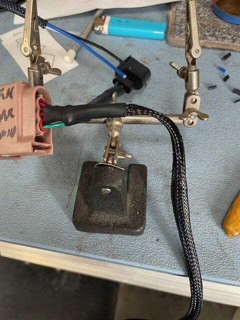

Once the wire extensions were soldered and heat shrink covered I slid them into the wire loom stuff. It's pretty much like what they use to call a Chinese Finger Puzzle; push it together to open it up and then slide the wires in until it's all covered. When you cut a length of the wrap you need to seal then ends a bit w/ heat, otherwise the stuff WILL unravel. I use a lighter. Like I said above, there's a bit of a learning curve to the stuff but it's not rocket science, play around w/ it a little and you'll figure it out. I slide the end of the loom material into a bit of heat shrink tubing to secure the ends. You can just use a small zip tie to do this as well. If you look close you'll see that for this one I used both; zip tie first then heat shrink over both.
