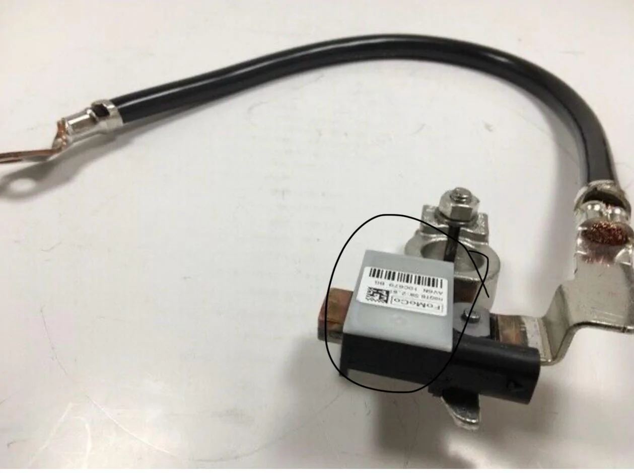

I don‘t Know if the hybrid has a negative battery wire like in picture but some of these can go bad quickly into their lifecycle. If optima batteries or similar have a battery for Mav hybrid I’d be willing to try one of those.
Ford Maverick So they say it's my battery, again. But is it? IMG_2955

I wonder if some have faulty BMS's ? https://parts.lakelandford.com/p/Fo...OR-MANAGEMENT-Cable/91077050/LX6Z10C679B.html
If a battery recharge along with a BMS reset does not fix it, perhaps the BMS sensor is faulty and providing incorrect readings etc ? Who knows. As long as it functions, I don't think any codes would show up ? I know we have a warranty and no one will throw parts at it because everyone relies on DTC's. If your BMS falsely reports SOC, then I could see the issues you are having.
