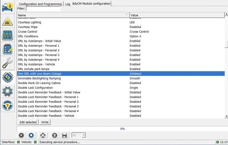

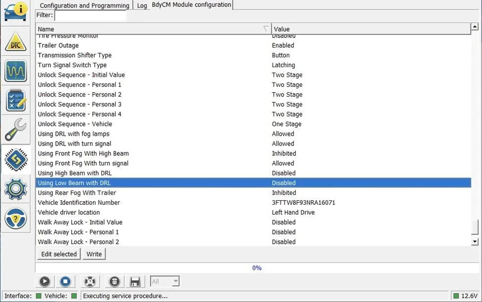

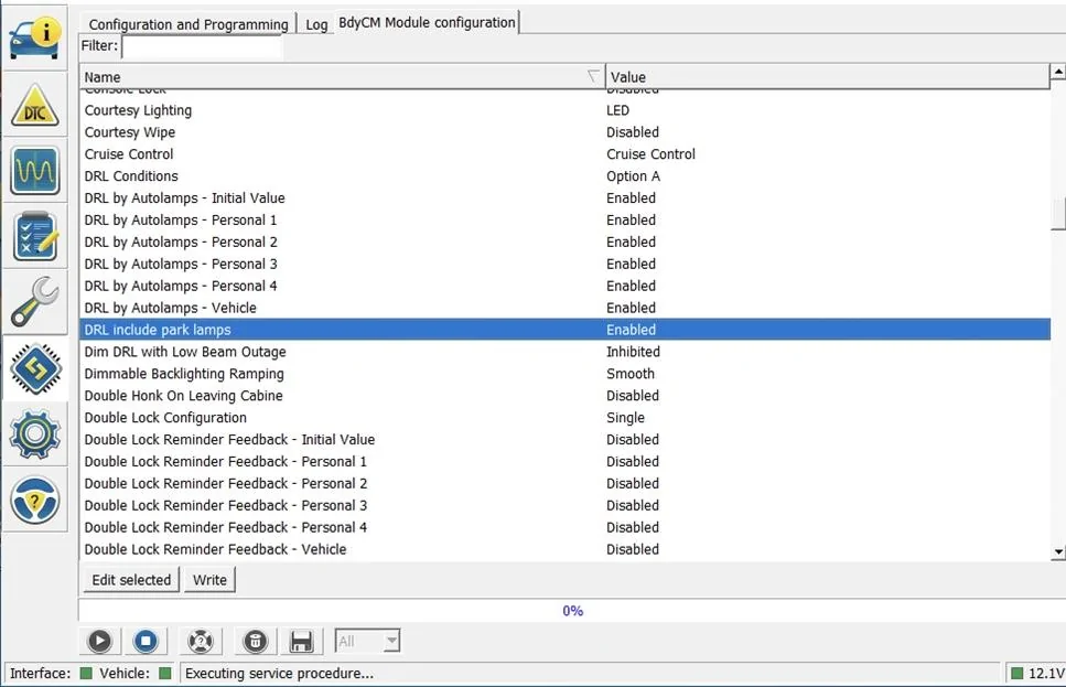

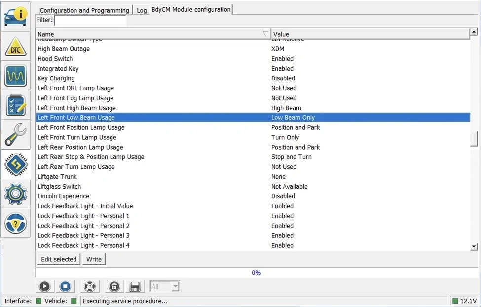

For Daylight Running Lamps (DRL), here’s what I ended up configuring my XL inside the BdyCM (Body Control Module). I used the easy mode .
DRL include park lamps = Enable
Dim DRL with Low Beam Outage = Inhibited
Left Front Low Beam Usage = Low Beam Only
Right Front Low Beam Usage = Low Beam Only
Using Low Beam with DRL = Disabled
My observation of the DRL lighting behavior with these settings is as follows:
Upon starting the vehicle, the light switch position defaults to Auto. Moving the transmission selector from Park will cause the tail lights and the front parking lights to illuminate, behaving as DRL. If night time or dim lighting, the low beam lamps will illuminate.
If the low beam lamps are off and the windshield wipers are activated, after a brief delay, the low beam lamps will illuminate.
Been running this way since the first of the year.
What’s interesting is my Canadian mav did not have autolamp by drl enabled at all, so I changed this. However the low beams are on 24/7 and no change.
