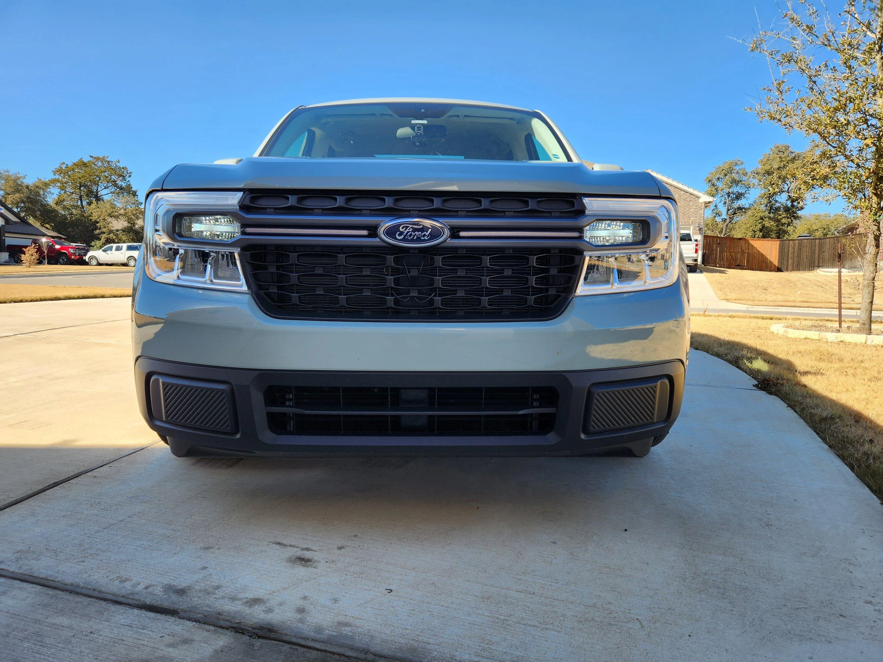

Huh? These are not bright like headlights. Will be no more bright than my new switchback LED DRLs/turn signals.
Ford Maverick Installed new DRLs on my Maverick XLT = added strip lights to front grill 20230105_121745

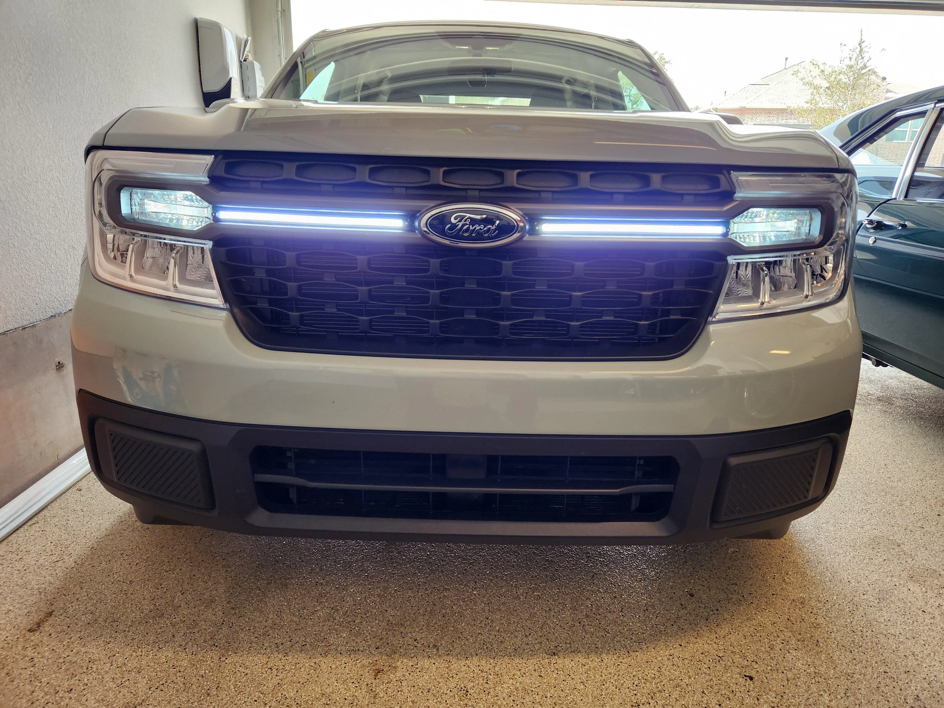

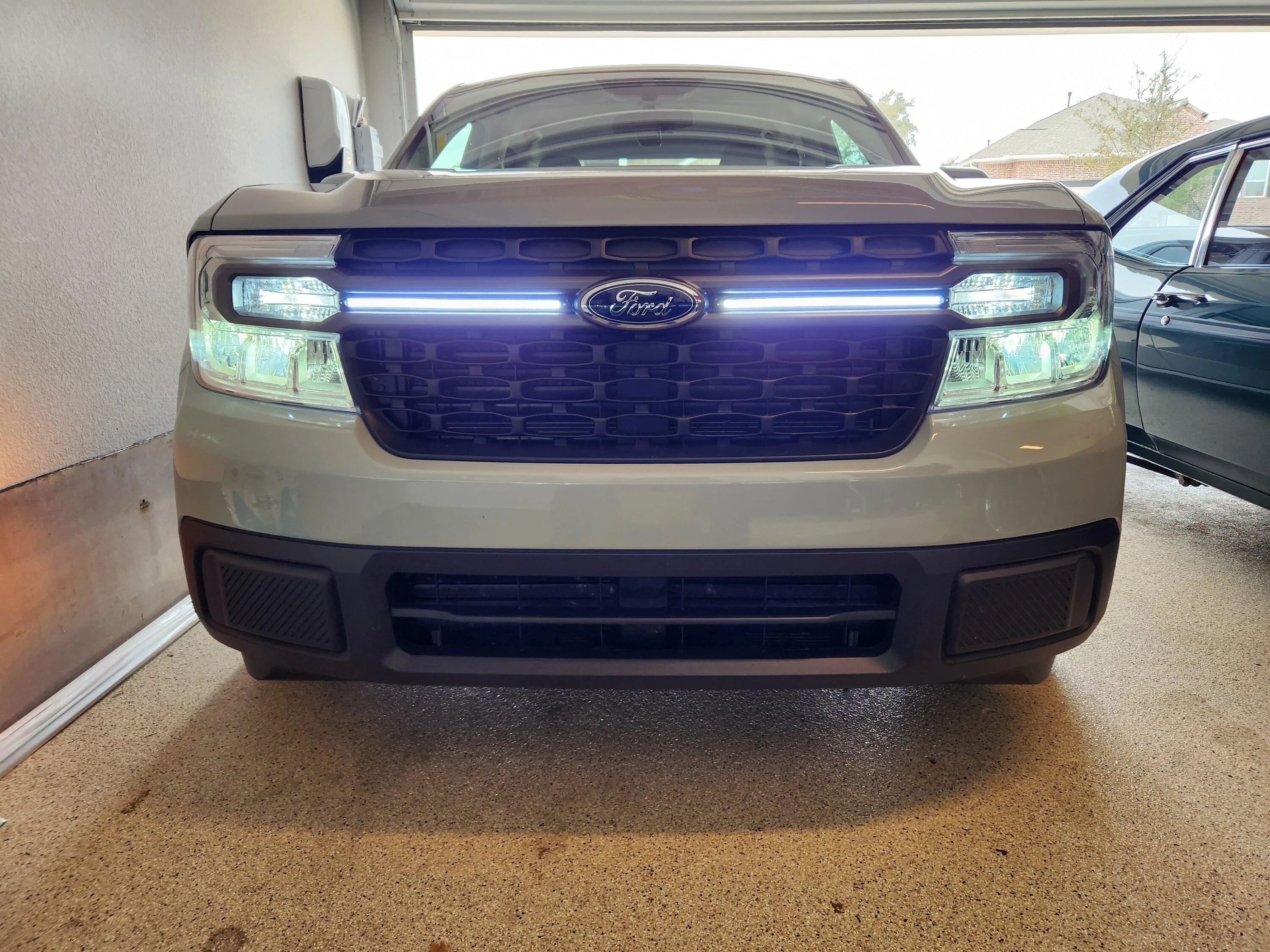

Update:
DRLs run at a lower voltage so the strip lights don't power on until I either manually turn on the parking or headlights. In Auto mode only the switchbacks are on during the day (the strip lights do operate as turn signals in Auto). The strip lights do come on with the headlights at night in Auto.
Anyone know of strips like this that will turn on at the lower voltage at which DRLs run?
