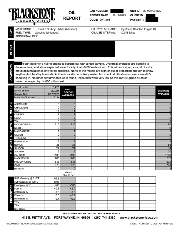

Double edge sword here.
Extreme heat=server duty
5,000 mile intervals especially in the turbo Ecoboost with full synthetic.
The Hybrid. More starts with the engine below optimal operating temperature.
Much higher rpm’s at times.
Yeah I’d do 5,000 mile intervals and full synthetic here also.
Absolutely no reason to think the hybrids run with "much higher rpm's".
I'll bet quite a lot of money the opposite is true. I have a data logger. Driving normally with the normal flow of traffic, 50/50 city / highway in a one hour trip speeds zero to 70 mph....
MY HYBRID NEVER GOES ABOVE 2400 rpm.
What does your Ecoboost hit daily?
Here was one of my more vigorous drives.

The Motor Oil Geek did a YouTube video of a lecture he gave to dozens of oil analysis professionals. At one point he asked for a show of hands of folks who’ve performed one on their personal vehicle. One hand went up:)
Although maybe it would be like admitting that you stole something from work?
Data is data.
They saw all the data.
They know 15,000 mile OCI is safe and effective for 99% of drivers in 99% of vehicles.
Funny how 50% of the population thinks they are in the 1%.
Human nature.

Yep, like Cherokee & the oil folks pros said - oil analysis on your personal vehicle is unnecessary if you maintain it properly.
Although I am going to do a first in a lifetime oil analysis on any vehicle soon. There is a TSB on my EB Mav build date for oil dilution & my oil cap smells very gassy. So I want to have data before/if I bring my truck in for service. One of your posts on oil analysis (that I originally mocked) inspired me to get one done:)
