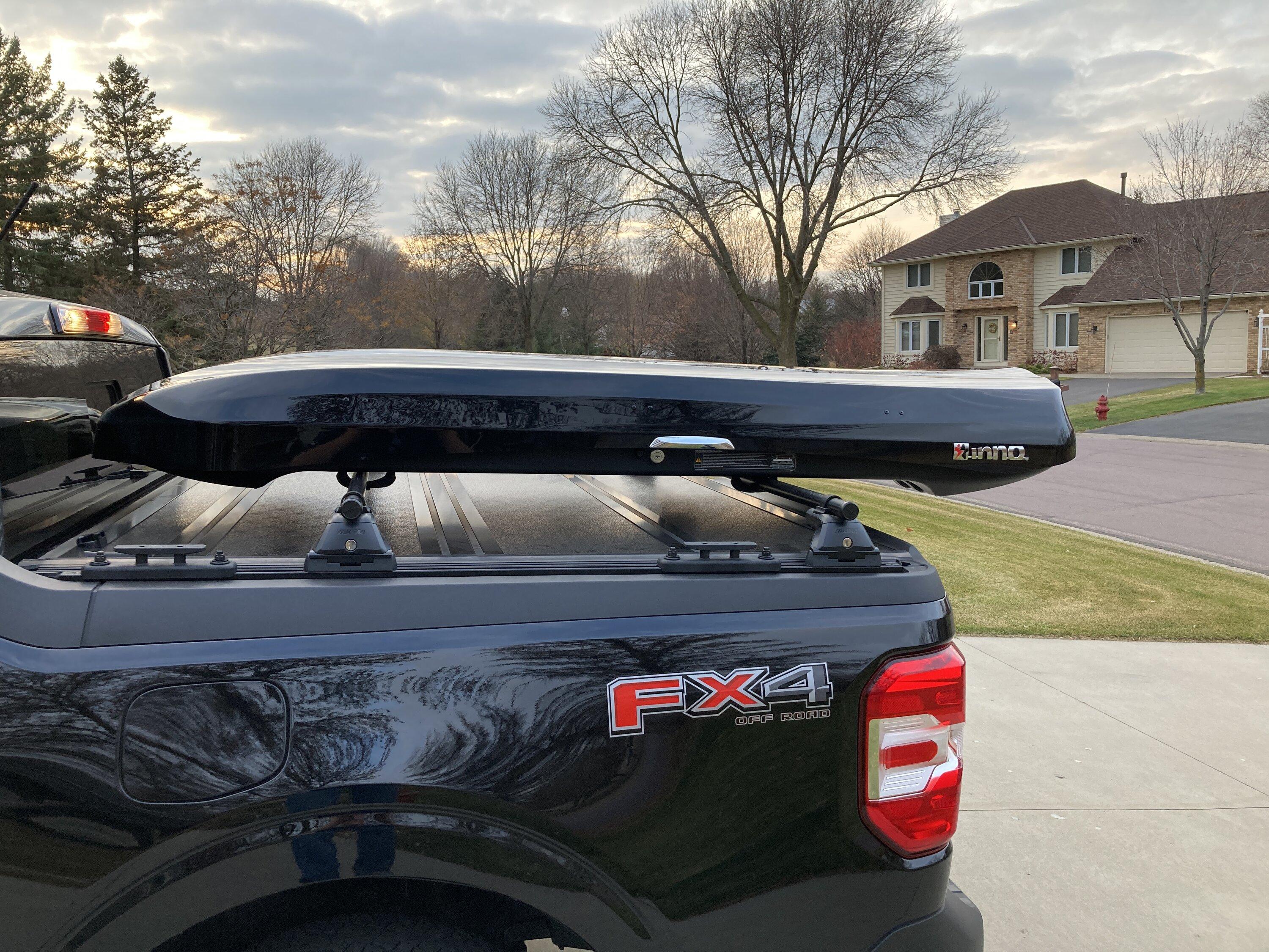

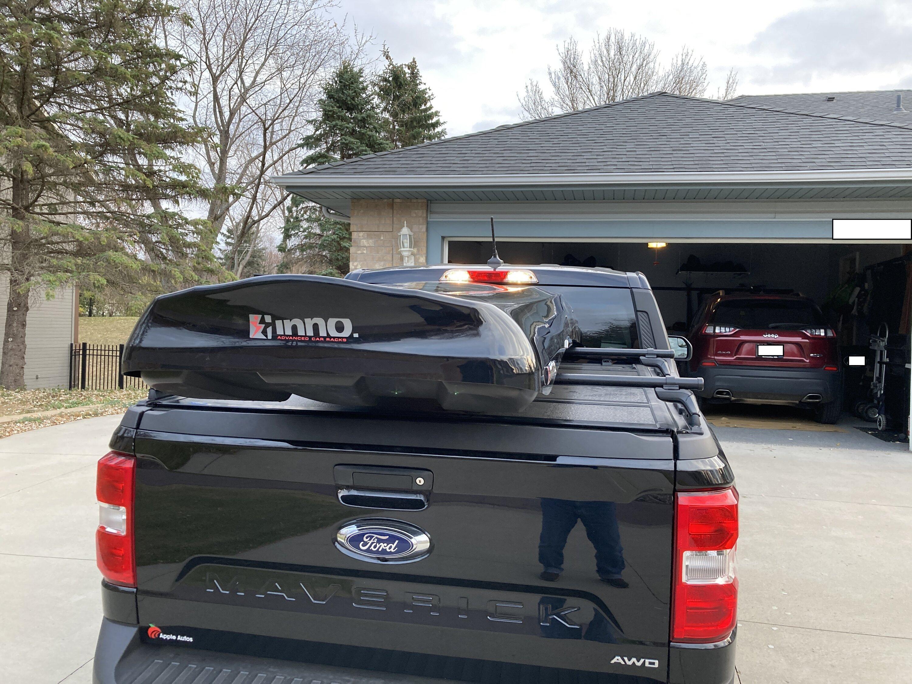

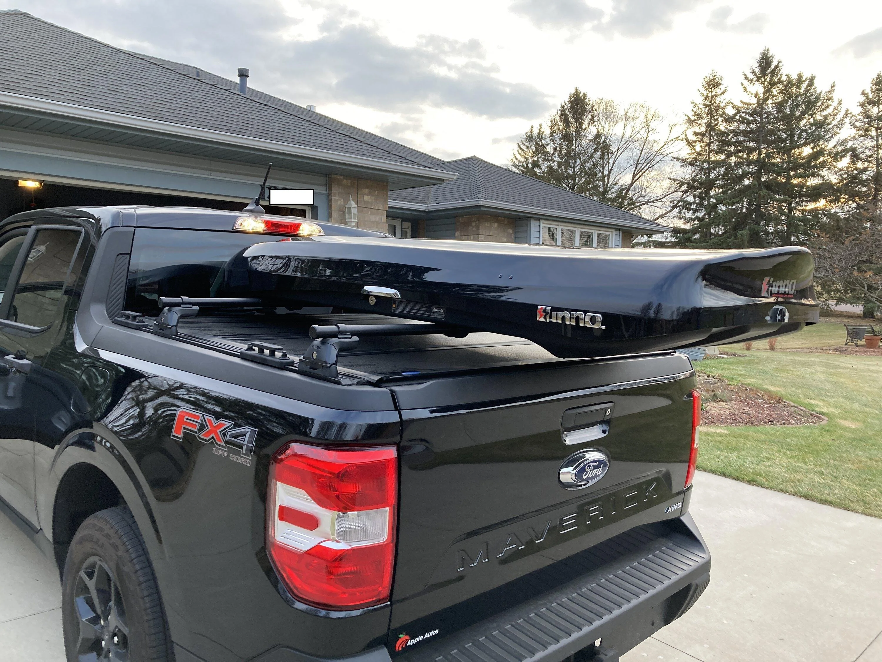

I needed a solution for skis so the bars are getting a cargo box, skis beyond 170cm will not fit in the box even diagonally.

Like the setup and am thinking of something similar (hope to get my Mav in May!) as we already have a Skybox 16 and caps are way too much $$$
Question for ya - do you think a hard roll-up like the Sentry CT would be able to roll up with the racks and box in place?
A full soft roll-up cover shouldn't be an issue - and maybe that's a good way to go as the box over the bed can provide some "security" - as in it'll be hard to cut the cover and remove large objects quickly...

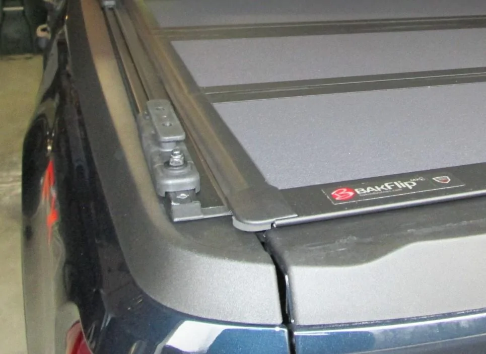

In my case, I self-installed my MX4, but you are correct, the TS rails go on first, then the rails for the cover on top of them, with the same clamps holding both in place. My truck is stored off-site right now, but this weekend I could take more pics if they would help.

Yes I had to remove the tonneau rails first, then lay the TS rails down, and then the tonneau rails go back in. The clamps for the tonneau rails hold it all together; I did not use the clamps included with the TS rails.
I did not notice any fitment issues after reinstalling the tonneau.

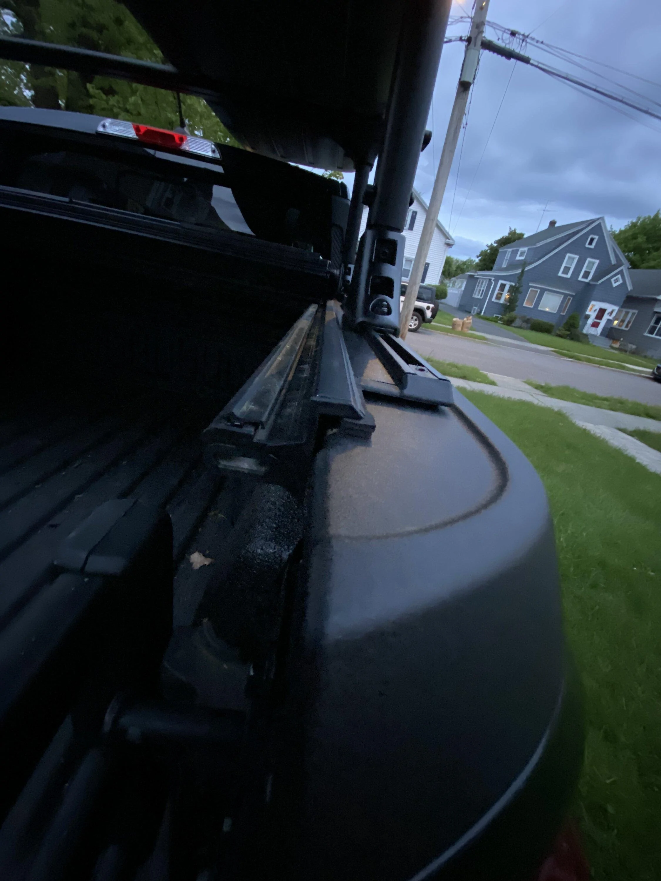

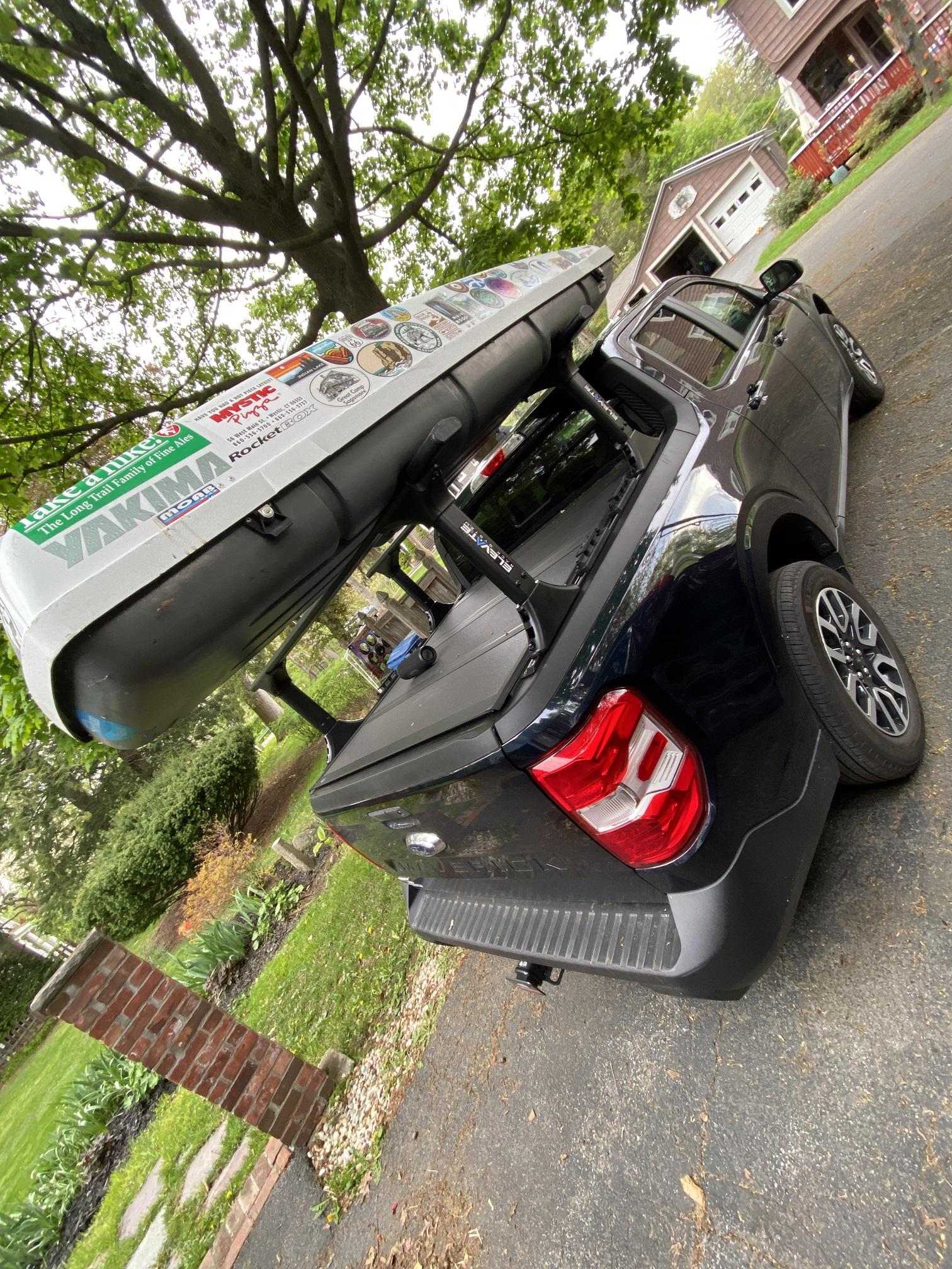

I did it! Installed the Truxedo TS rails and rack. The rails required me to remove the tonneau cover which was not as challenging as I anticipated. Since everything fit flush and I'm not concerned about water intrusion I neglected to install the 3m tape... we'll see how things hold up and if i need to come back to it I will. Everything buttoned back up real nice and there was plenty of tolerance on the BAX MX4 folding rack for it to operate just as good as without the TS rails. I proceeded and it took about an hour to secure the rack arms and cleats. I did not notice any flex - I think the hard tonneau and crossbars likely add stability. My rack came with extra 3/4" mounts, which I used for my Yakima box - I just drilled 3/4" holes, pulled the mounts through and used lock nuts and washers. It was easier to have 4x lock nuts that 8x Yakima thumb wheels over the U clamps that kept falling out - so even the Yakima mount is an improvement! I'm also happy in it's lowest setting the rack allows the roof box to be mounted with clearance over the cab.
My gripes, which are small:
1) The width of the crossbars that are going to require ingenuity to mount Yakima accessories I collected over the years.
2) The trifold can only fold two deep with the rack in the lowest position
3) There's a "hi" and "lo" setting which take a bit of time and effort to raise/lower. Got to be a better way than 8x bolts!
4) If there was a middle setting It would allow a height that permitted the trifold to fold all the way back.
I called a lot of dealers, companies and did a lot of research. If you've got a hard trifold like the BAK MX4 and a small truck like the Maverick, I'm pretty sure the Truxedo rails are your only option for a functional hard trifold AND a roof rails.

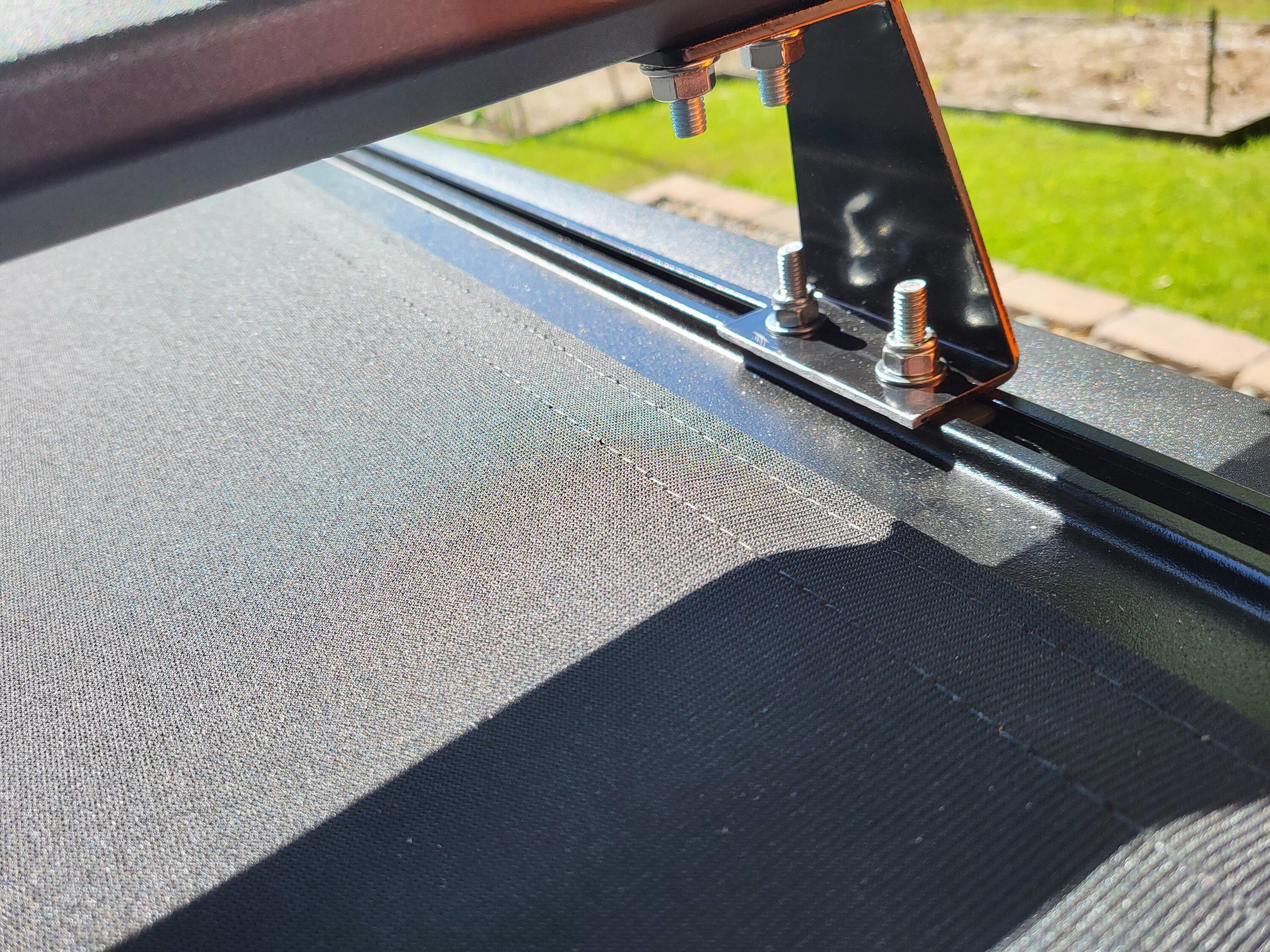

Wanted to give thanks to @Daverick , for posting his low profile rack solution.
Those photos got me started down a similar path. I found a set of cheap low profile bars on Amazon, which I modified to fit Elevate T-Slot rails.

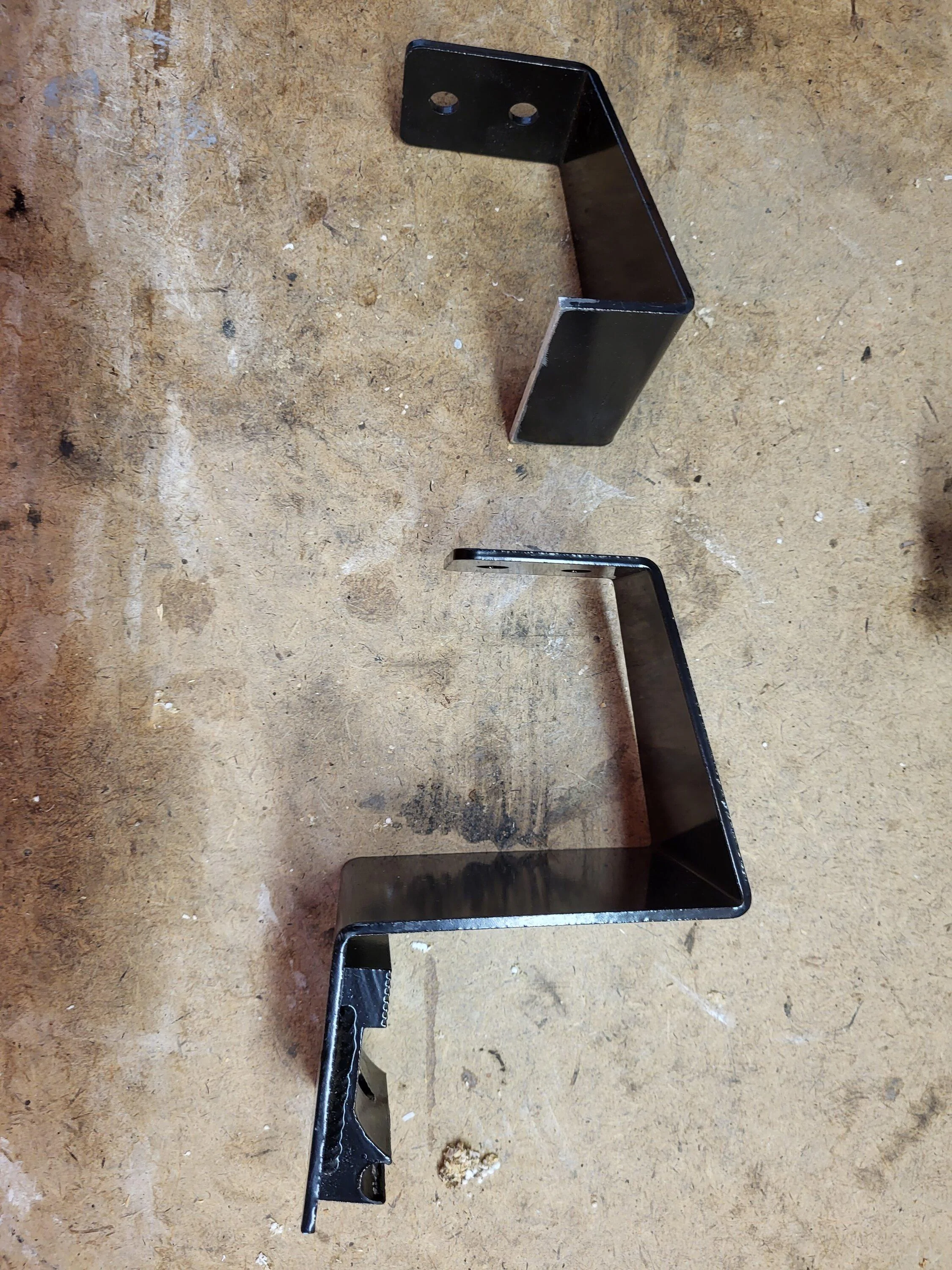

The modified bracket is shown at top and the original at bottom of this photo.
