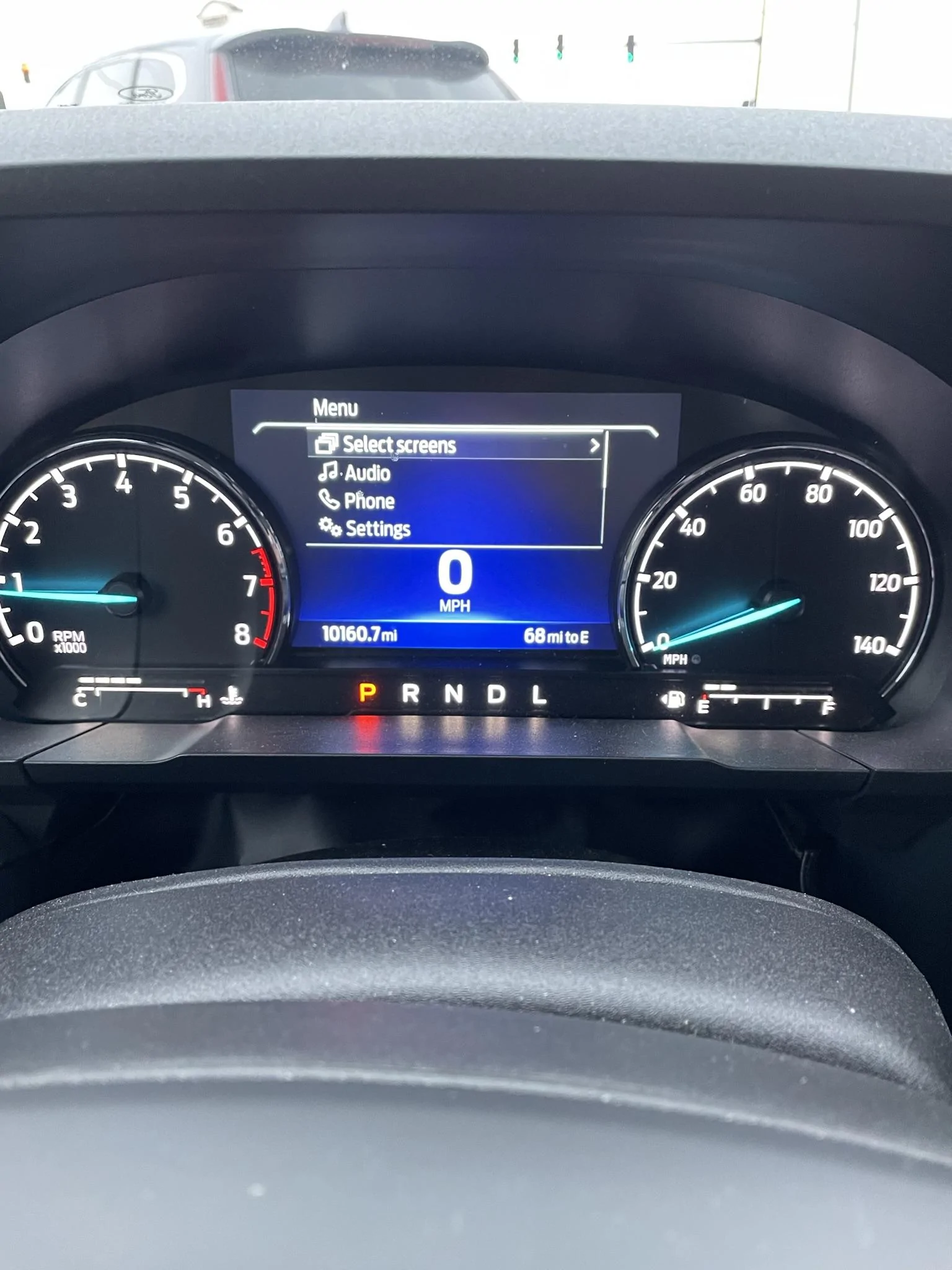

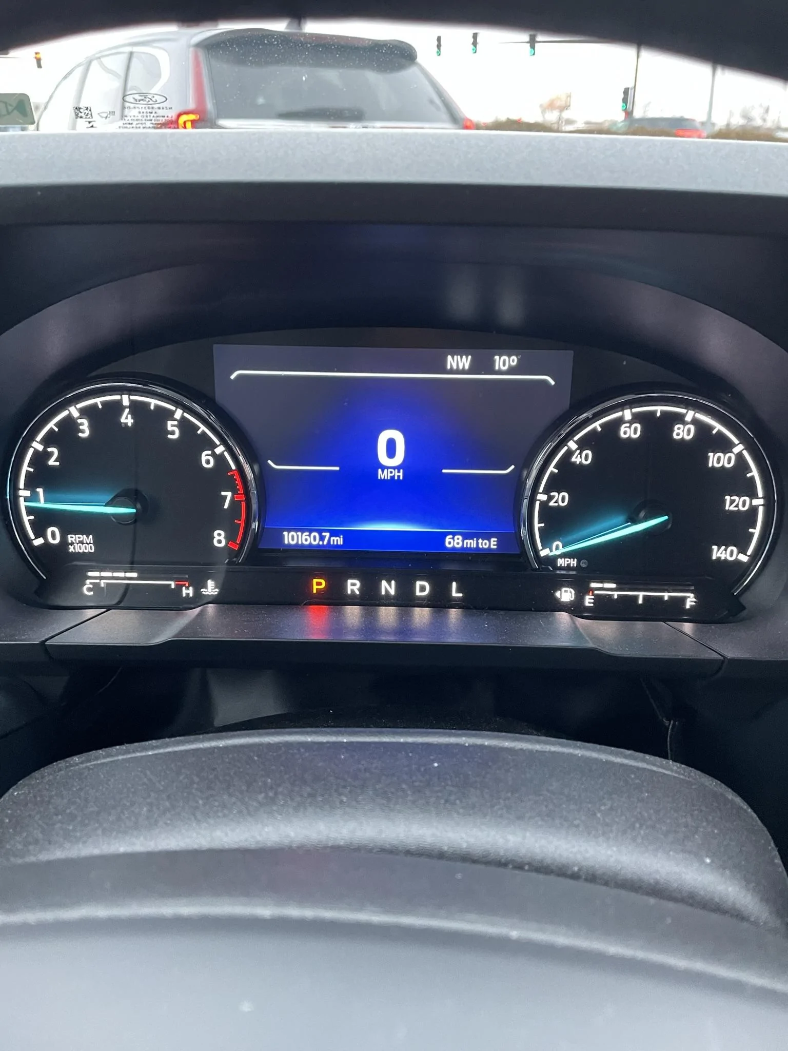

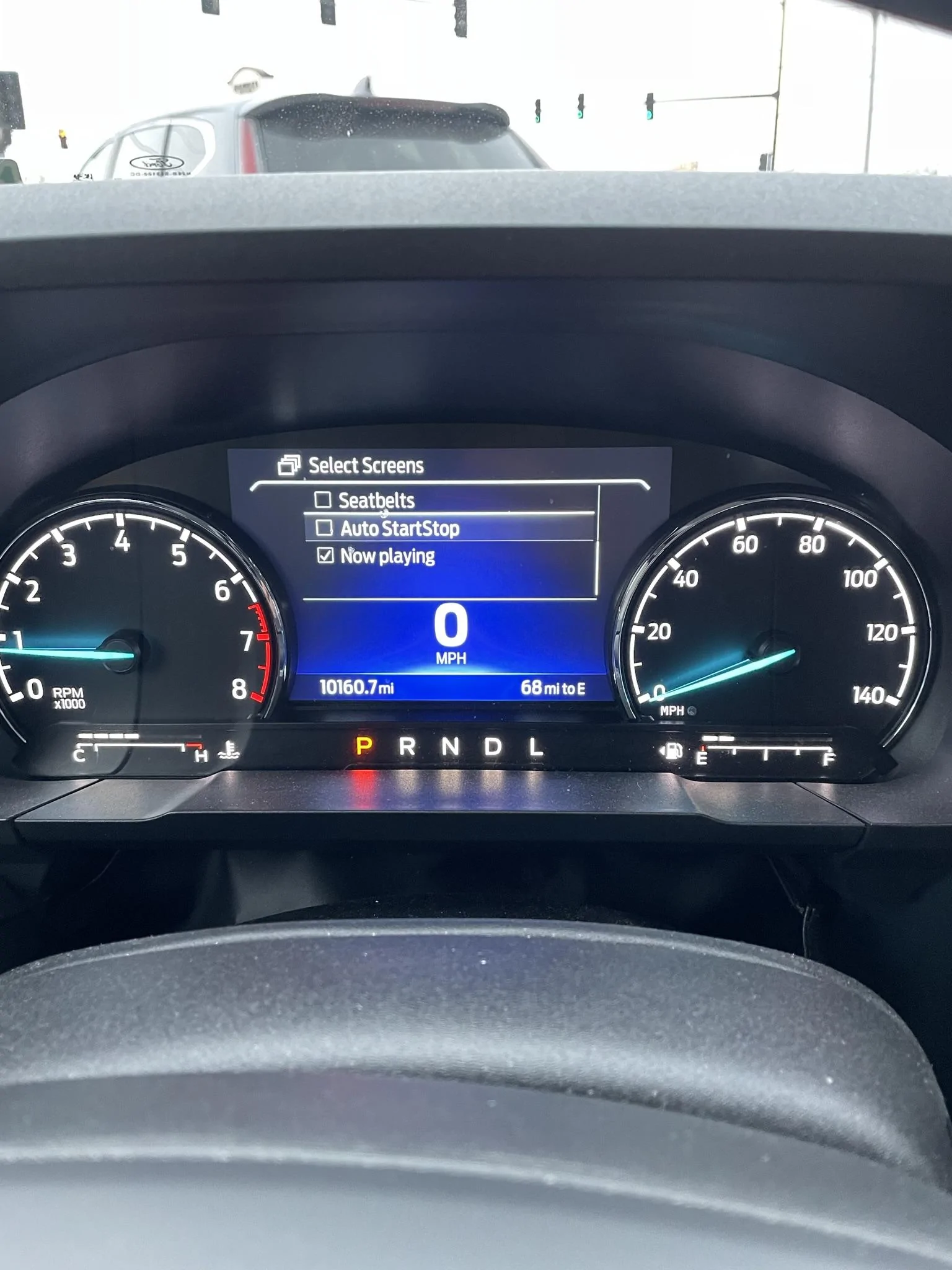

Here’s how I did mine… select menu, then select screens, and then uncheck seatbelts….. it’s simple.

^ Hummm - I don't think the standard (nasic) dash has those settings? I'll have to go play with it.

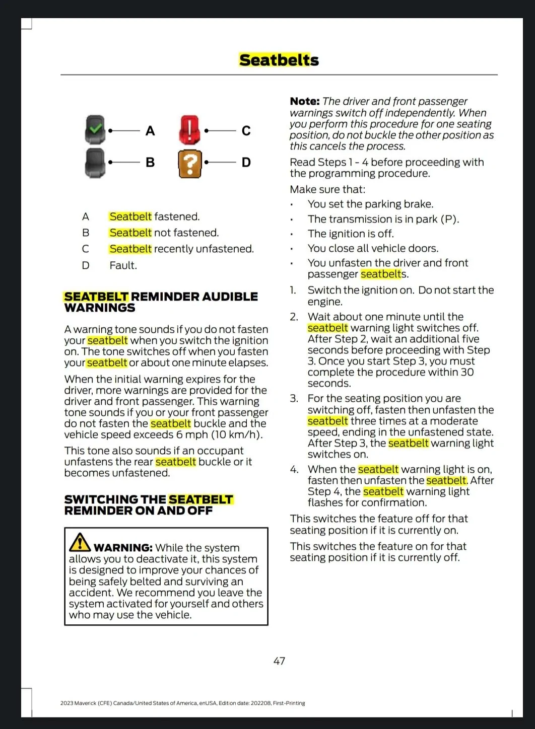

The stupid screen in between the gauges that comes up EVERY time I start my Tremor is SOOOO Annoying. I can't find where or how to turn it off. I've seen the chime removal in the Manual, but can't find anything for this screen.
Cumbersome process, but here's whats in the 2023 manual.

The seatbelt screen is unchecked, have done the long process in manual, 6.5” screen. The box is still there, the manual process did eliminate the chime. Still have to press OK.
