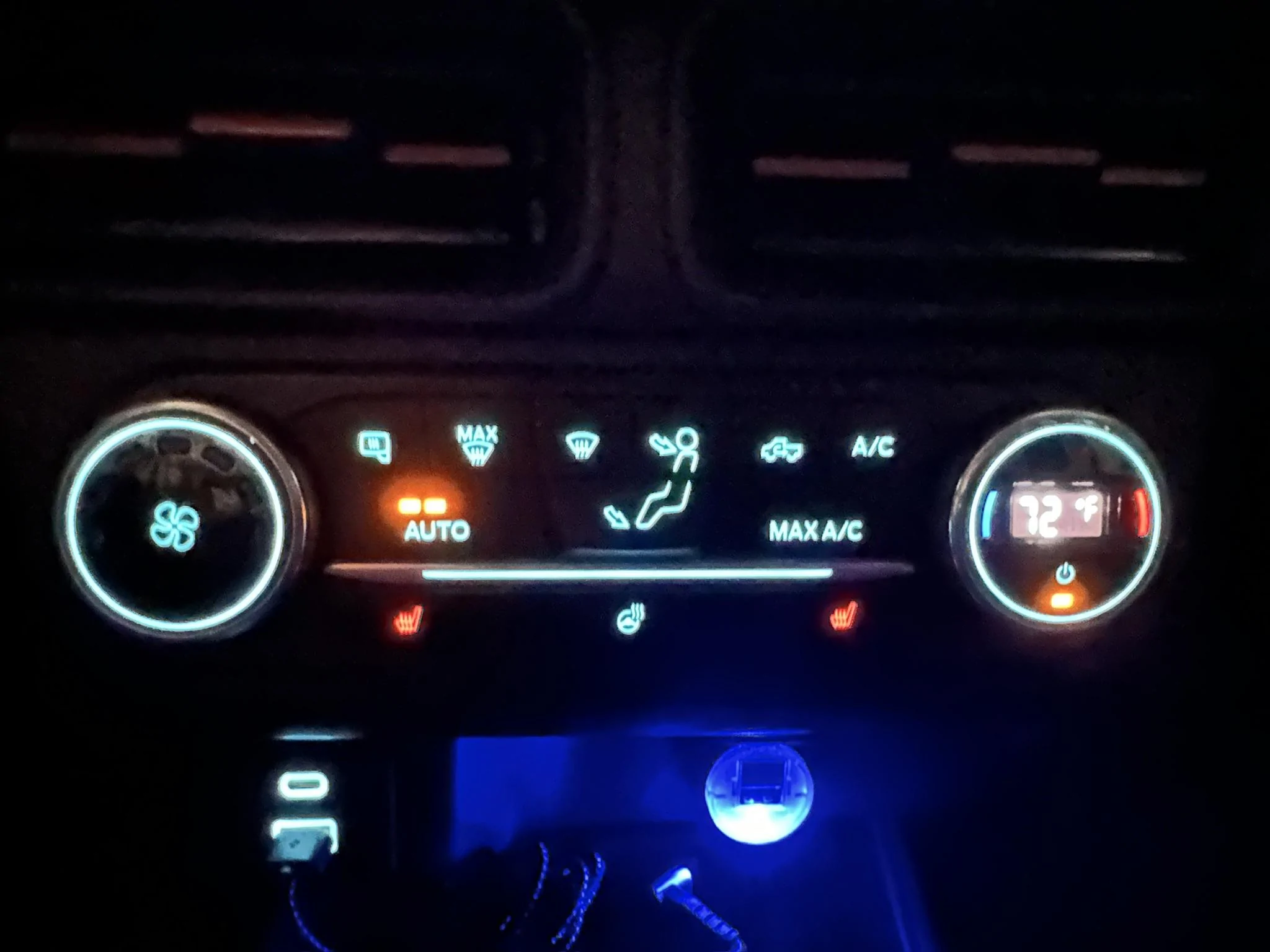

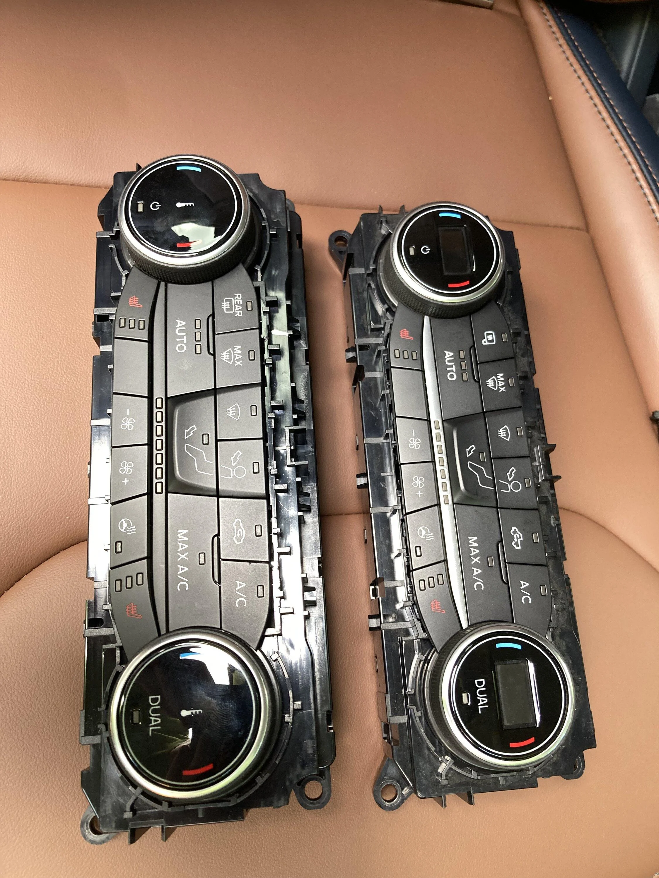

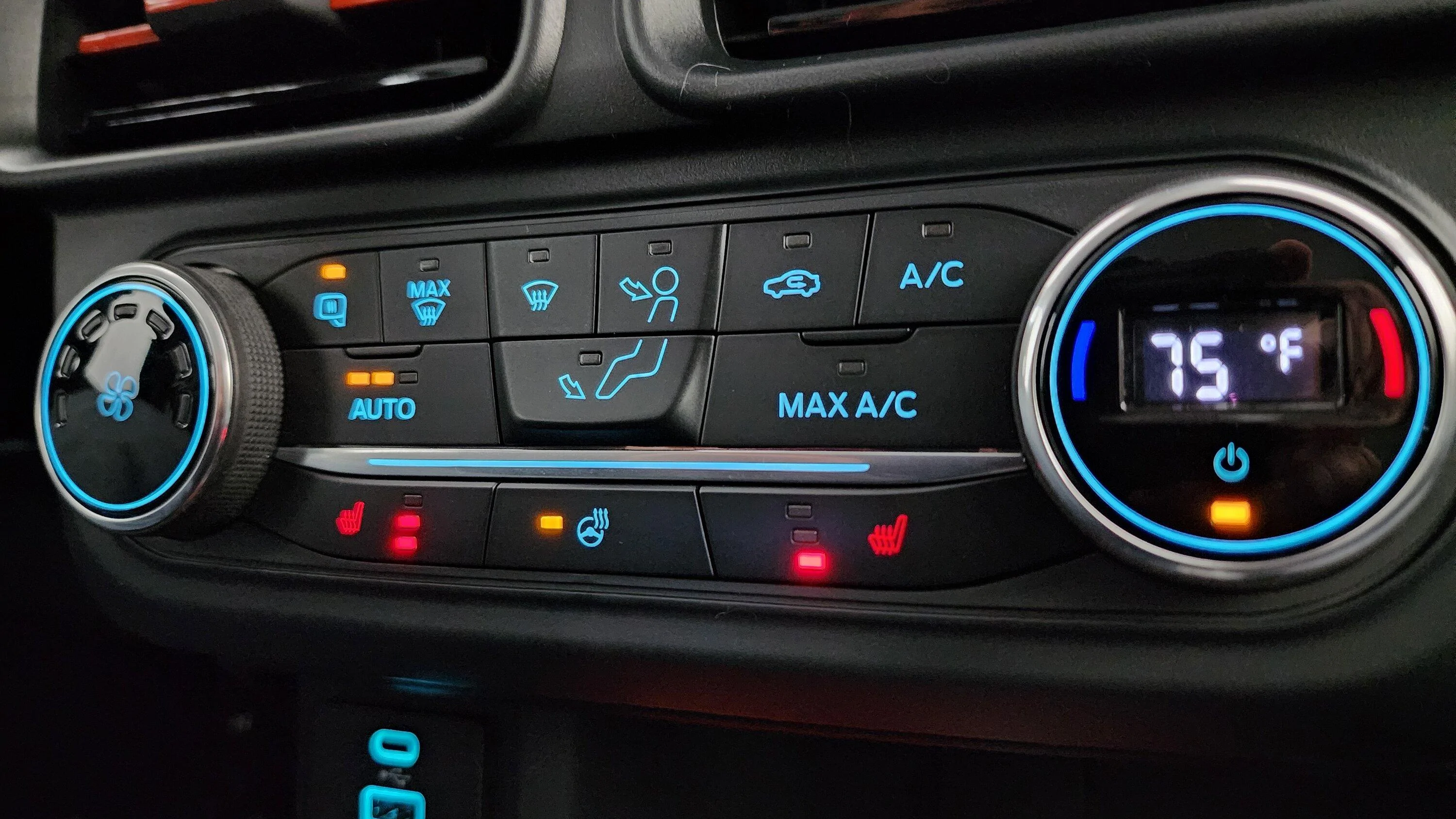

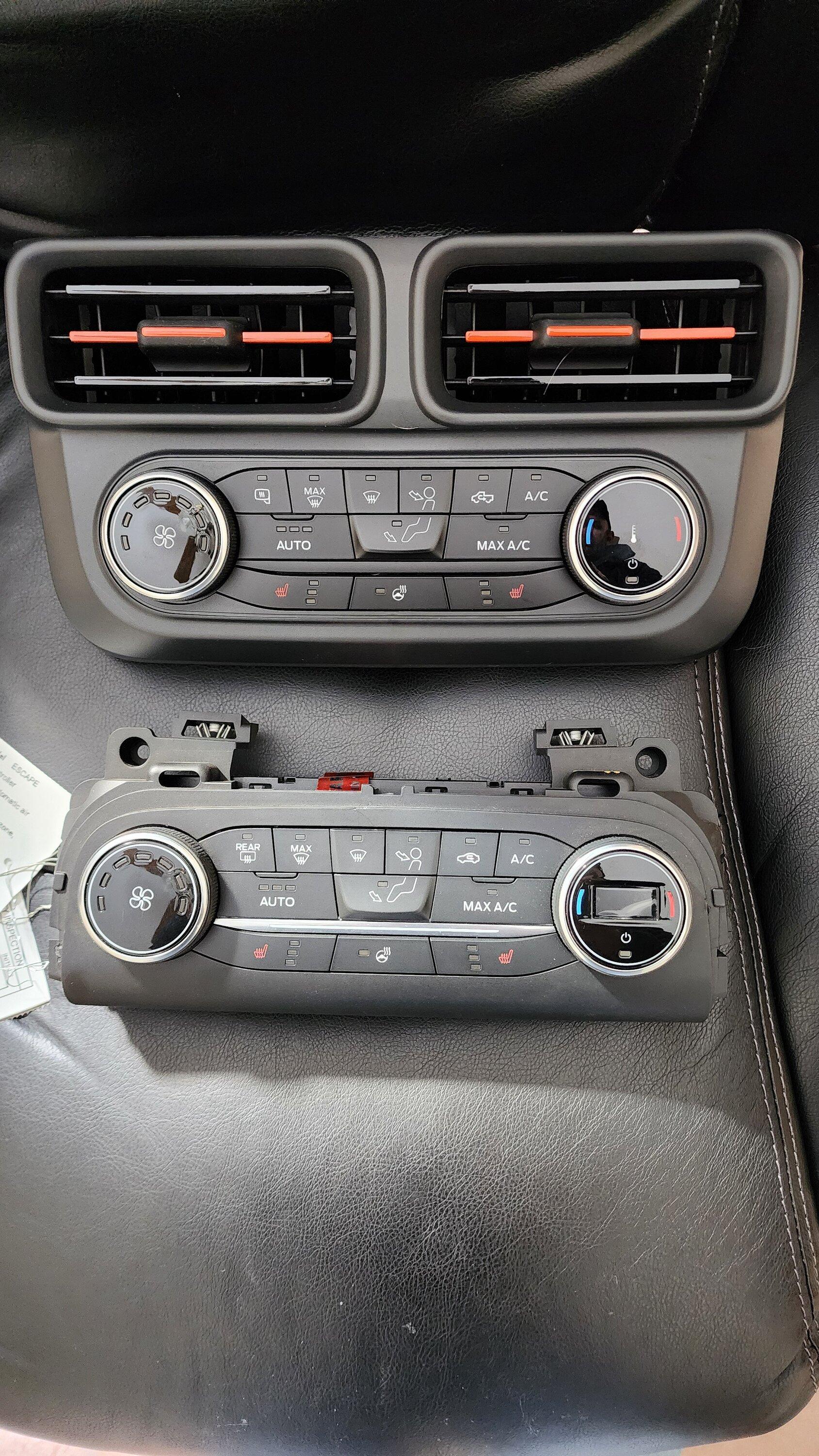

Reviving this thread to add some important info. My ‘23 Lariat Lux (Built in July 2023) did NOT have the screw between the HVAC module and the dash panel, meaning all of the clip breaking and trim removal wasn’t needed!
Check if your truck has the screw before fussing with trim/screen removal by sticking a piece of paper between the duct as shown in photos 1 and 2. Also, make sure to properly locate the vents on reassembly - there are holes that can be misaligned (4th photo).
I removed the vents by using a junk plastic card to pry one of the upper clips off. The others will come off with a tug after that.

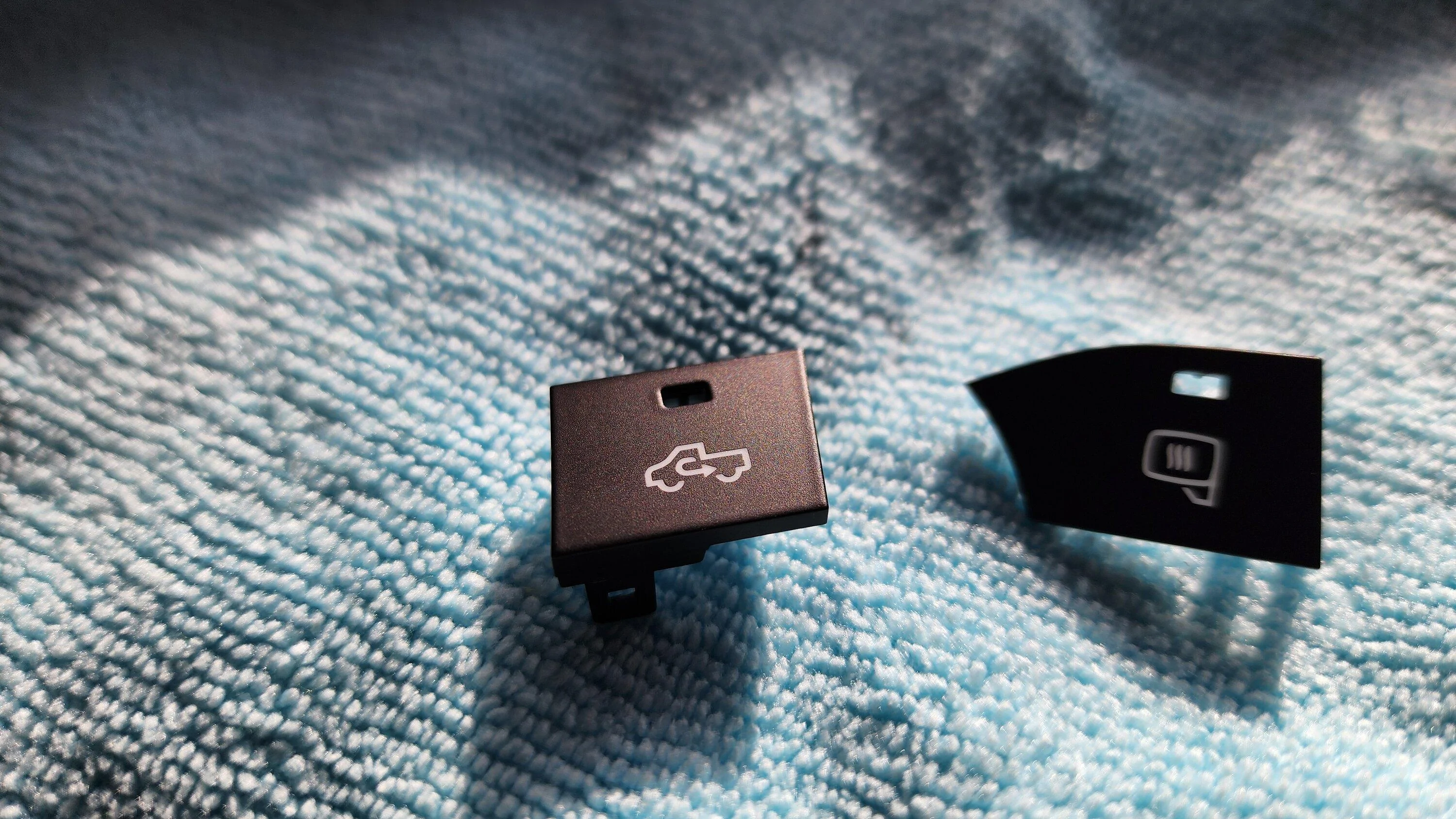

Be VERY careful swapping the heated mirror and recirculation buttons, they are easily scratched. They’re each held with two tabs. Practice on a different button on your truck’s original module first. I scratched the main A/C button on the new module and had to swap it over (3rd photo). Also, make sure you have the light tubes behind the buttons in place. Mine came out with my truck’s buttons.
Overall, this is very easy to do and it truly is plug and play - no Forscan needed. The little screens are FAR more responsive.
For anyone wondering, this is the module for a 2020-2021 Escape. I paid $76 shipped on Ebay.

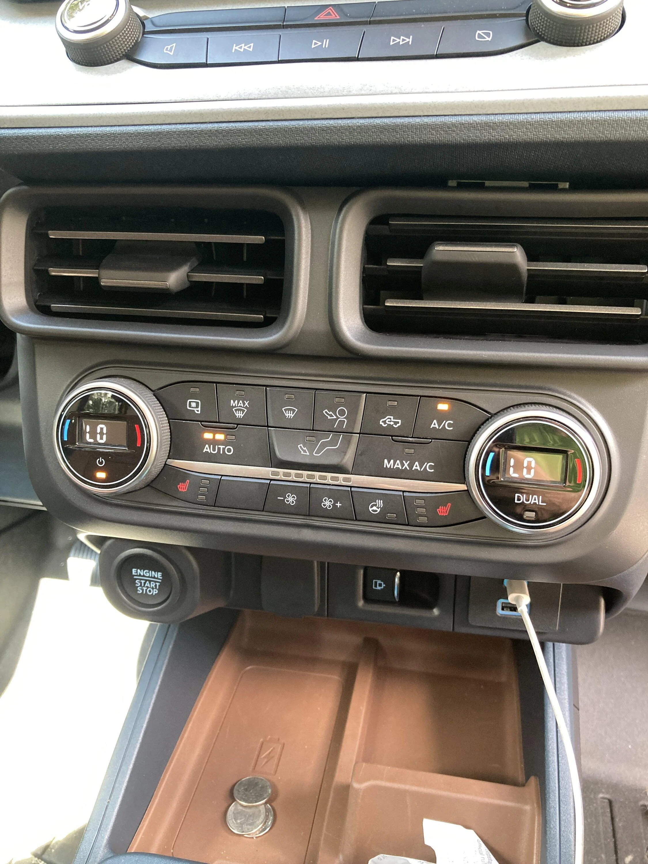

Completed my climate swap today. I made it a point to grab one from an EcoBoost Escape to prevent messing with Forscan.
HUGE SHOUTOUT to @CaptBanana for the tip about checking for the dash screw by using a car dealer keyfob. This tip saved me a lot of time. Thank you good sir!

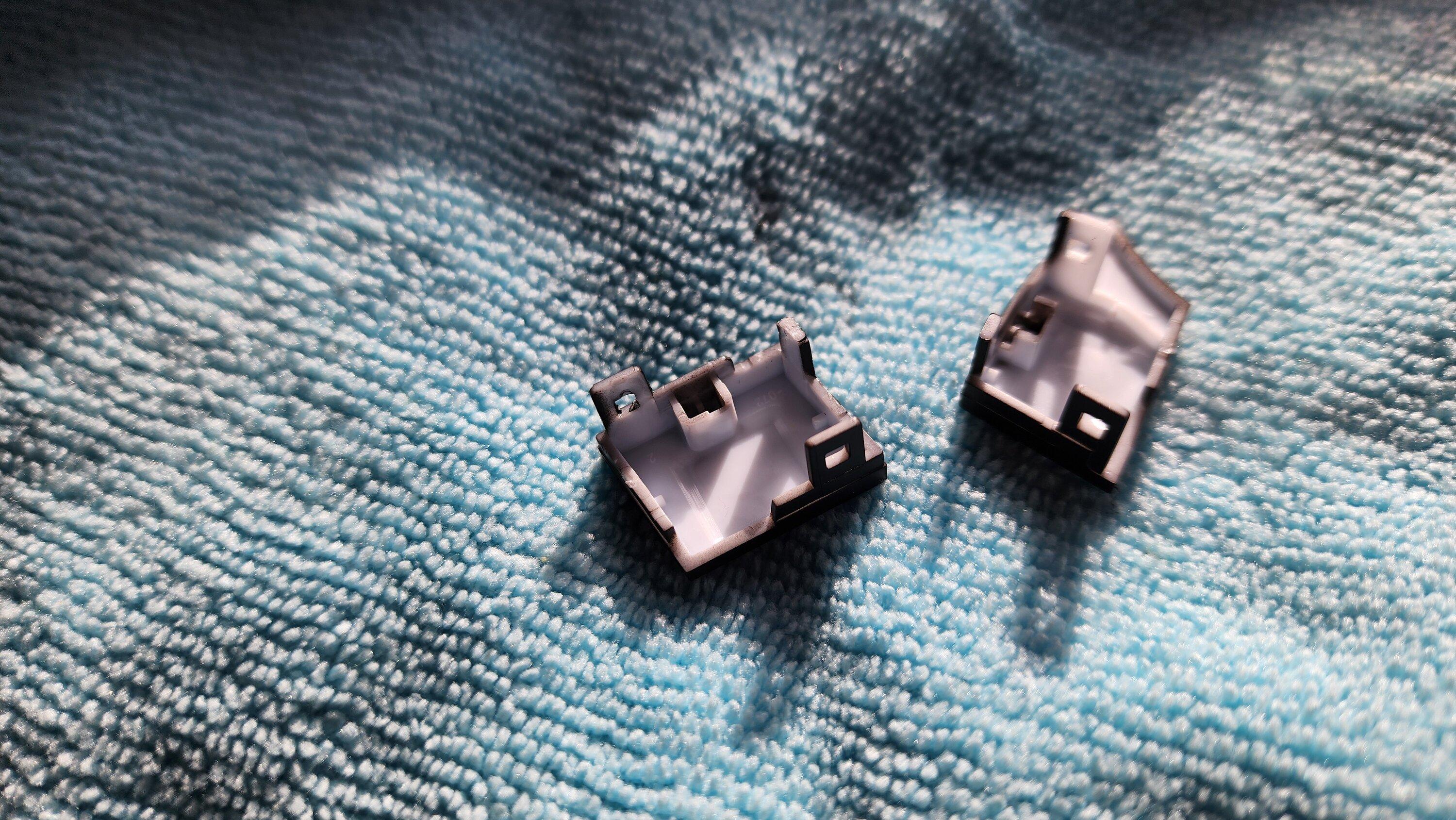

One bit of info I came up short on was the button swap. I have attached a few pics of the tabs in question below and once you know where to tabs are its not too hard to swap them. That being said, I had to give up on the truck recirculate button since it just wasn't coming off the "new" unit.
All said and done, everything works (heated seats, heated steering wheel, heated mirrors, and auto climate) with no tweaking needed. I love my digital temp gauge, as unnecessary as it might seem to some.

Sure. I used a very small flathead screwdriver like the kind you might see in a small bit ifixit kit. Initially, I took the HVAC unit totally apart thinking this would help to remove the buttons. Wrong, it really made no difference since the buttons have to be popped off from the front. The idea is to bend the tabs just enough so that it will pop off. Easier said than done. As I said in my post, I gave up on the second button (truck shaped recirculate) for fear of damaging the unit.
Pro tip: Practice button removal on the old HVAC unit you're replacing. Practice on buttons you wont be reusing.
