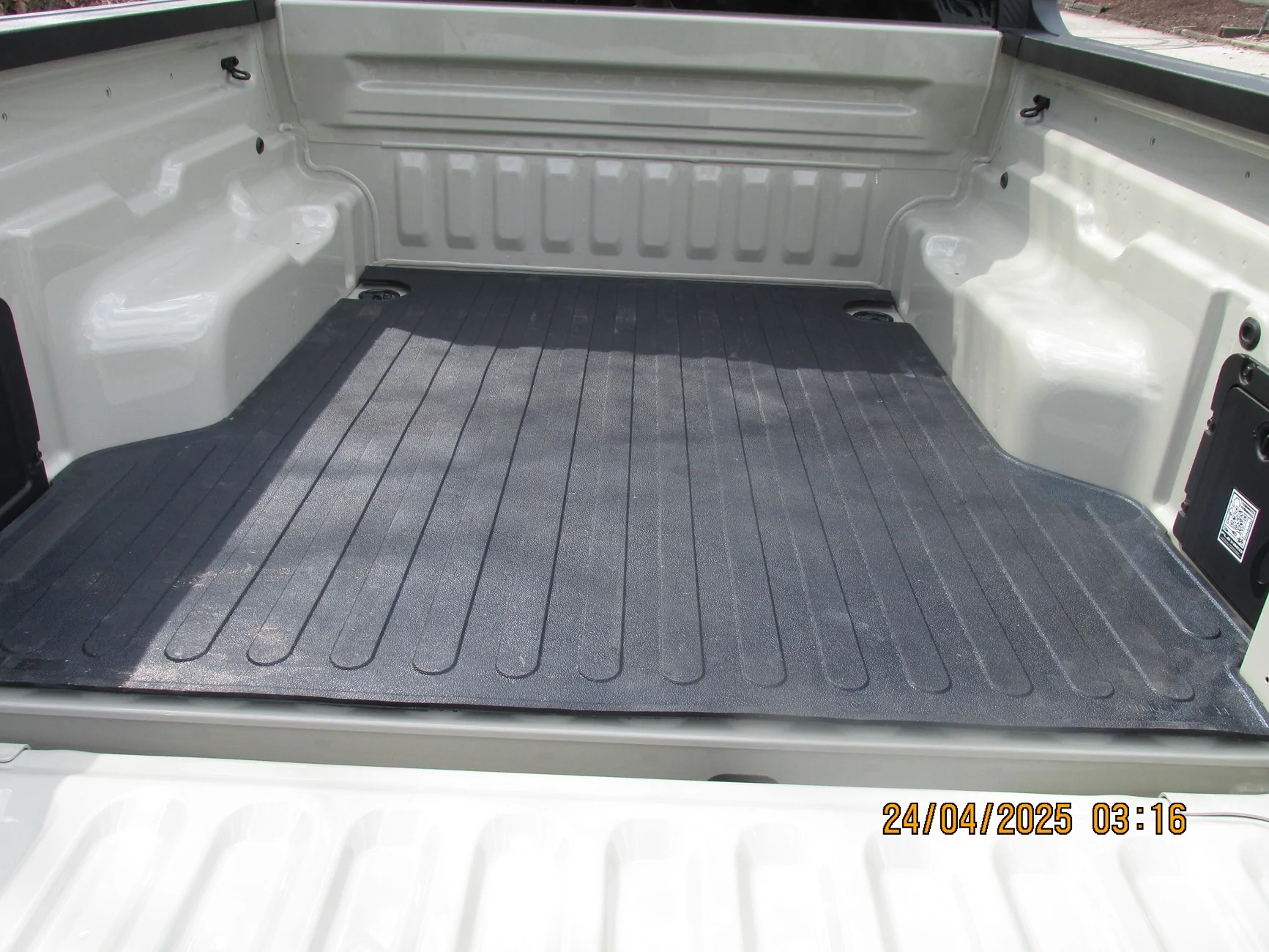

Is it an XL? My 2025 XLT came with them.

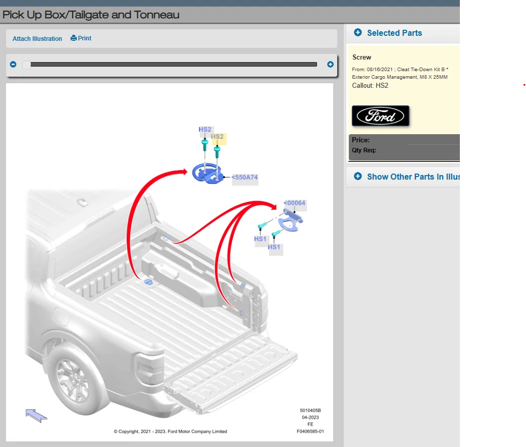

According to Ford's catalog they are M8x25mm.

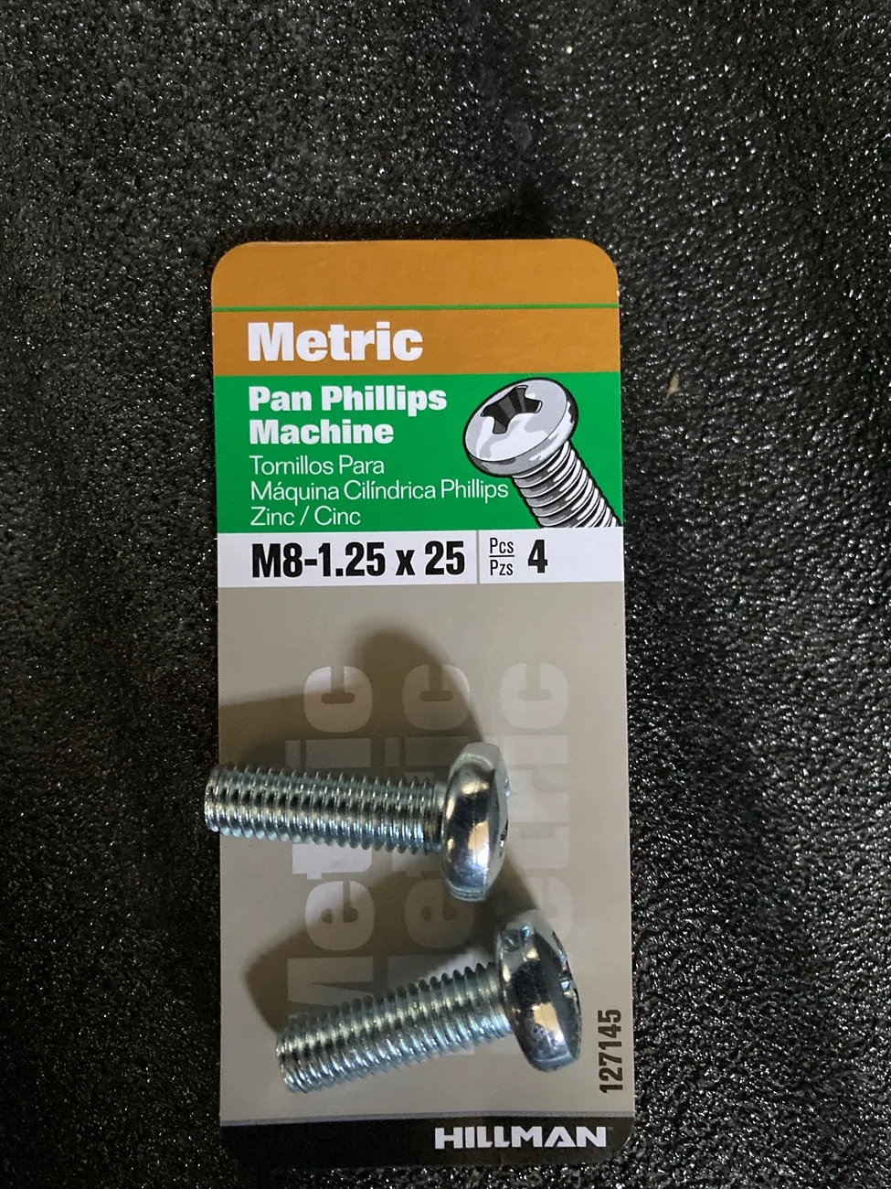

Lowe’s, Amazon…pretty easy to find.
