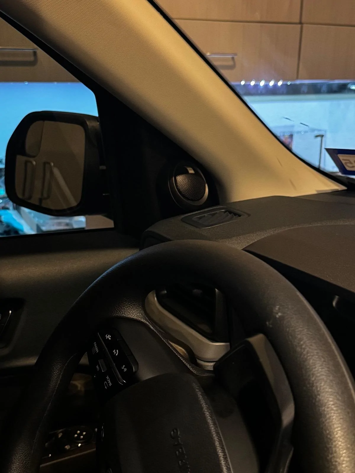

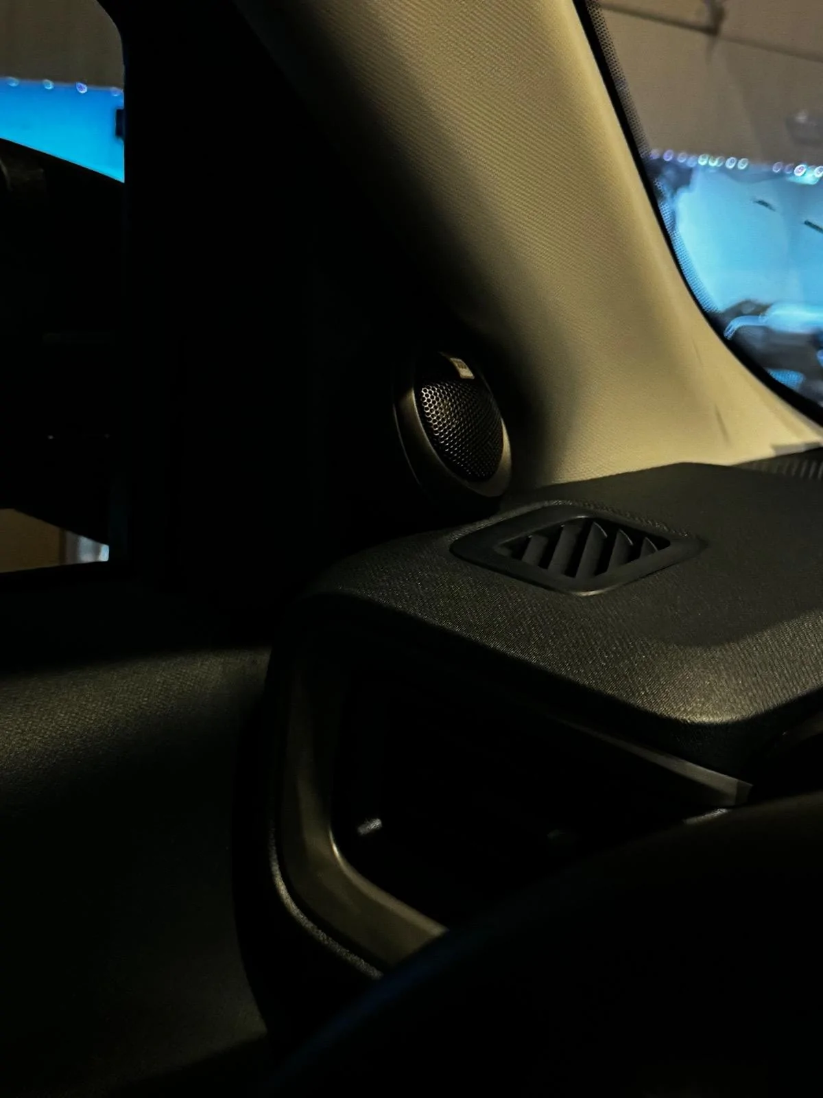

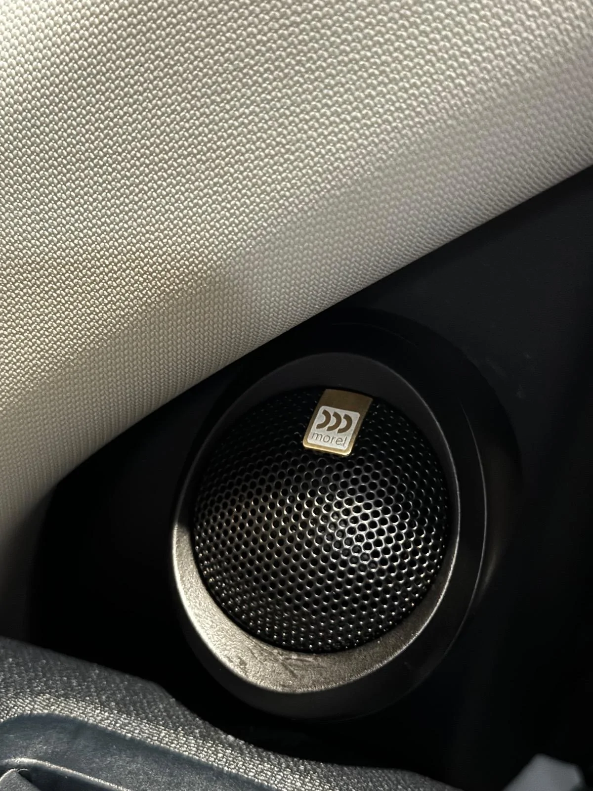

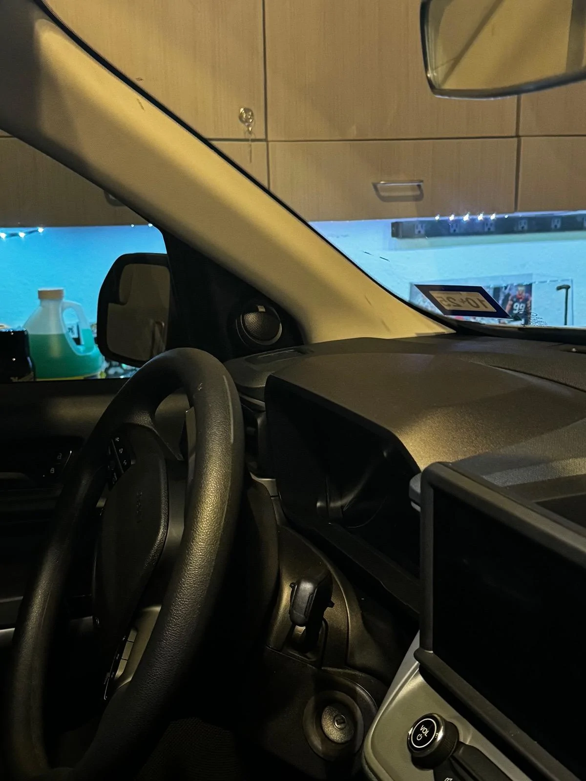

I installed a set of Morel components and chose to mount on the sail trim piece instead of the dash. Much easier install and sounds great. Just test fit and measure/mark/drill with the door closed to ensure the fit.

I know this is an old post but how did you wire these tweeters? I'm wanting to try to mount a pair of Hertz Tweeters on axis with the stock pod that came with the tweeters, but I'm bi-amping off a Kicker Key so I'll need to run new wire to this location. Did you run wire through the door hinge cable bundle?
Yup, that's exactly what I did.
