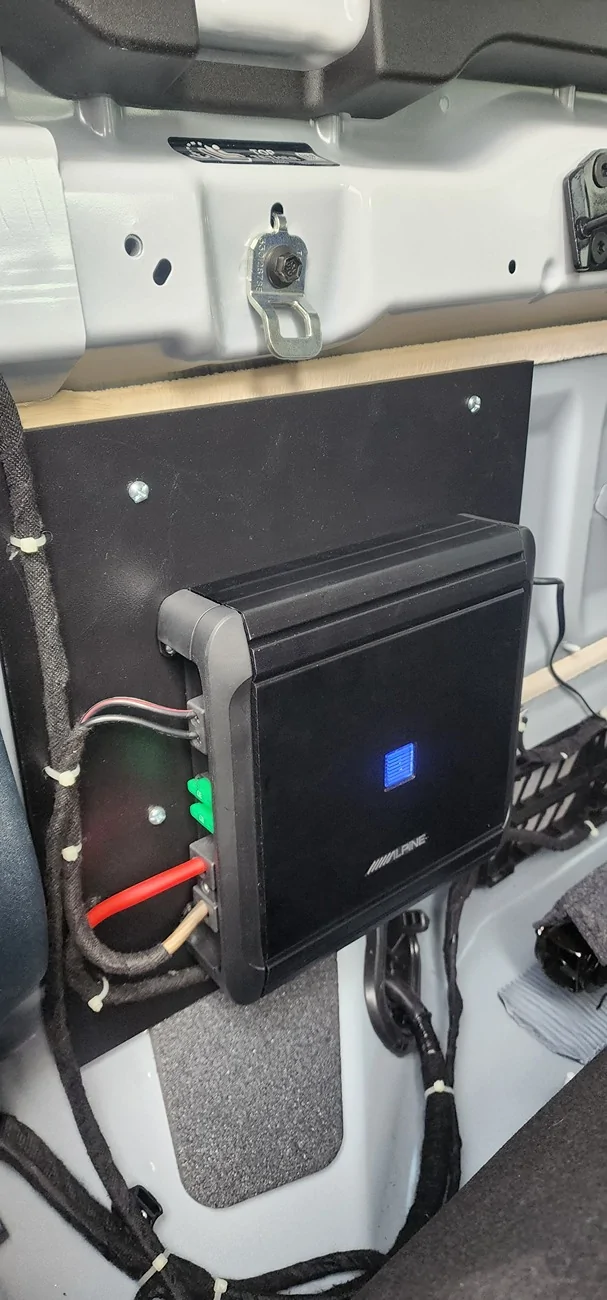

Personally, I did components up front, similar to the OEM, but I did have to mess with crossovers... I put them in the glovebox, and since I was doing an amp behind the glovebox and running new wires to the dash tweeters, it worked out fine.

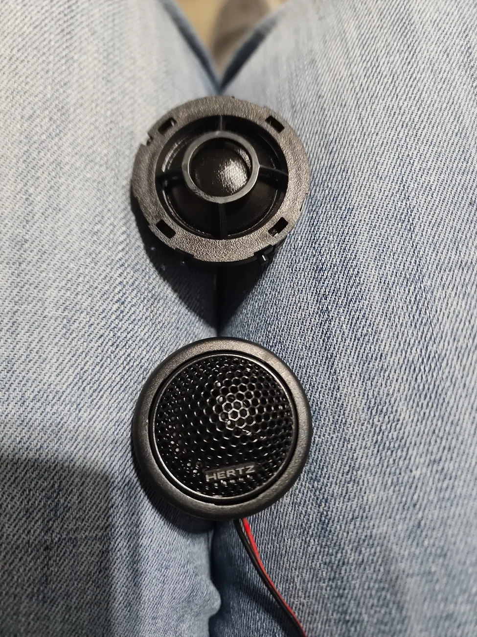

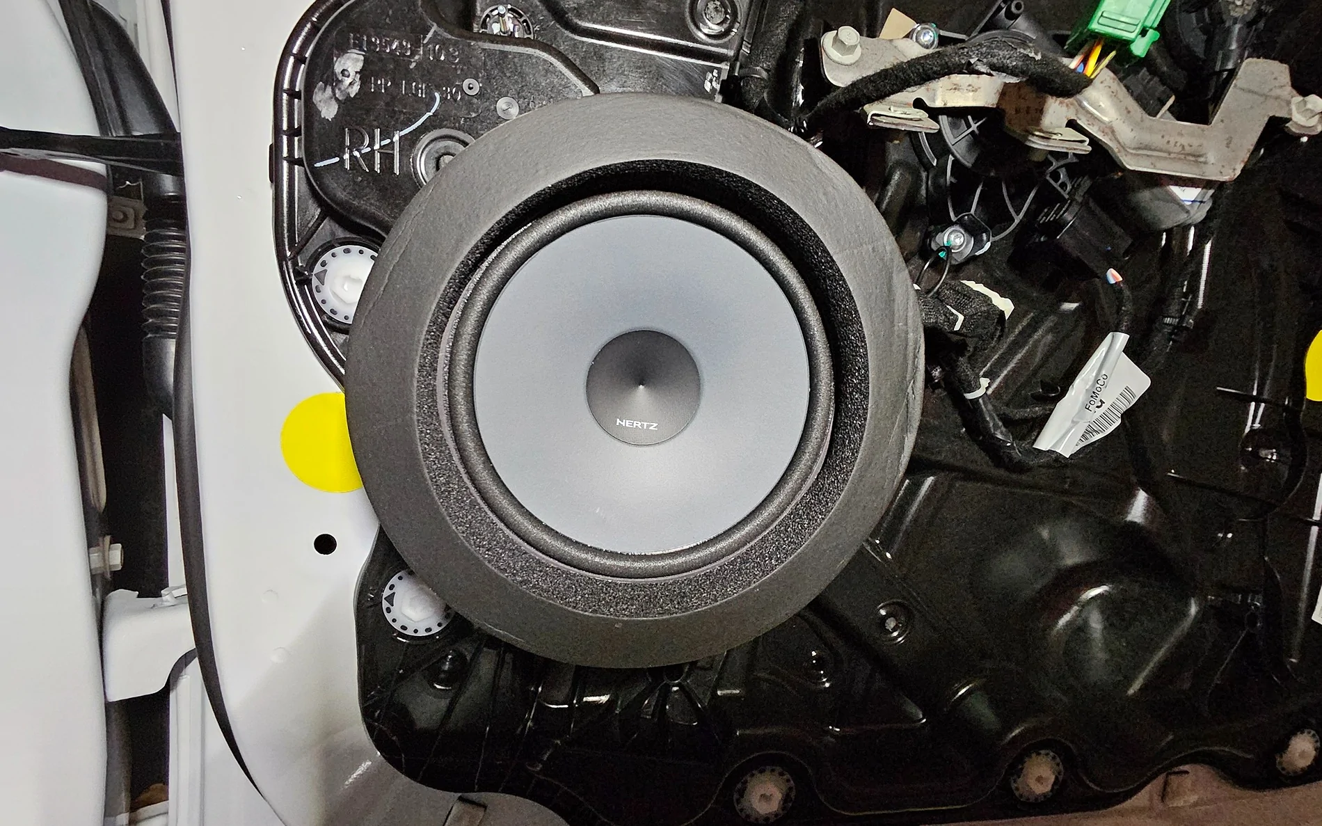

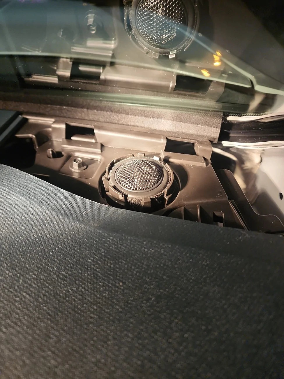

There are many components speakers available that have inline crossovers included. I have the Hertz K170's components and they sound great without spending alot.

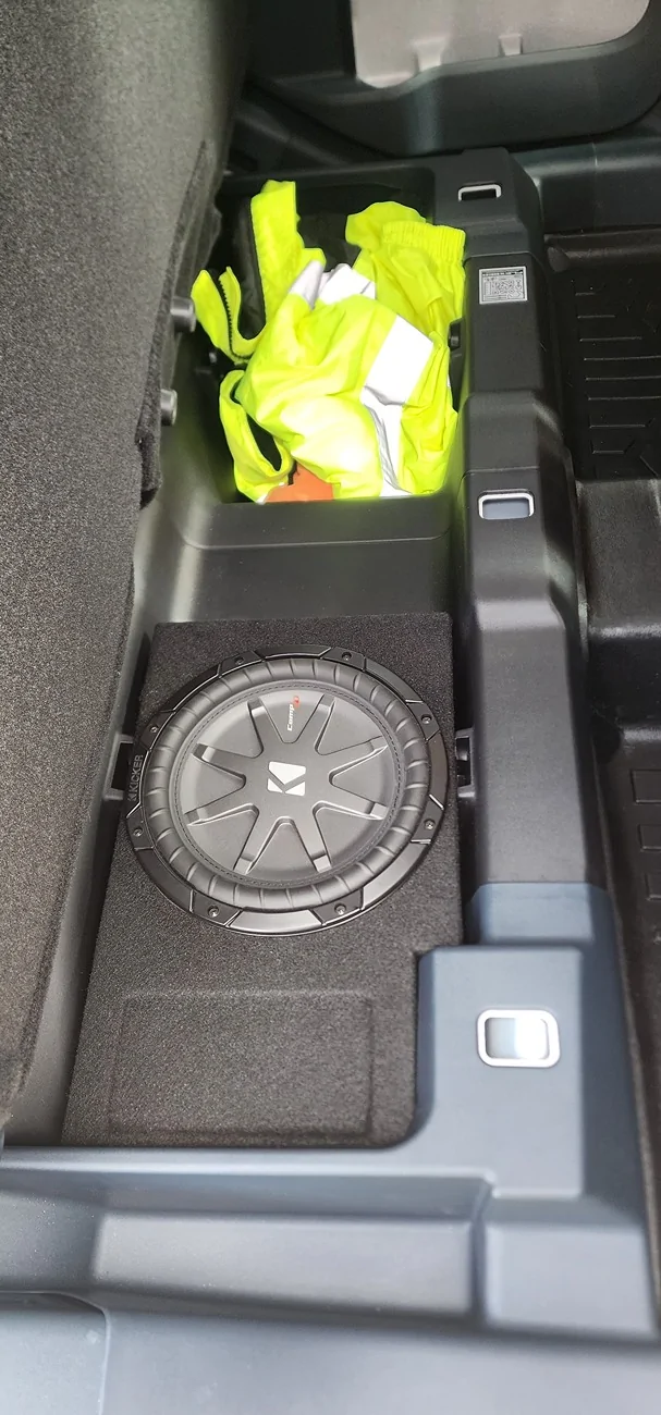

I would recommend adding a sub if you can. I recommend crutchfield as they have so many offerings and include your speaker harness connectors so you don't have to cut or splice your oem wiring or purchase them separately like most audio shops.
