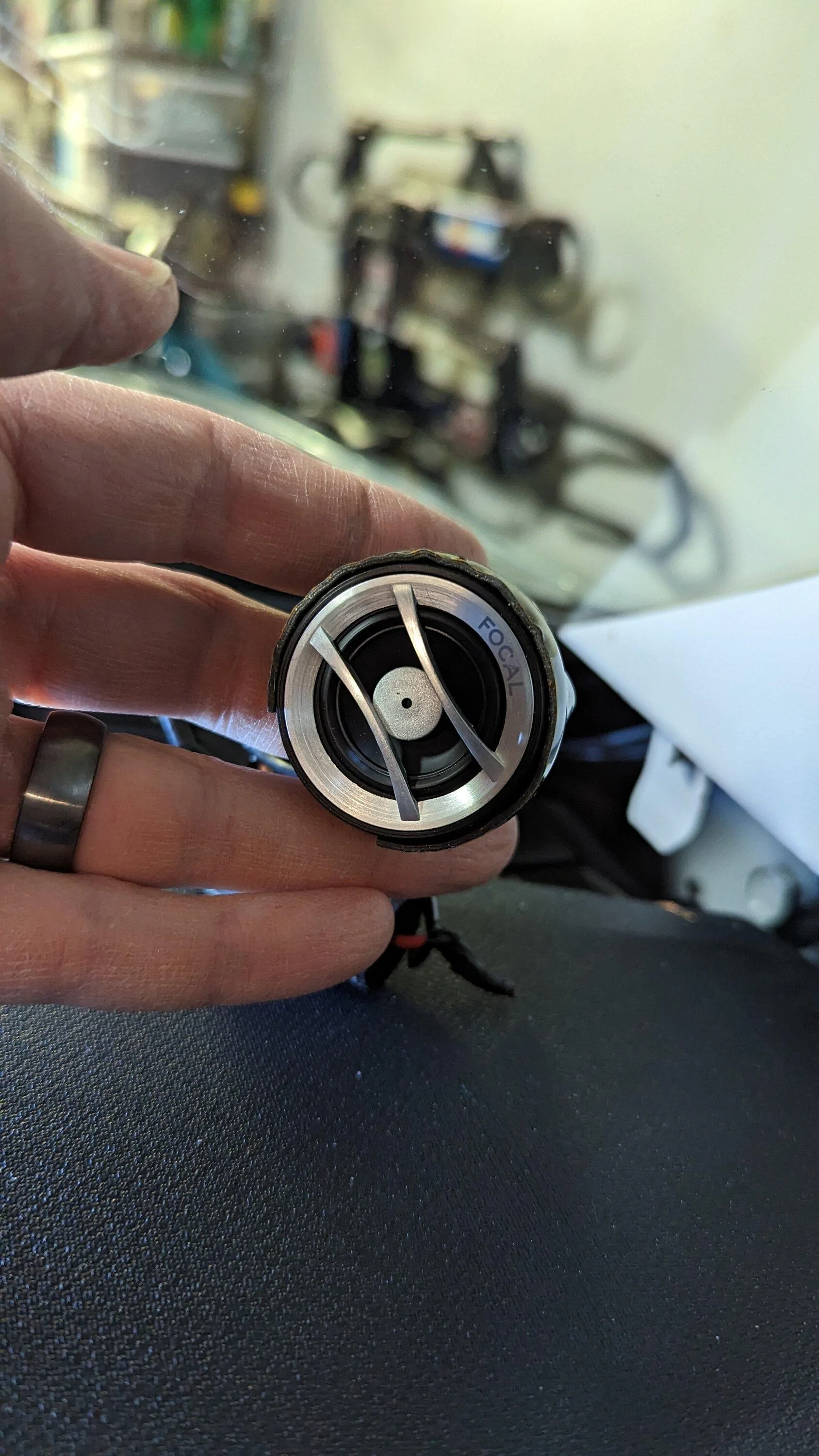

This might be a dumb question, but does the Morel tweeter have a trim ring that can be removed?
I installed Focal RSE 165 components and the tweeter did not fit as it came out of the box. I used a very small flat blade screwdriver to pry apart the trim ring and removed it. This then fit into the factory tweeter ring, but was a little loose. Others have reported using hot glue or silicone, but I went with double-stick tape and put it on about 80% of the tweeter as shown. This was enough to get a snug fit and I think if I ever remove them it'll be far easier this way rather than if I had covered all of it with double-stick tape. (I should be able to pry the bottom of it where there's no tape.)
Compare my pic with the images on Focal's site. I didn't measure but I do still have that trim ring so I could reverse this change (to install the tweeters in another vehicle for example). https://www.focal.com/en/technical-...ns/performance/auditor/component-kits/rse-165
