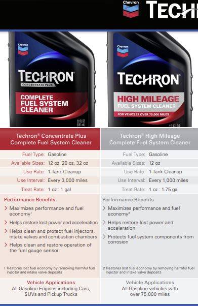

I'm a "Yay" on periodic use of fuel system cleaners, regardless of if you have a forced induction DI (2.0EB) or naturally aspirated MPFI (Hybrid) engine, even if you religiously use Top Tier gasoline.
Look for a product with a polyetheramine (PEA) additive, that's the secret sauce good cleaning agent. Techron Concentrate Plus (1 US oz. per 1 US gal., 10%-20% PEA) is a good product. So is BG Platinum 44K (1 US oz. per ~1.9 US gal., 25%-50% PEA), Gumout Regane Complete Fuel System Cleaner (1 US oz. per ~1.6 US gal., 10%-30% PEA), Red Line SI-1 (1 US oz. per ~1.33 US gal., 30%-40% PEA), etc.
In many cases, a company's "high mileage" fuel system cleaner will have a higher PEA content than their standard fuel system cleaner. Case in point Techron High Mileage Fuel System Cleaner (it doesn't say 'Concentrate Plus' on the label) - it has from it's SDS 20%-25% PEA, treatment is 1 US oz. per ~1.75 US gal., so it's a little 'beefier' than the Techron Concentrate Plus.
Chevron USA's SDS components for their Techron products don't say PEA, they say Trade Secret - but it's PEA.
Ford Maverick Rolled over 10k miles! Fuel Injector Cleaner Question cvx techron.JPG
