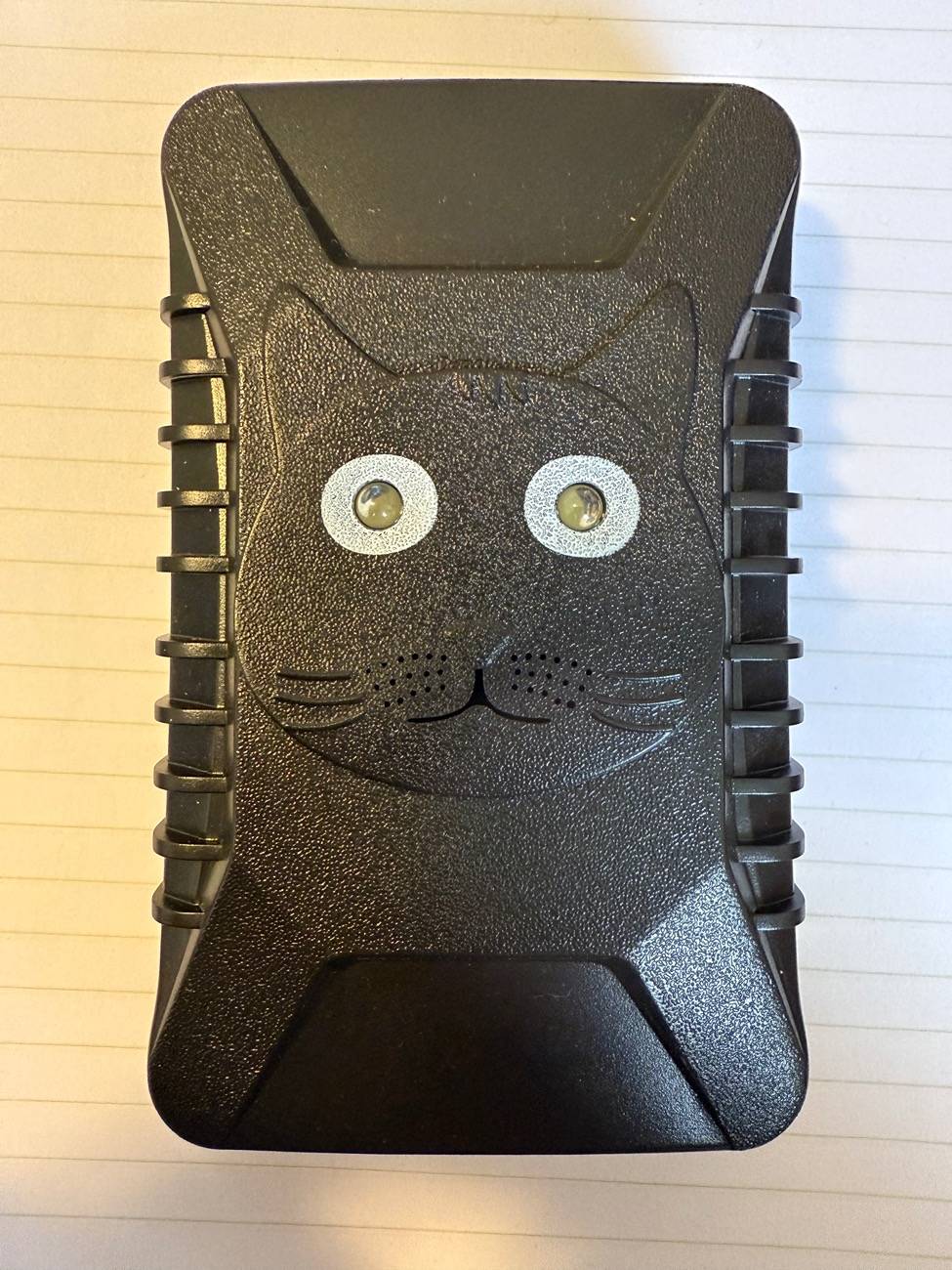

I’ve used “fresh cab rodent repellent” sachets - they seem to work well although it uses many essential oils you’ve mentioned- so your rodents may have a different palet than others. We also have installed these from amazon:
https://a.co/d/angPj0r
They work exceptionally well! Give off an ultrasound noise and flash a light every 30 seconds or so. We have packrats in southern AZ, and this seems to help.
Also, consider parking with a light under your hood. Solar light or similar. They like the dark!!!.

Ford Maverick Rodent damage Security cat
