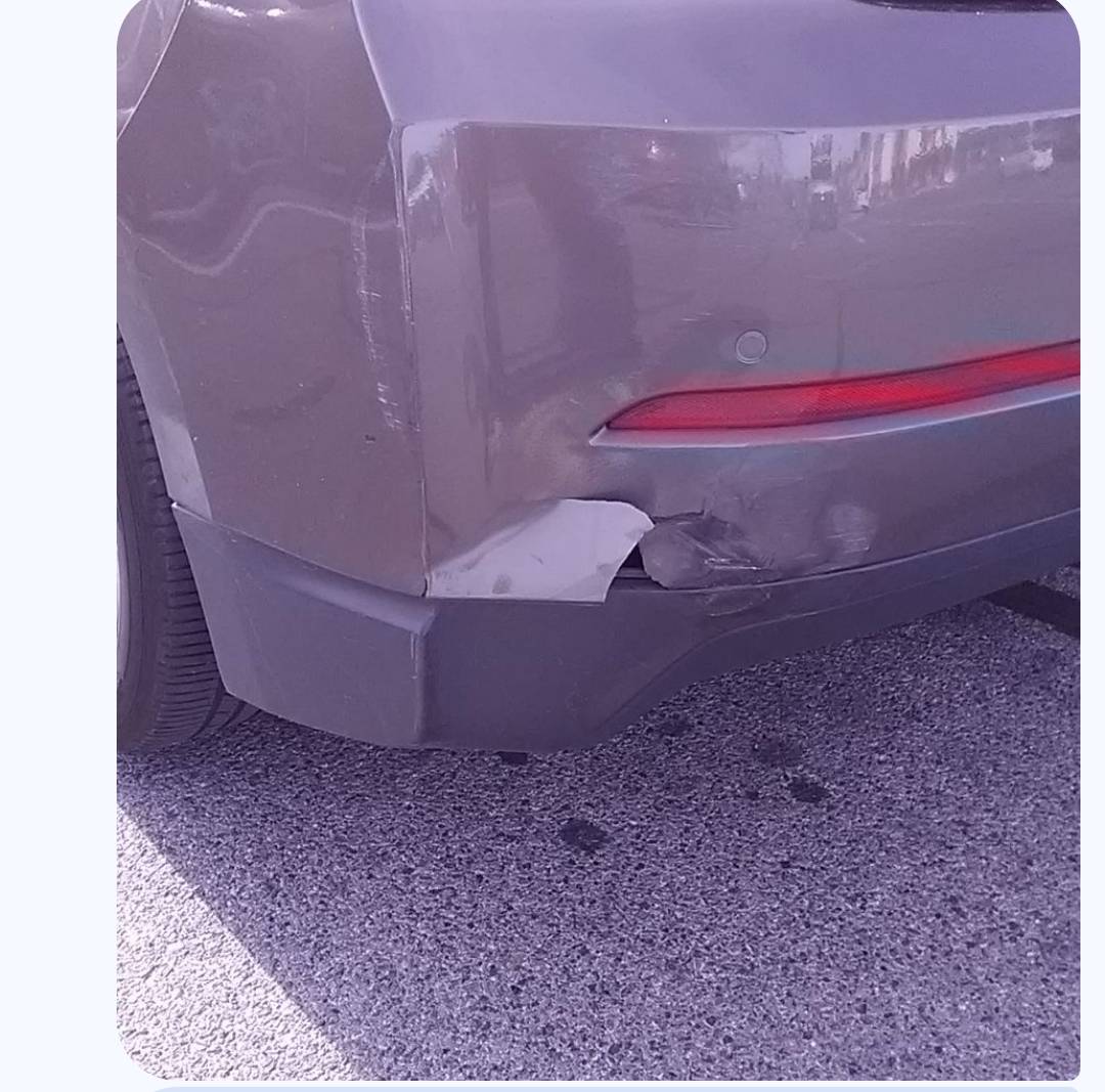

I bought my first Chevy Volt at a great price with this damage to the rear bumper.
Ford Maverick Minor Bumper Damage Screenshot_2025-01-28-10-58-48-67_0ce57feeccaa51fb7deed04b4dbda235
In an industrial part of the wrong side of town I was told about "Armando's" body shop that basically deals in cash only. For $300 this is how it came out.

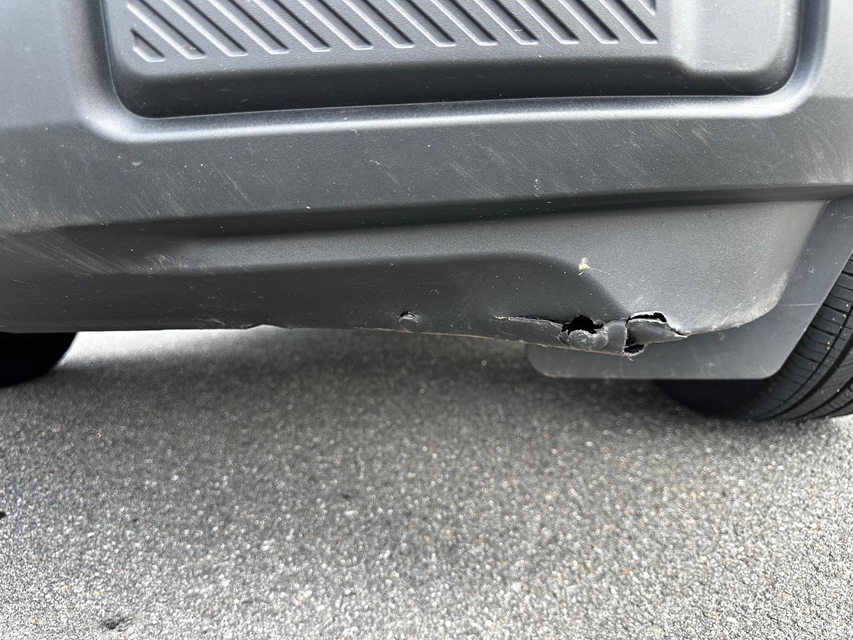

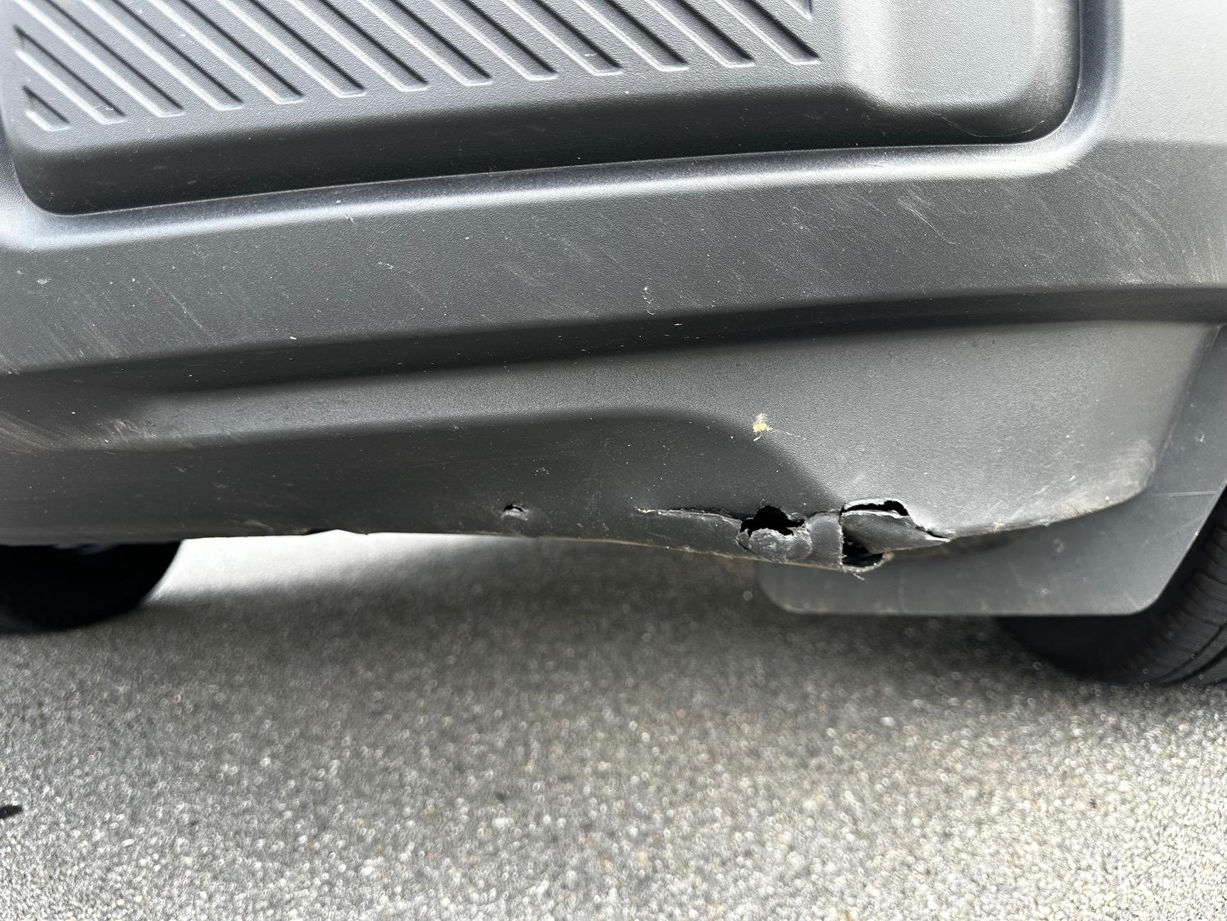

Wondering it there's any good way to fix this bumper damage. Epoxy resin and paint to match bumper? Not willing to duct tape but also not willing to replace bumper - it IS a Truck ... sorta :)
Welcome any recommendations and product specifics. Thanks.
I’m no body guy but I would maybe consider drawing a clean straight line right above the damage and cut it off and match the opposite side and clean up the cut with a file or sanding block - this would be an option if you‘re not planing to replace it or have it professionally repaired I think a home repair could look worst unless you’re a pro

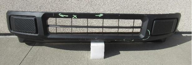

With the number of rear-ended maverick reports we see, scrapyards should be up to their necks in good font bumpers . . .
