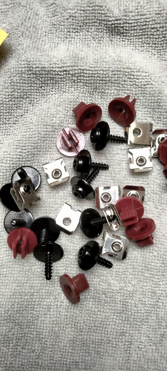

What's the best option for replacing the speednuts if you've stripped them?
Because Ford had already stripped a nut, when the previous owner had his first oil change at Ford.
I bought a package of these replacement speed nuts and bolts.
Sorry, I do not remember the link.
It was either off of eBay or Amazon.
Good Luck

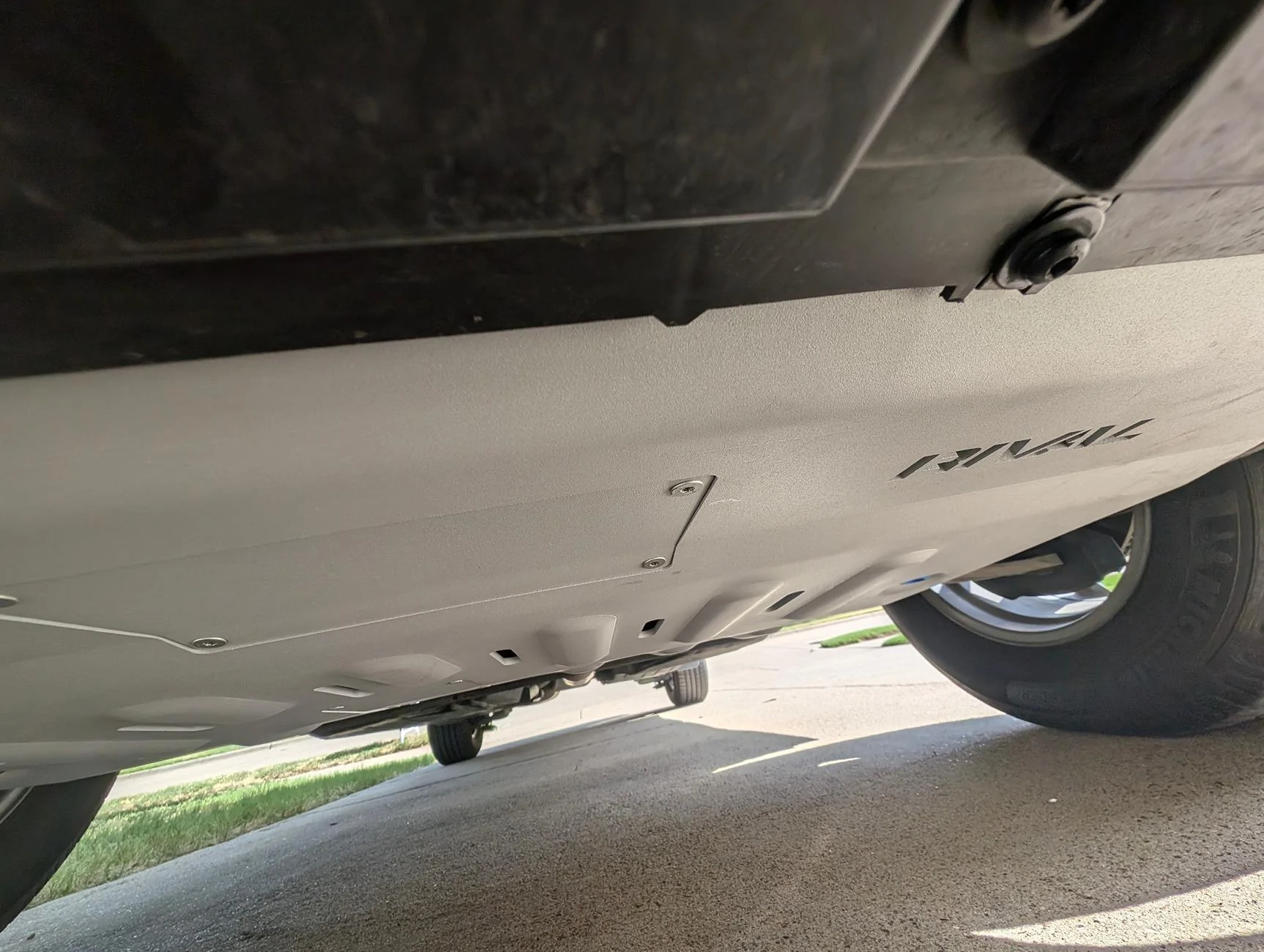

Ok, I put the factory screws back in (even though I don't think they do anything except hold the factory shield in place.
Here's why the skid plate can't utilize the factory holes. The rivals front lip goes up slightly at the front. As it sits, it is the same height as the factory shield screw holes. If it were made to fit, I think it would have a downward pointing front lip (scoop?!?) and would make the ground clearance worse. I think the design is good as is.

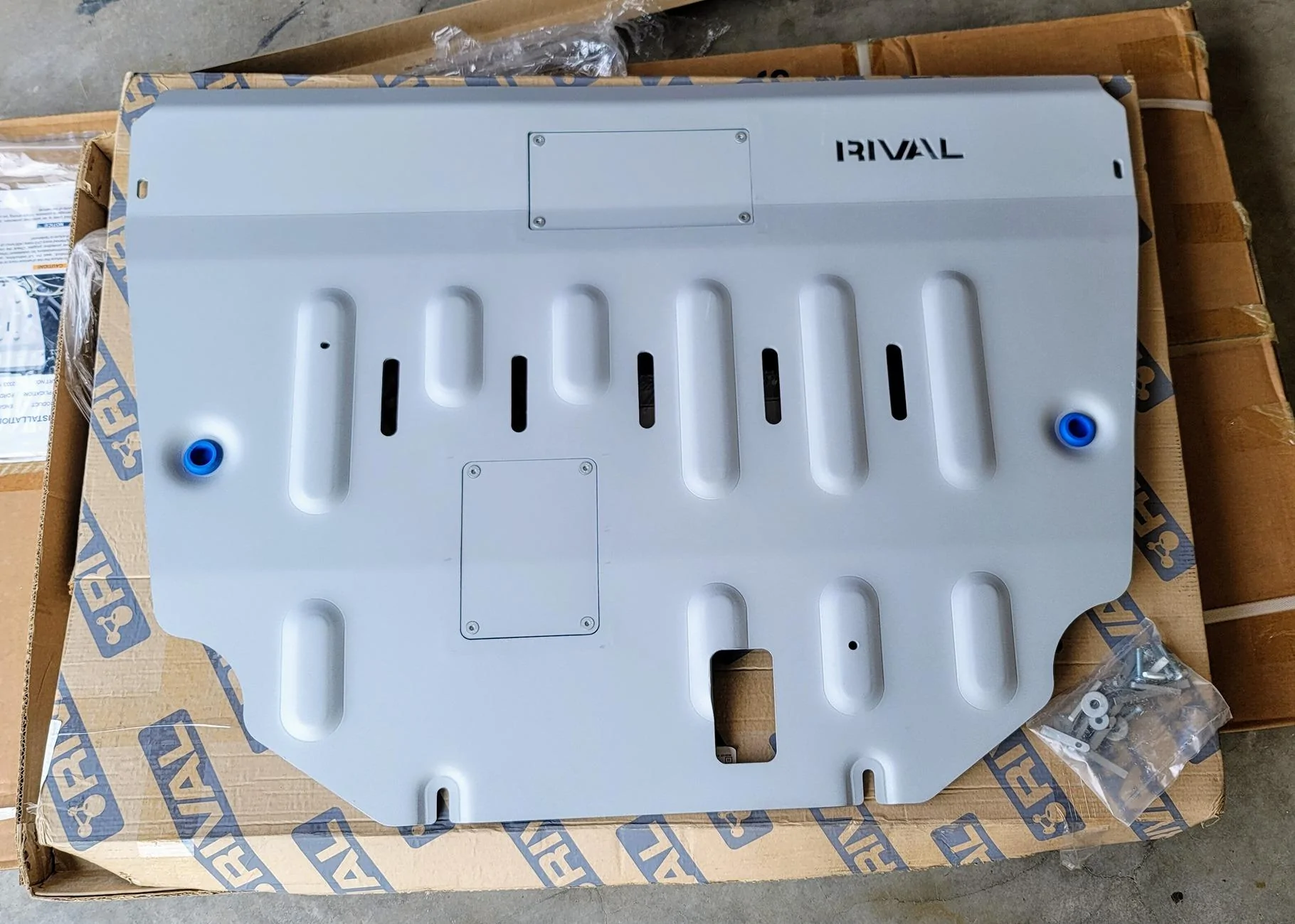

FedEx just dropped off a present:
Ford Maverick RIVAL Aluminum Skid Plate Ford Maverick (non-Tremor) 20240715_102832
The finish is really nice!

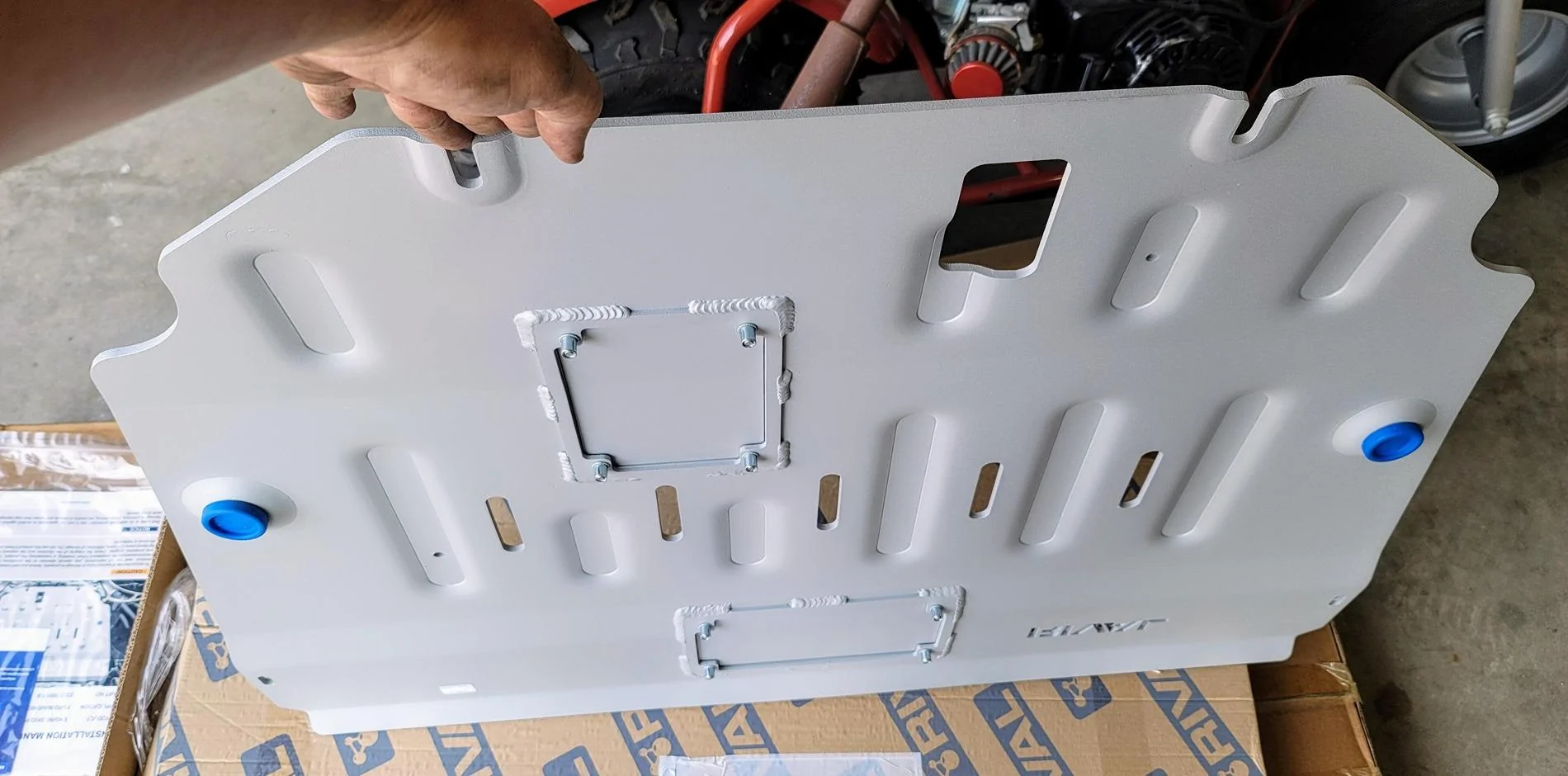

It's nicely formed and the welds are nice.

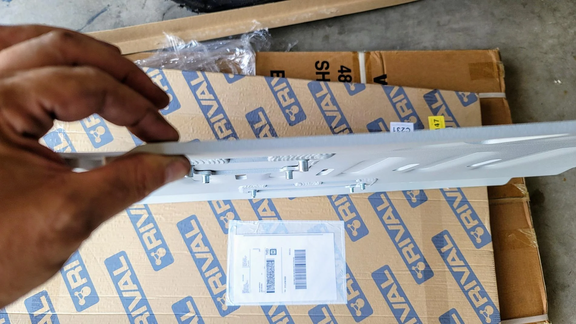

This thing is beefy! It weighs over 20lbs. I'll try and get it installed tomorrow morning before work. And yes, I will take plenty of pics lol.

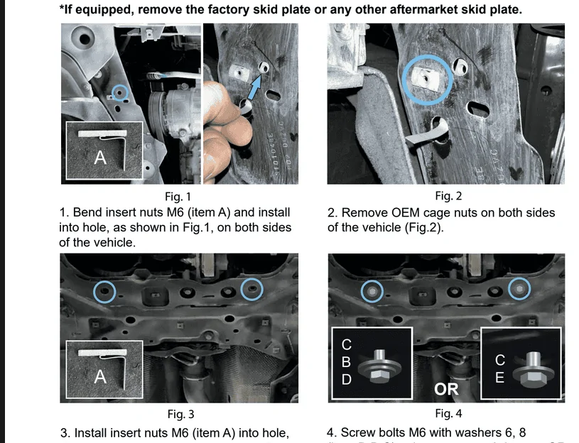

Installation was pretty straight forward but I did run into some issues.
Ford Maverick RIVAL Aluminum Skid Plate Ford Maverick (non-Tremor) Screenshot_20240723_002238_Adobe Acrobat
Figure A shows what hole the insert nut should be inserted into and what hole the threads should be in. I ended up using the hole left over from the factory clip as the "tail" from the insert but was between the skid plate and engine cradle. It was preventing the skid plate from laying flat.
Figure 3 tells you to insert the nut plate into the indicated hole but that's where the threads need to be. You have to use the smaller hole next to it and finagle the insert nut. I had to squish the "tail" on the insert nut completely flat with pliers to get it into the smaller hole. I managed to drop the insert nut only once in the cross member and had to use a magnetic pickup tool to fish it out :explode:
