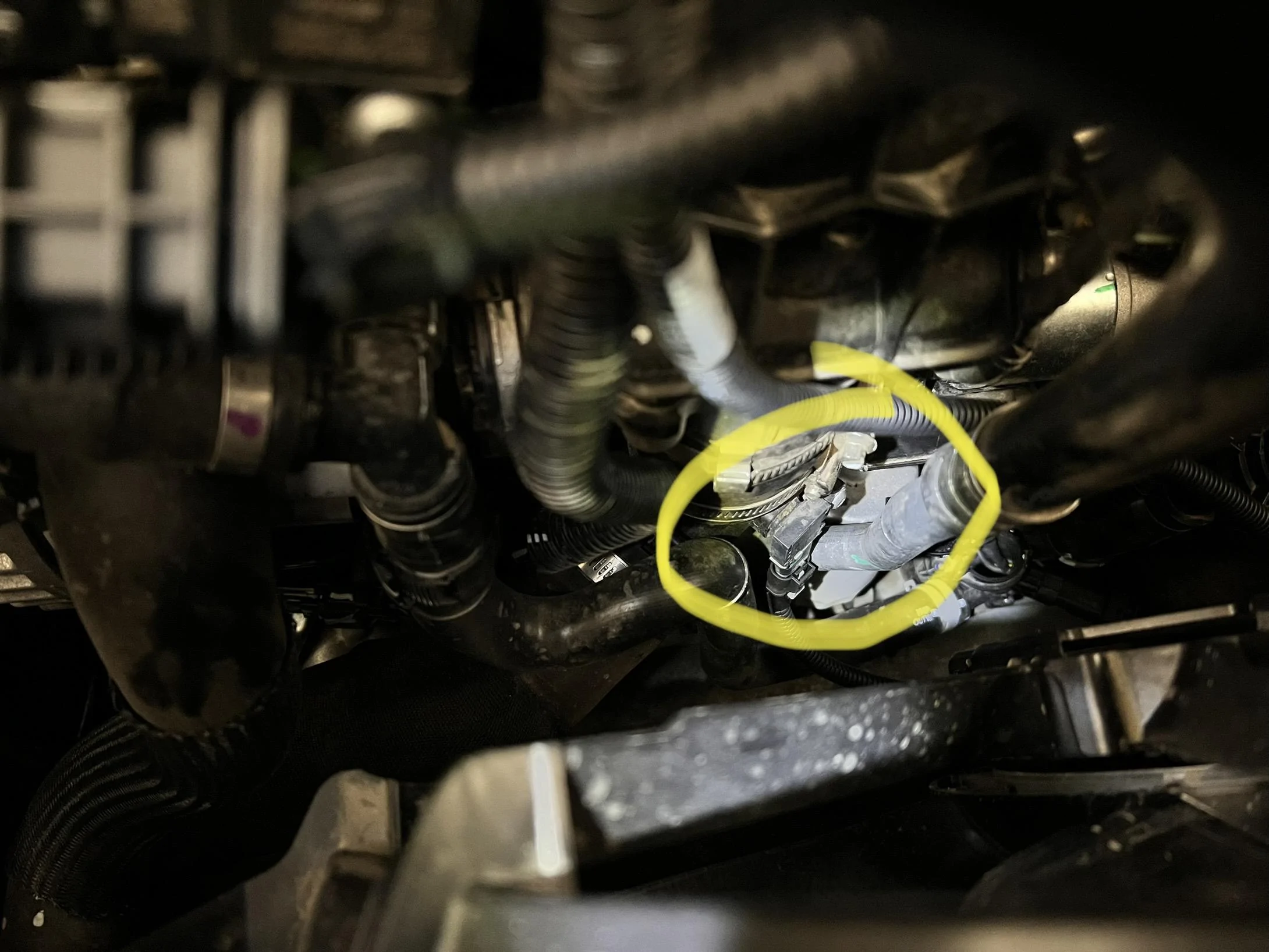

This thing is the only car part I can remember giving me this much of an install headache. Has anyone been able to take a decent picture of the sensor harness “B” plugs into? Thought I had the right one but it wouldn’t push all the way in to lock. The one I circled is what I thought was right. Was trying to avoid taking the skid plates off from underneath but I don’t even see another sensor choice from the top right now

I just got home. If no one else post a pic I will in a few.

Thanks. Panda says that is the correct sensor so I am a bit puzzled as to why I can't seem to get it pushed on all the way so that I can engage the lock tab on the connector

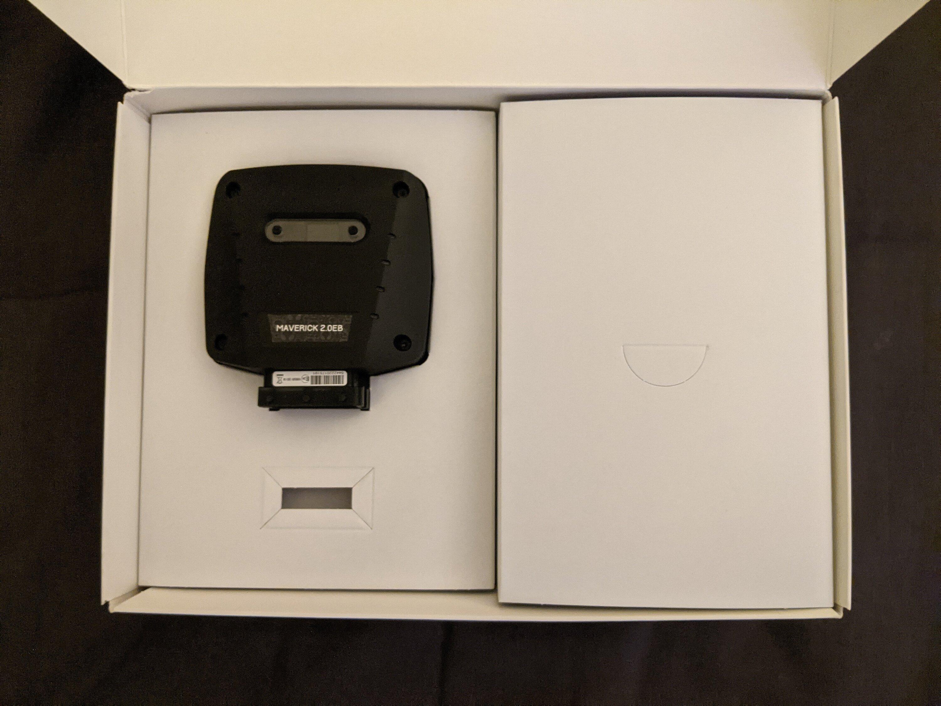

Packaging: When the module arrives and you open the box, it's a nice, neat little presentation, with a list of straight forward instructions, the module itself snug in place, and a box containing the wiring harness. Kinda like opening up the box to one of them new iphones.
They also include a grip of zip ties for tidying everything up after install, just in case you don't already have ties laying around. I did but always nice to have more. I honestly ended up only using two. My shipment also included a shirt and keytag so that was a cool little bonus as well.
