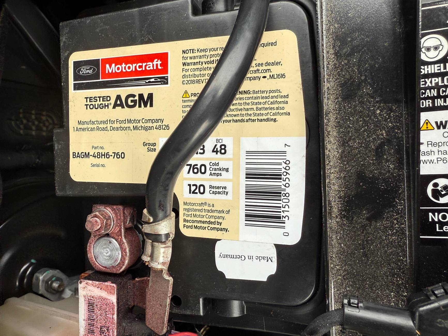

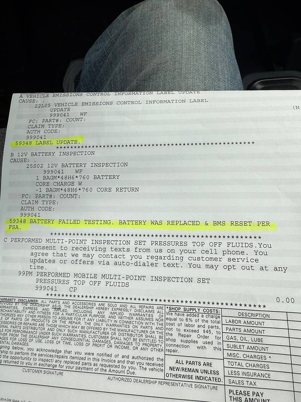

Today I was in for the battery recall and Ford replaced the original wet cell battery with a AGM battery.
Ford Maverick Recall 25S02 Battery Replacement on the 2022-2024 Model Years IMG_0706
Ford Maverick Recall 25S02 Battery Replacement on the 2022-2024 Model Years IMG_0707

Interesting, your AGM battery was made in Germany. A previous poster's replacement battery was made in China.

Yes I was surprised by seeing the made in Germany tag on the battery as I was expecting to have a Chinese made battery. In a year or so I load test the battery and see how it is.
