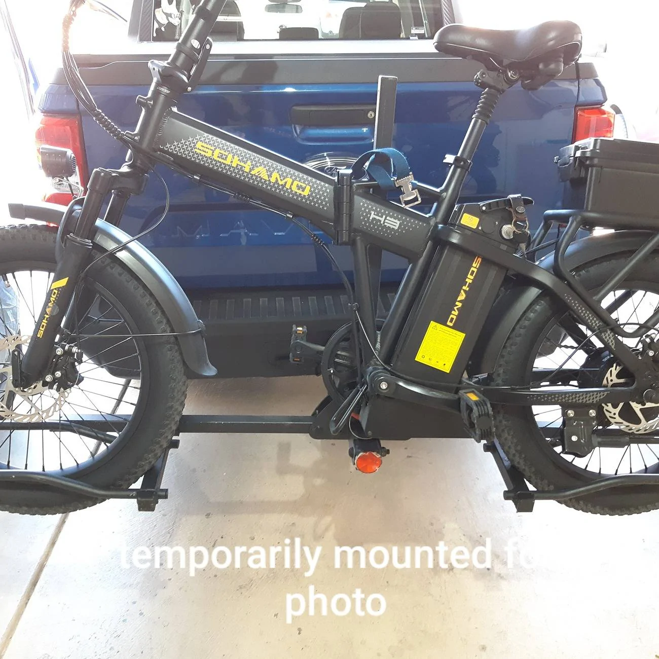

I still have some view with my bike rack mounted and my bike mounted on the rack. I kind of have to look through the bike. It helps to be proficient in mirror usage.
. Since you ride often.
Could you please to take a picture of your screen when your bike mounted on the rack?
Thank you.

Ford Maverick Rear View Camera and Bike Racks..... 20250415_090107
Ford Maverick Rear View Camera and Bike Racks..... 20250415_084541

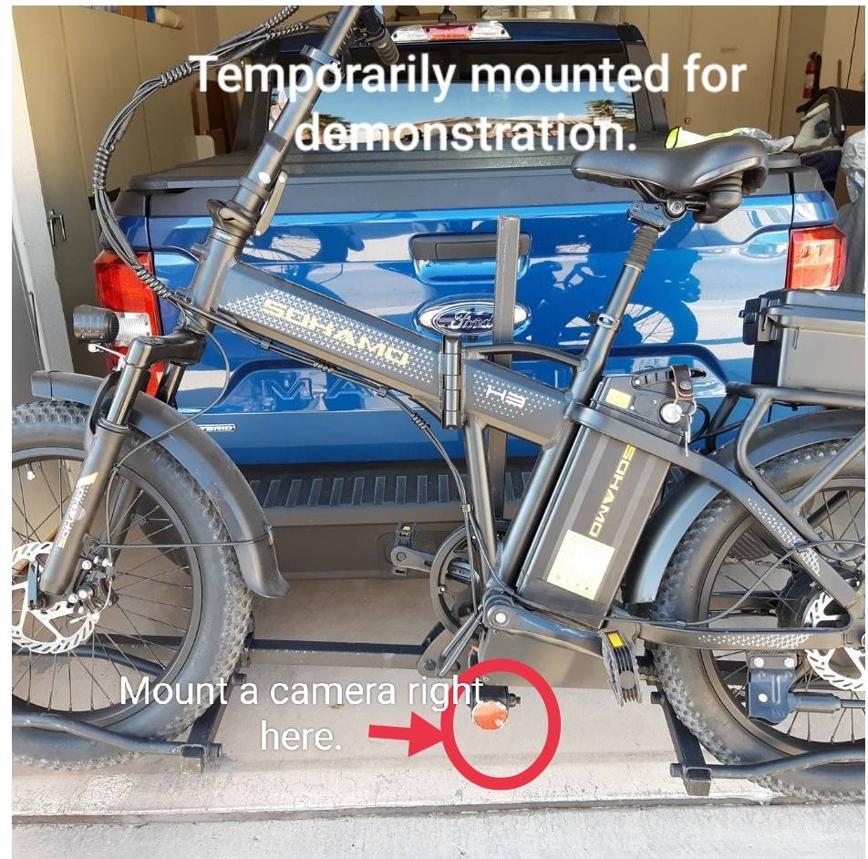

I have my rack on and haul bikes often. It does get pretty annoying not being able to use the camera fully. I also find the blind spot sensor in my mirror going off randomly. It only does it when I have a bike on the rack.
If anyone finds a camera that can integrate with the factory radio I would definitely try it.

On my bike rack a camera mounted right where the reflector would work.

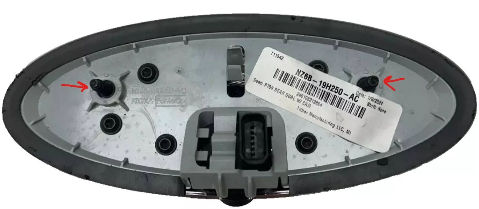

The OEM backup cam isn't easy to mount -- it gets sandwiched between 2 plastic pieces. But the tailgate emblem assembly, which comes with the camera installed, can be surface mounted using two threaded studs.
Ford Maverick Rear View Camera and Bike Racks..... 1744819354833-4l
What if you got a used tailgate emblem (NZ6Z16605A) like this one currently on eBay for ~$60?
Then modify an OEM tailgate harness (NZ6Z14A412C) and extend the camera connector to the length you need. The harness plugs in under the bed, between the bumper and the spare tire. Swap to the modified harness when you haul the bike and swap back when you're done.
It's not the prettiest solution, and I'll concede it's much more work than that innovative SMS mentioned earlier in the thread.
