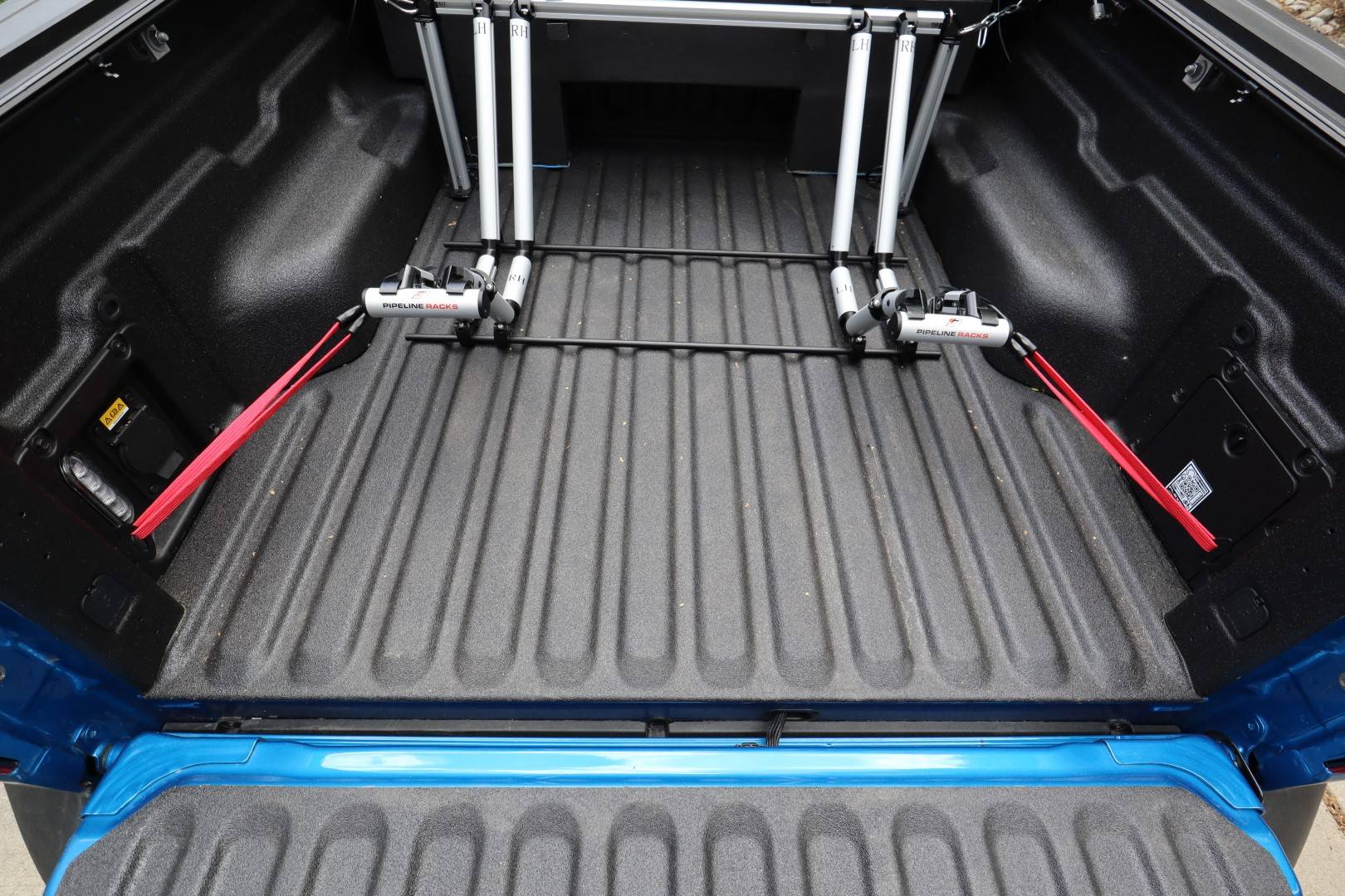

Hey folks, I finally got around to fitting a Pipeline Racks bike rack in the Mav.
Ford Maverick Pipeline Racks bike rack install IMG_20250419_172531535

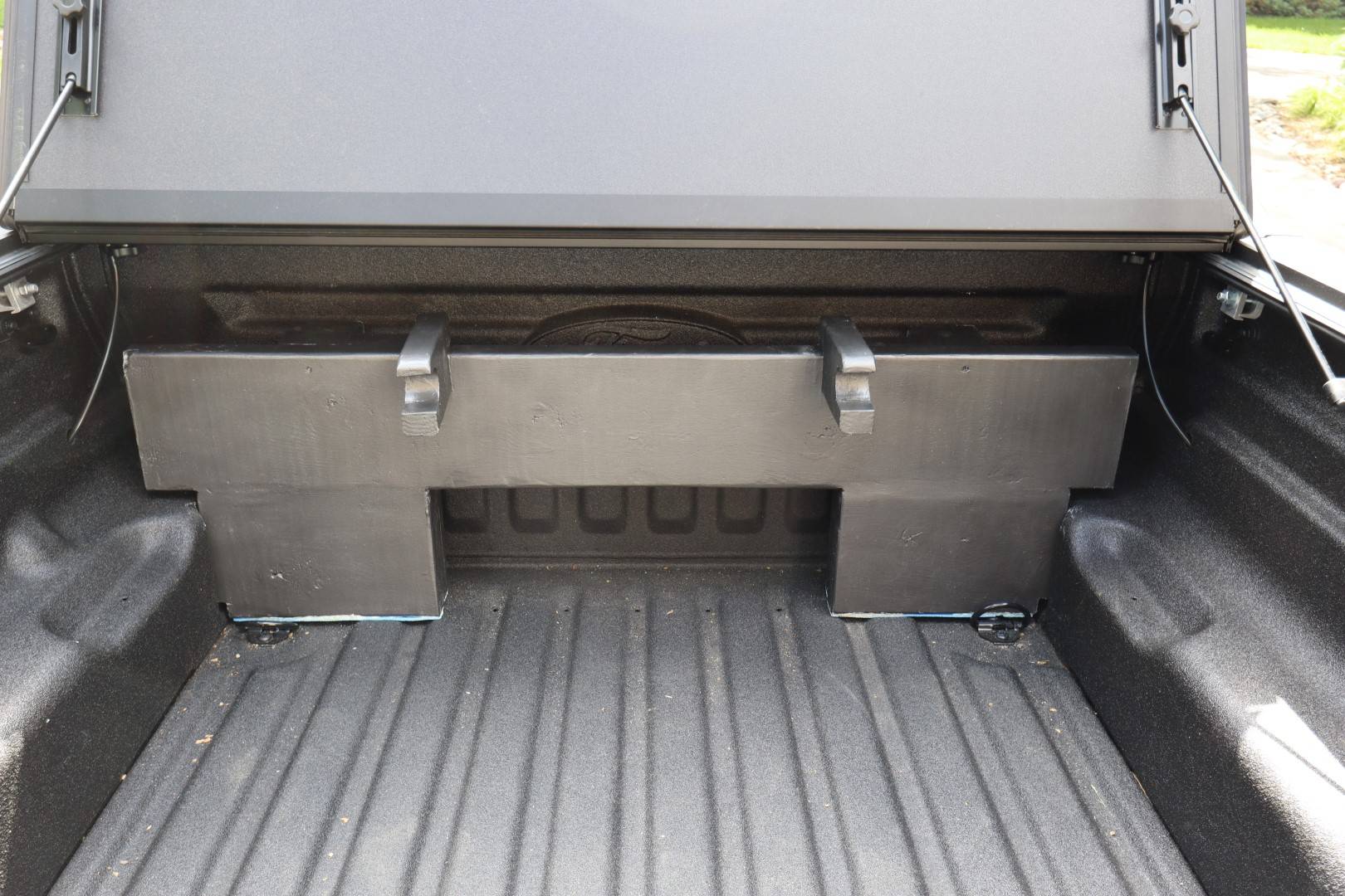

After a bit of assembly and test-fitting I was sure it would work. It's supposed to rest against the front of the bed, but with the tri-fold cover that was impossible.
Ford Maverick Pipeline Racks bike rack install IMG_1375-topaz
Ford Maverick Pipeline Racks bike rack install IMG_1376-topaz

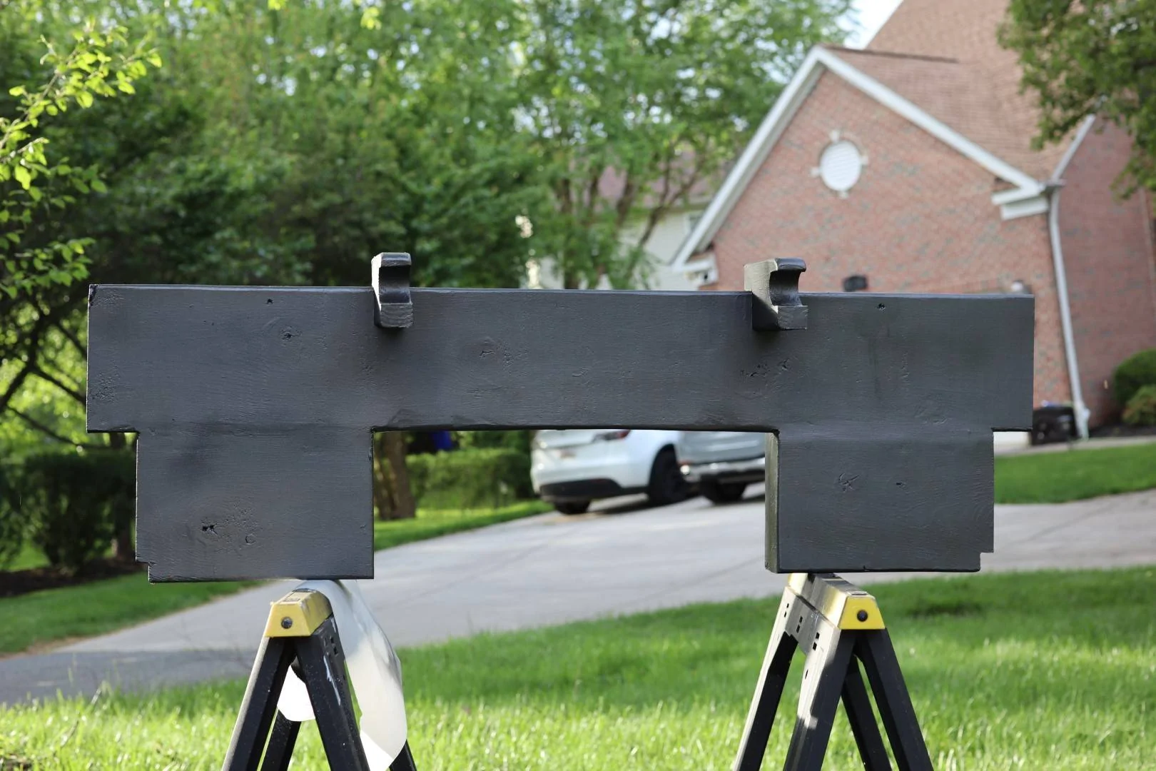

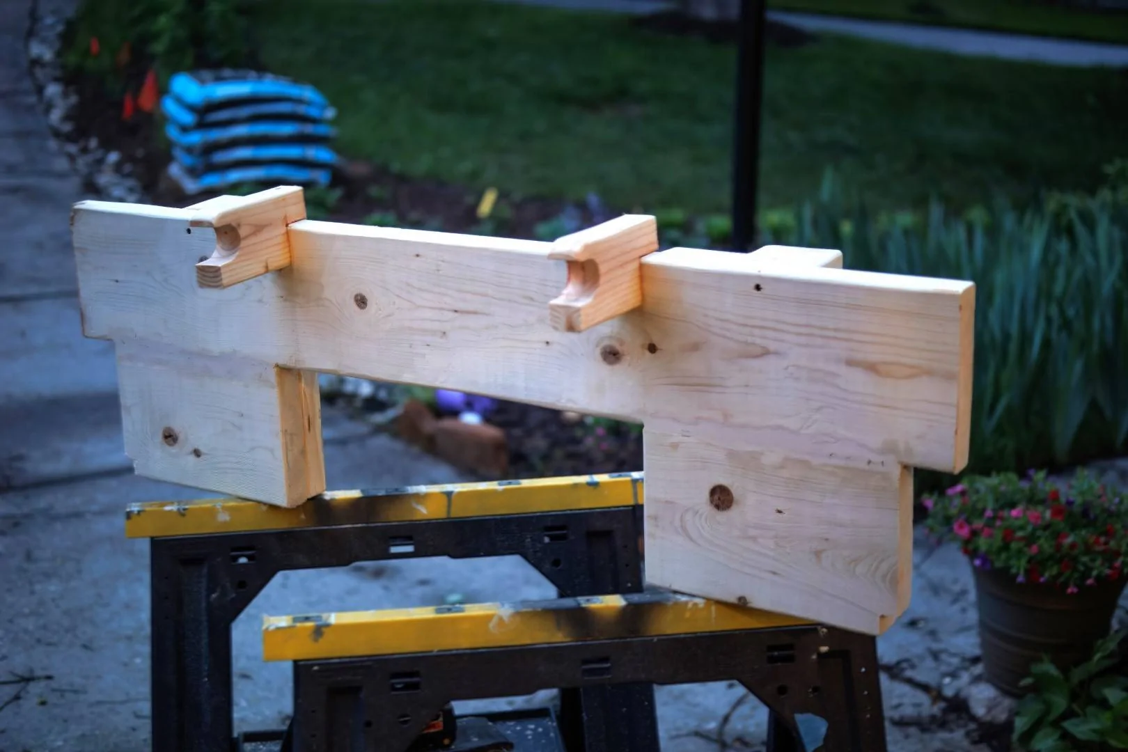

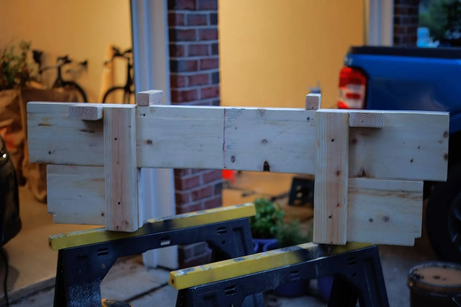

I decided to make a spacer out of 2x6 and 2x4.
Ford Maverick Pipeline Racks bike rack install IMG_1392
I spray painted it with Rustoleum hammered matte black to get it to somewhat match the spray-in bed liner.

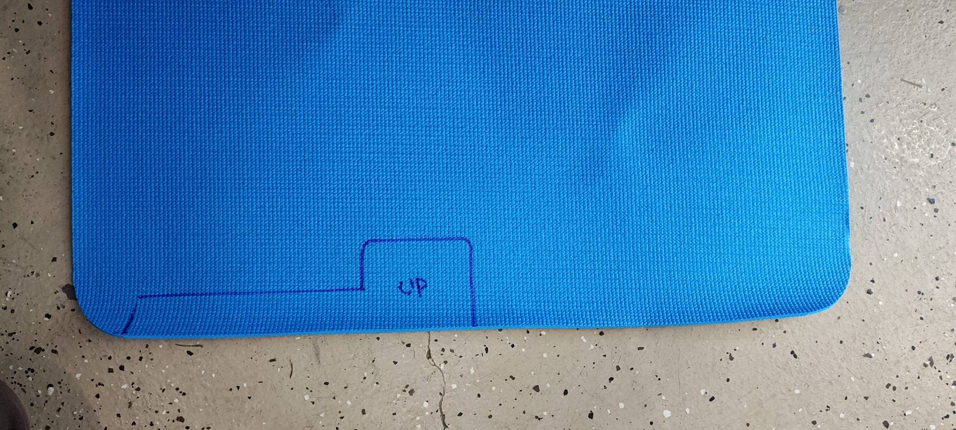

I cut up an old yoga mat to glue to it as a cushion.

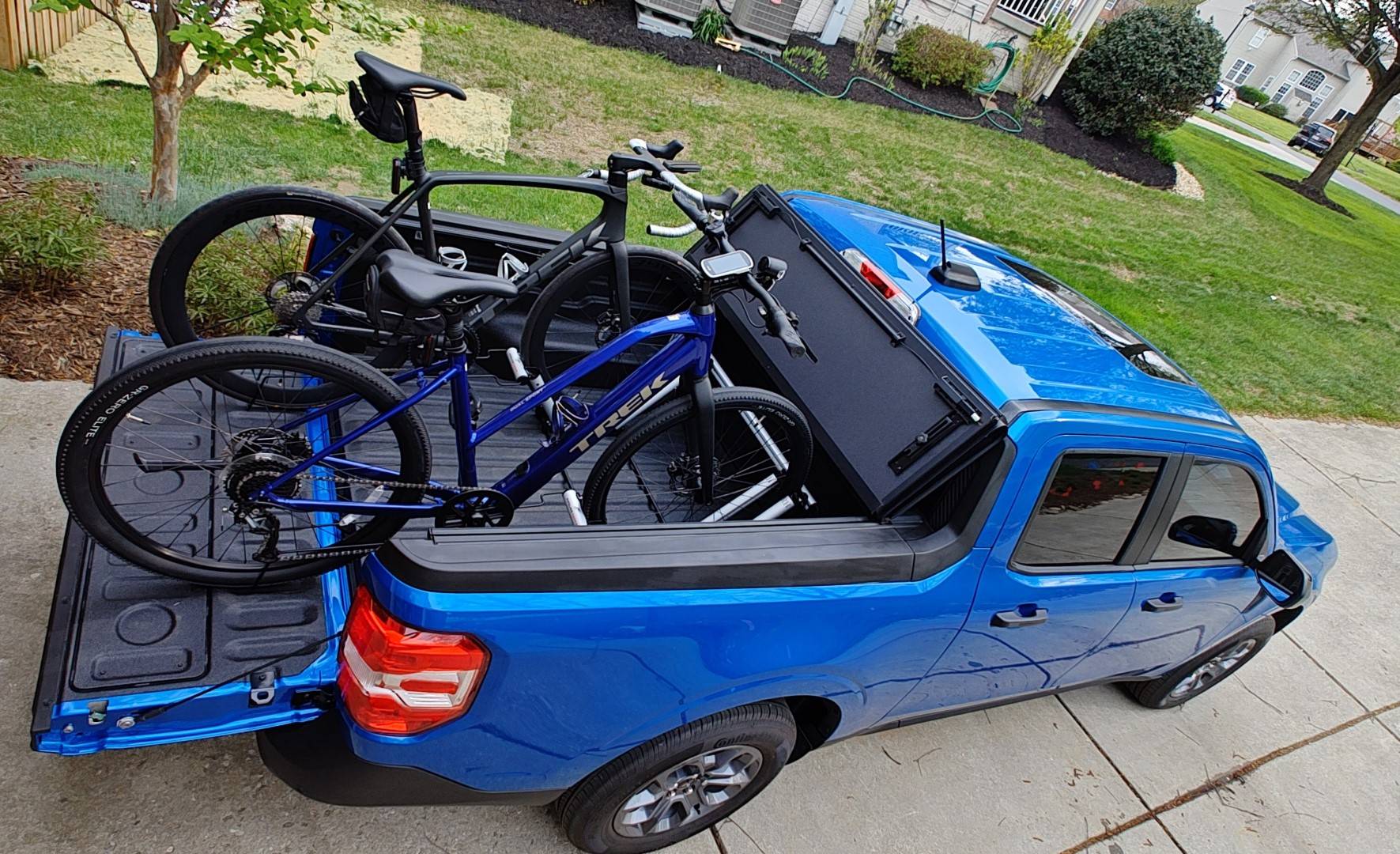

It's set to fit in the front notch.

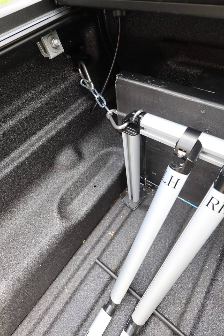

I used a chain to secure it to the upper front cleat and a bungee to secure it to the bed hook.
I used bungees to secure it to the rear bed hook.
Ford Maverick Pipeline Racks bike rack install IMG_1419
The front wheels are secured with Velcro straps.
Ford Maverick Pipeline Racks bike rack install IMG_20250524_145138384
(The stronger ones came in.)
I use another bungee to hold the frame down.

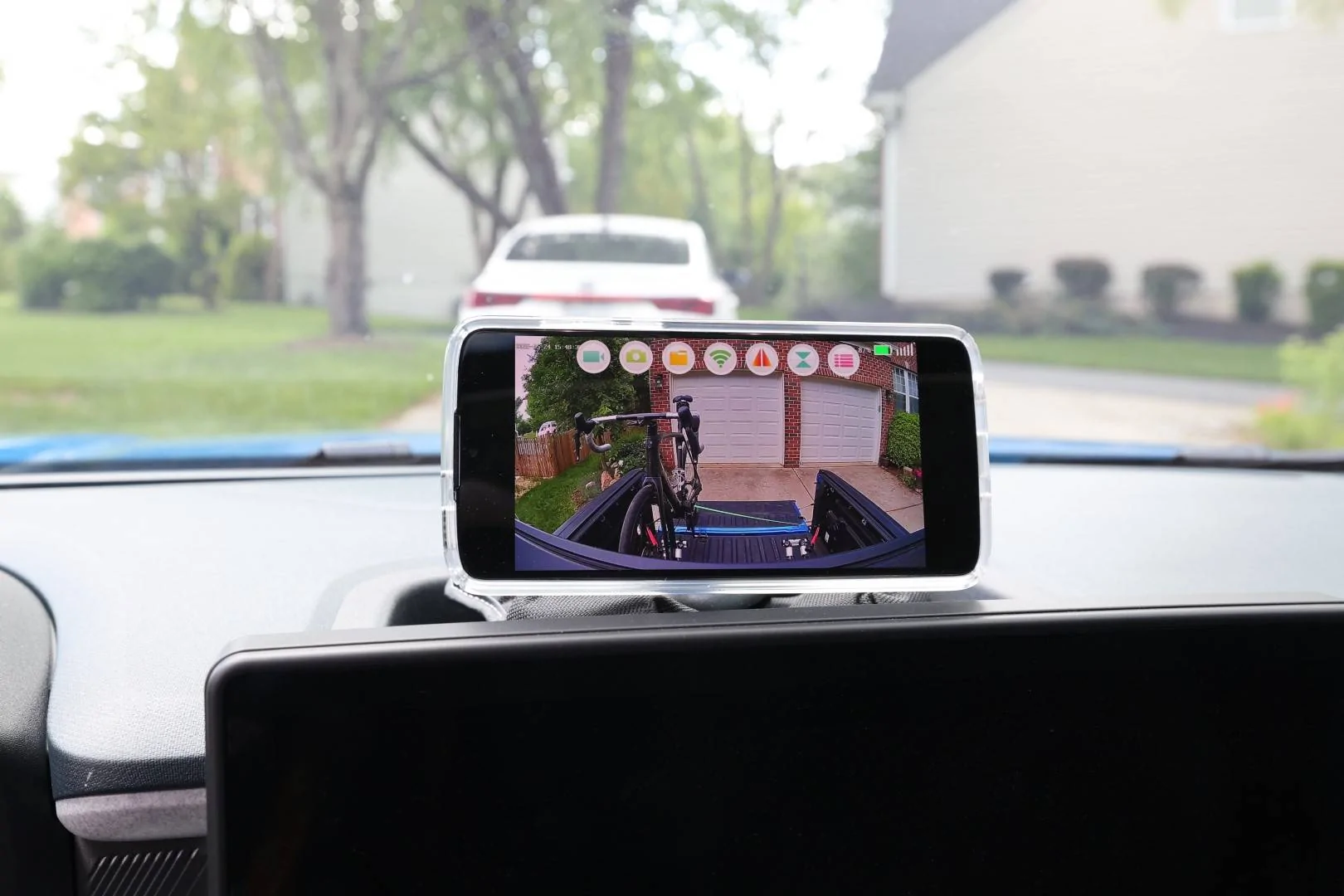

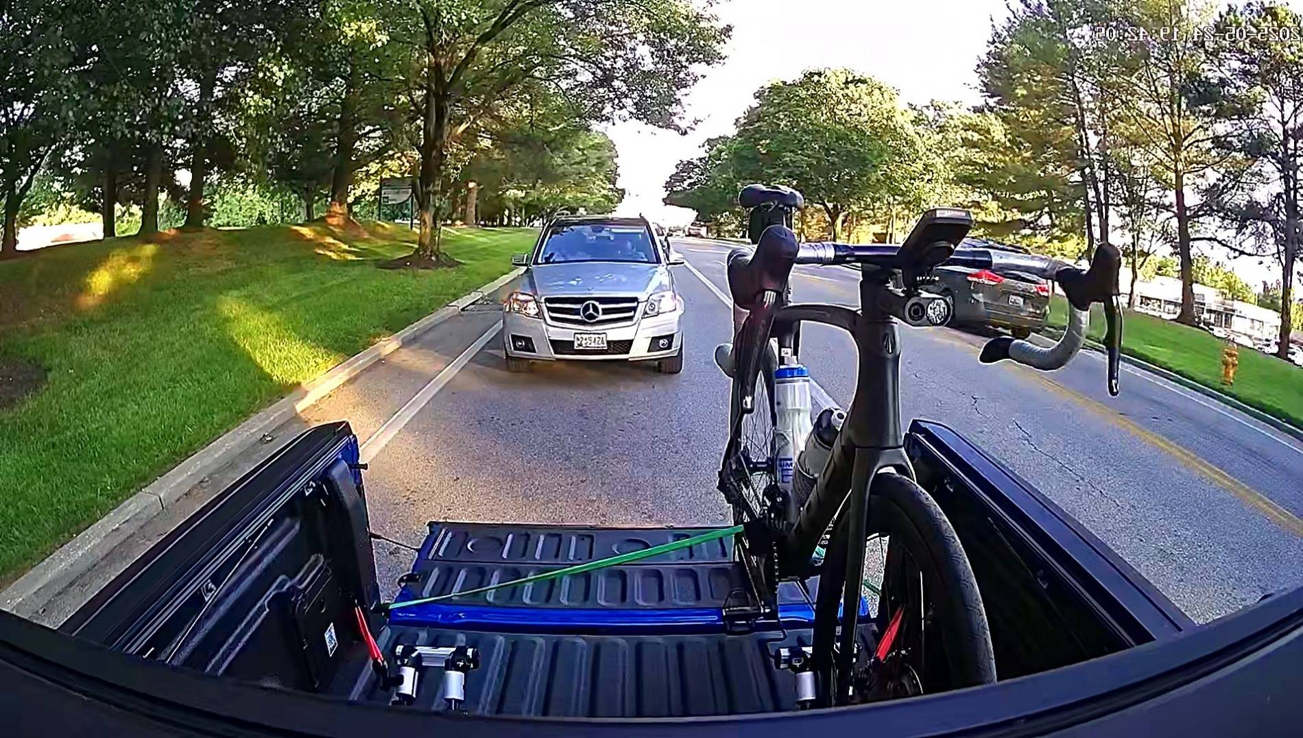

Of course, with the tonneau cover up, I can't see out of the rear window. I was concerned about keeping an eye on my load...
Ford Maverick Pipeline Racks bike rack install IMG_20250502_125605801~2
...So I got a wireless backup camera with a magnetic base.
Ford Maverick Pipeline Racks bike rack install IMG_6491
It connects via Wi-Fi to my old cell phone (that no longer has a SIM card in it.) I found out that when I use my active phone it'll lose connection to the backup camera as soon as the phone connects to the Maverick.
Ford Maverick Pipeline Racks bike rack install 20250524-194205-42
The resolution is pretty good.

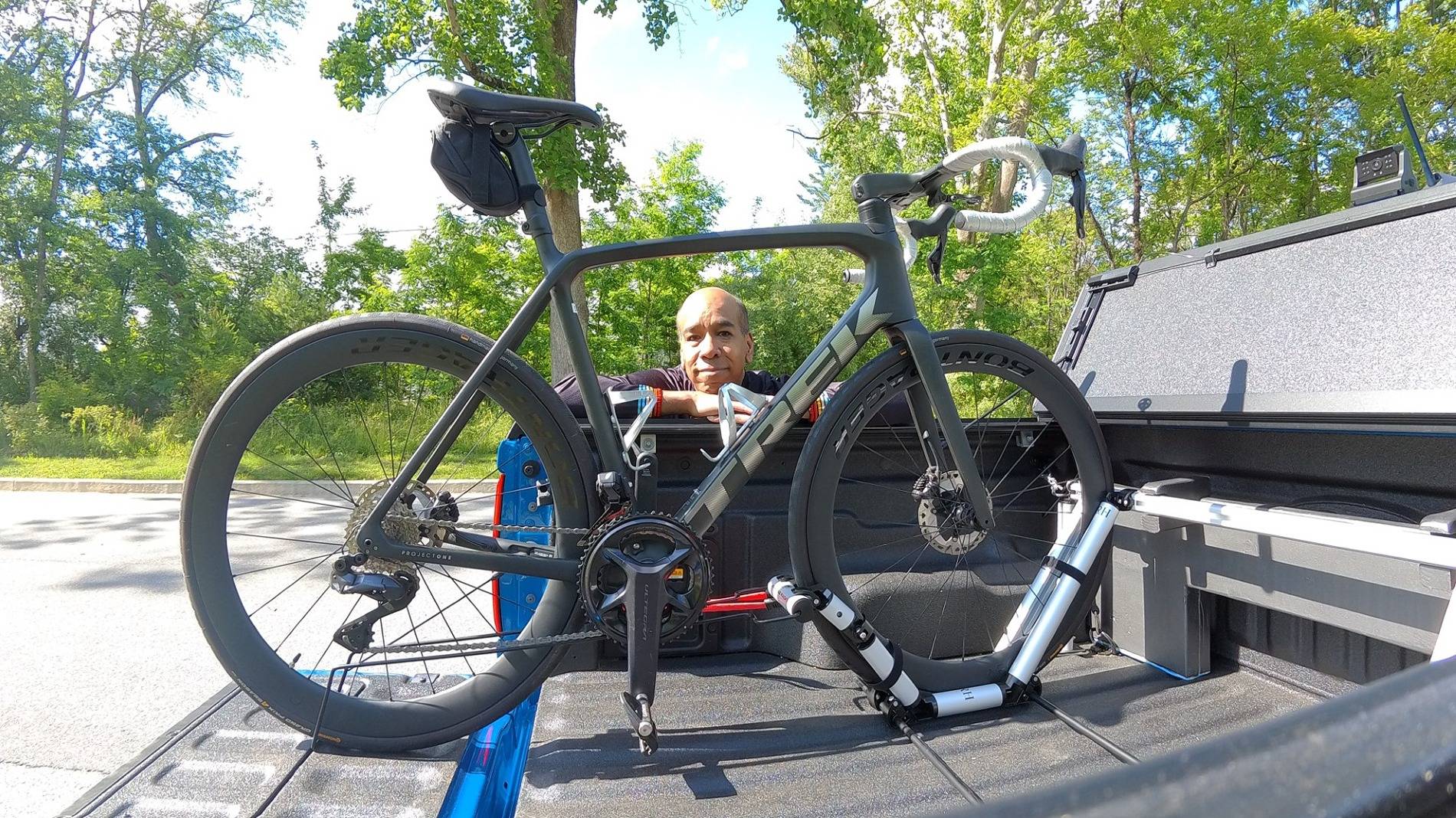

So off to the bike path I go.
I have a couple of trailer hitch mount carriers as well. I prefer this method. The exception will be when my wife and I are taking the bikes on vacation and will need the bed for luggage.
