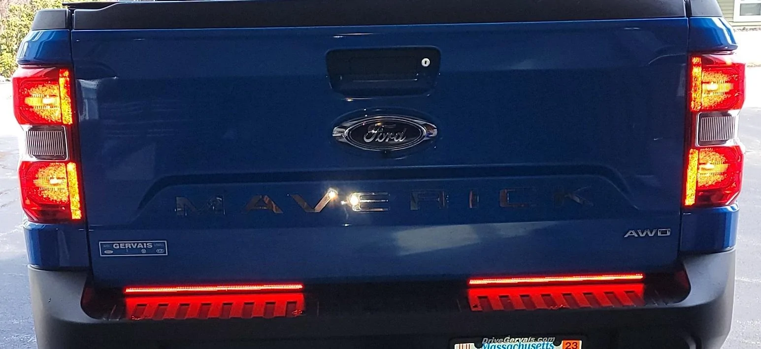

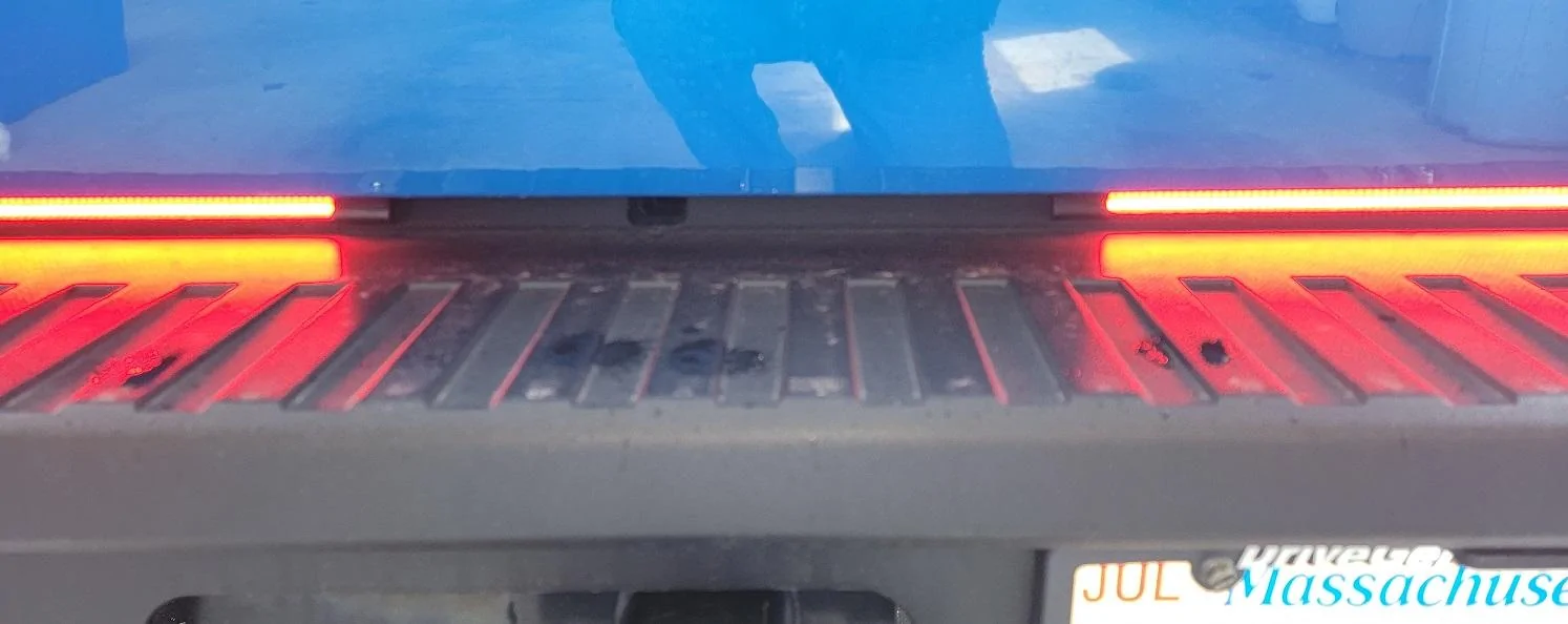

On the MY22's (and presumably, the MY23's), there is a vertical lip on the bumper just below the tailgate. We mounted mine there, which got it low enough to be seen properly and, on a regular light bar, would avoid any conflict with the spare tire access. Since mine is a split Putco blade, someone would have to measure that lip to ensure it would take a 48" single bar.

The first picture is a close-up of the bumper flange with the split bar mounted. Anything higher will not be directly visible (even standing 20-30 feet away), which reduces the usefulness of the bar. A full bar would cover the spare tire access, which I had thought was higher up until I took this picture.
The second picture shows the full bar. Each section in this case is 18", so you still get 36" of extra and very bright lighting.
Mine is installed with a Curt T-harness that is Maverick specific and saves having to splice into the factory taillight harness.

I just got out of H&H after 3 hours of them installing a Putco blade. It worked fine, but whenever I attempted to use the remote start, the left tail light didn't turn on. They hard-wired the blade directly to the lights wiring. Had to take it off because the left tail light would not turn on during remote start. Do you think adding this harness would've fixed the problem?
I believe the Curt harness would have prevented that problem. I also think they wired something wrong and need to correct it.
