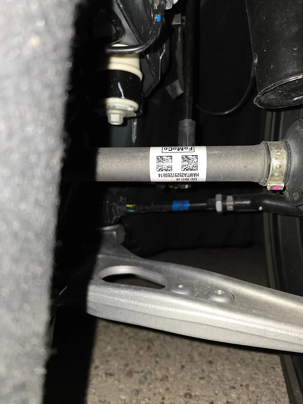

I have my hybrid AWD lowered with Goodwin coils. Here are pics of my axles on level ground, but the camera may not have been held level and taken at night. -2" in front and -2.6" in the rear.
Rear, they are headed upward toward the wheel but are at less of an angle than any of my other vehicle's independant axles.
Ford Maverick Rear axle problems from lift kit (or lowering)? 20260210_214121

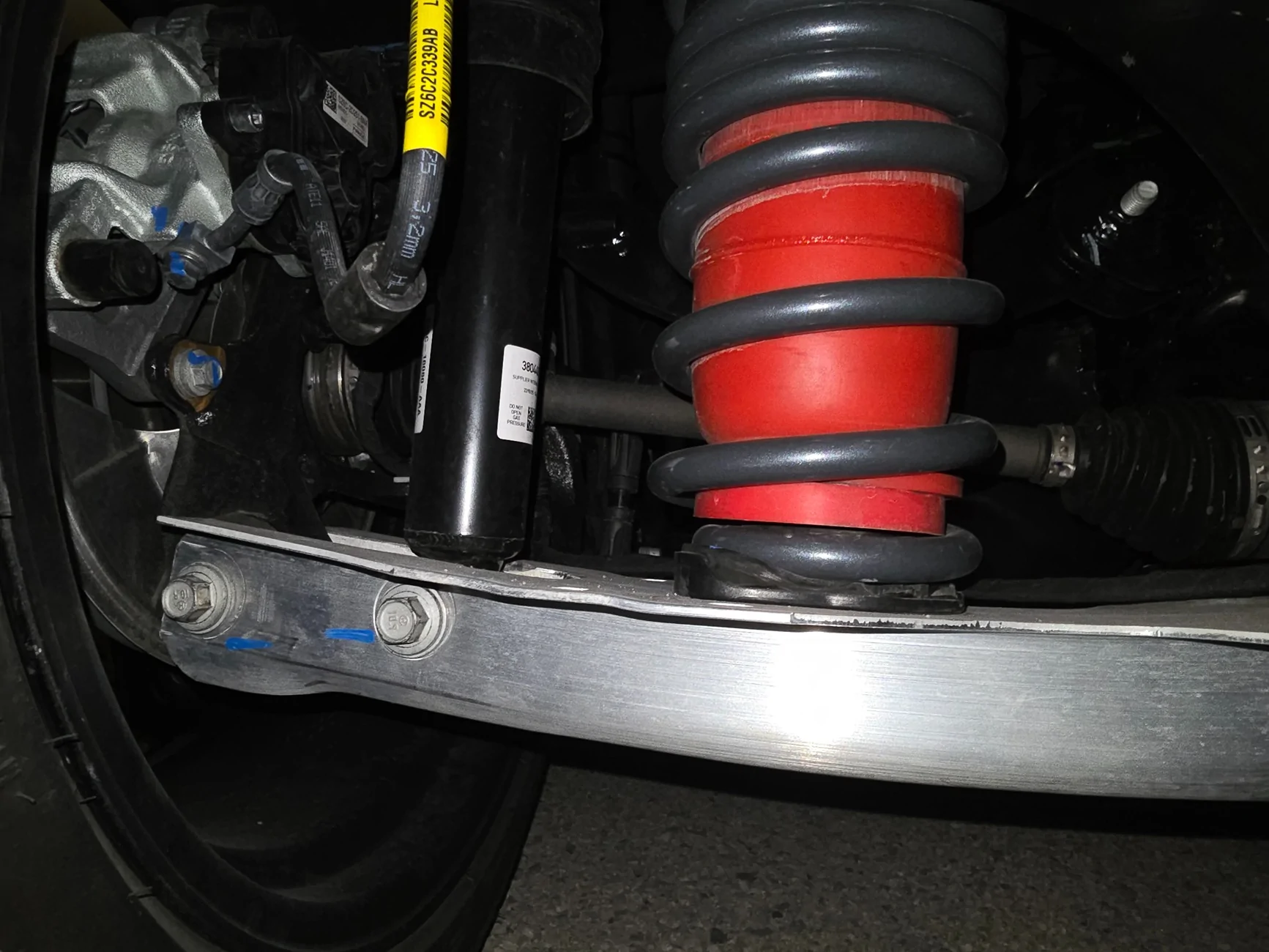

Front, pretty darn flat I'd say.
Ford Maverick Rear axle problems from lift kit (or lowering)? 20260210_214229

Great info. I guess the aibags are to retain cargo capacity with the dropped suspension? Good idea, I'd likely do the same so the rear doesn't bottom out from towing 4k ... either that or Timbrens (would they work with a drop?) ... Thanks

Yes, the air springs are for keeping the rear up while loaded. I prefer air as you can adjust the pressure, with timbrens you have one set rate and cost three times as much. What you have to watch out for is the timbrens and air bags are sized for stock ride height. The air lift air springs come in different heights.

Which size springs did you get? I’m about to lower my AWD with Goodwin’s.
